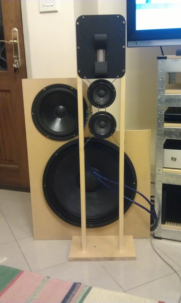

They might not be pretty, but they sound great (only one currently built, still prototyping).

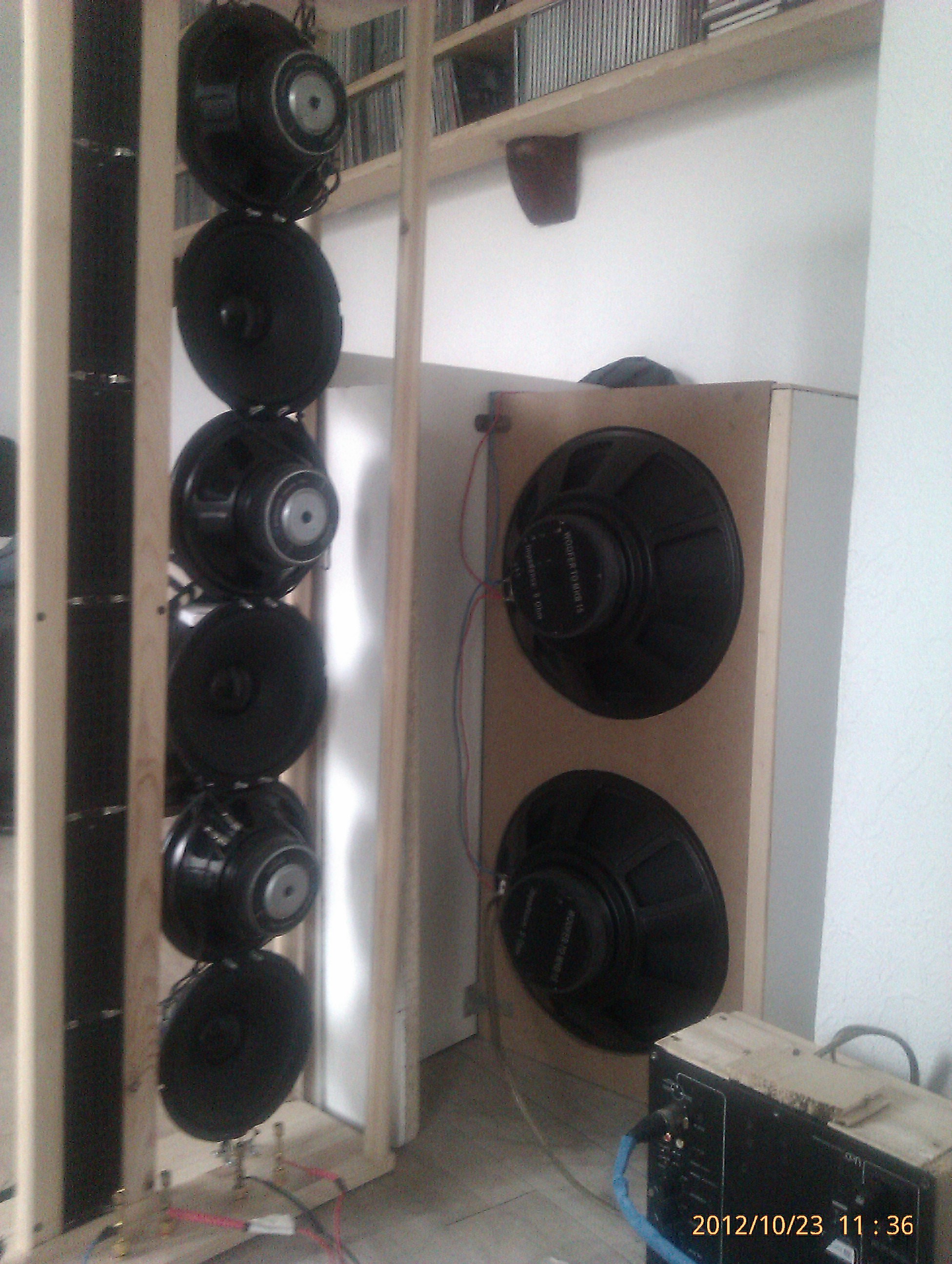

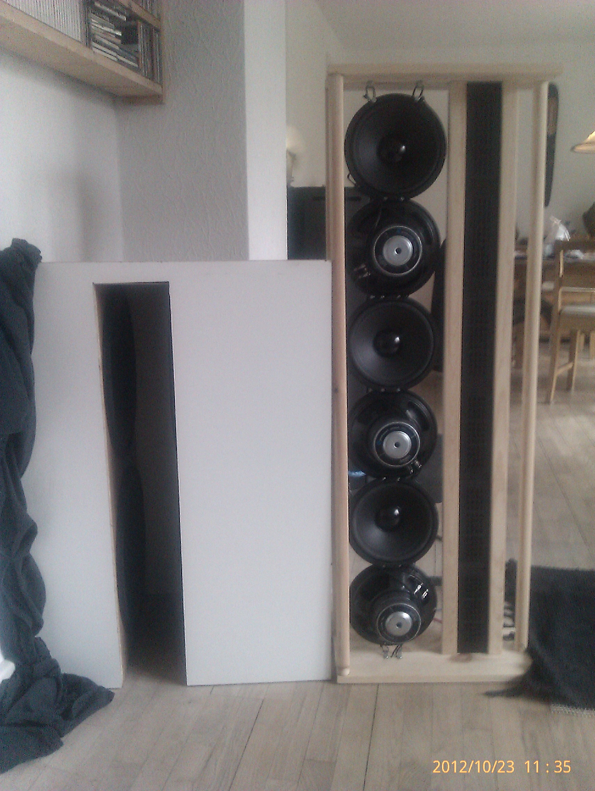

Here is my new OB project, inspired by StigErik.
Slot Loaded OB with 4x 15" sub from 20-400 hz, 6x 8" Goldwood from 400-1000 hz and 6x NEO8s from 1000 and up. X-over 48 db. Fun project that actully works pretty well, if you aply some digi EQ.
Regards Sebastian
