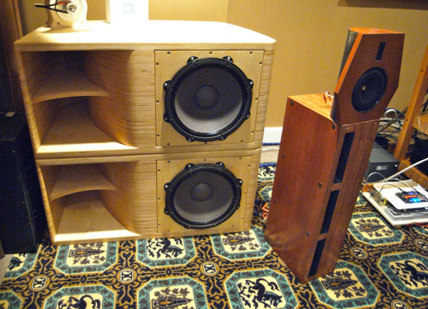

Quote:
The Surreal Sound Speaker ($10,000/pair) is the small, three-way floorstander finished in cherry, not the massive bass bin behind it, which belongs to the GOTO Horns speaker (see next story). Surreal Sound's Ralph Helmer is passionate about midrange, feeling it is in the midrange where the music truly lives. To that end, his speaker features a beryllium-disc midrange unit, mounted in an open baffle. A Heil Air Motion Transfomer supertweeter and three spider-less, aluminum-alloy, 10" cone drivers for the bass, all also mounted in open baffles, complete the drive-unit line-up.

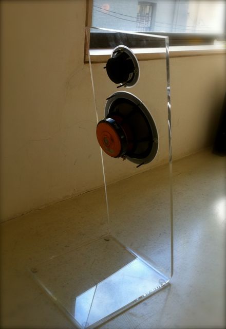

My new bedroom OBs
I've just finished my new bedroom speakers.
They couldn't be simpler as the integrated baffle and stand is just a piece of folded perspex.
I'm using a spare Seas W22 and 27TDFC, and an equally spare MiniDSP. SInce they basically the top half of my mains, the xover and EQ is very similar.
I know I should brace them (and eventually will) , but I like the minimalist aesthetic and they sound really good.
