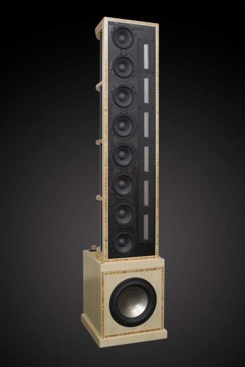

Greg,
Bamboo plywood?
dave
Correct! One layer on front with a layer of mdf, then more bamboo and a back piece of good quality ply. 3" thick total. Super rigid to say the least. Masked off the front and sprayed the sides and back with Rustoleum textured. Not the typical stuff with big glops, but a newer kind with very small flecks of tan and red. Looks spectacular in person with the bamboo.
Greg

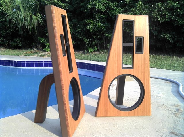

A project I did in 2009:
The raw front...
... and back.
The rear support stands
Laquered fronts...
... and back sides
The finished speaker
Final version
I hope I did not post too many photos.

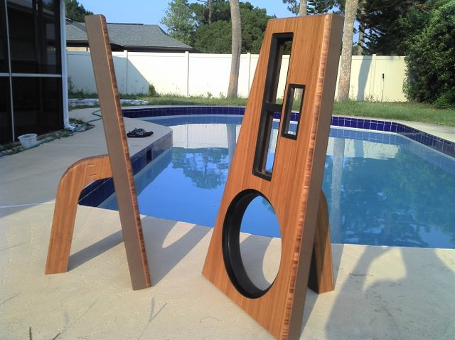

Hi Superlian, I fixed the rear supports with wooden dowels; one on the top and two each in the middle.
In the meantime, I had to exchange the upper dowels I used first by bigger ones as this construction proved not to be stable enough. If I had to do it all new, I would care for a more solid connection. But it seems to be ok now.

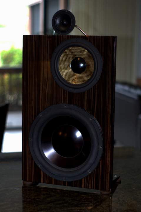

Just finished this 3 way build, all dipole. Scan 10F suprisingly good up top, crossed to Usher mid woofer at 1.8k, 12dB/oct passive. Bottom end supplied by Dayton RSS 12", supplies 120Hz down, active. Swing style bushing mount adjusts for offset, diffraction and isolation. Very well balanced presentation, in a 15" x 23" package.

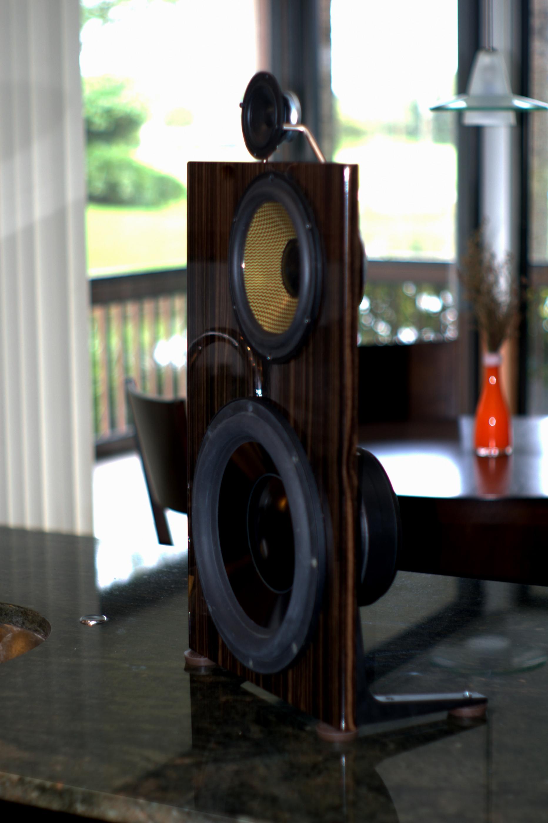

Very nice built, congratulation, beautiful finish.Would you have some more pictures for us (i.e. rear)? I would like to hear a bit more about your listening experiences, if not too early at this stage...
Regards
Till
Thanks for the comment. Here's a quick picture from the side and rear. I will have the mate assembled sometime this week so I will be able to do some testing and be able to comment on their imaging, etc. First impressions are very positive and the swing mount has some promise. My swing mount design may offer the following advantages: (1) adjustable offset (2) isolates high frequency driver from baffle (3) better aligns acoustic center w/other drivers (4) no obstruction for rear radiation (5) easily swap other HF drivers for testing/evaluation. The mount consists of two slim cabinet door handles, rubber bushings, and 8-32 cap screws.
