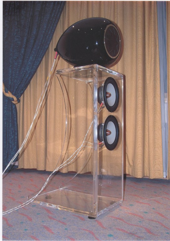

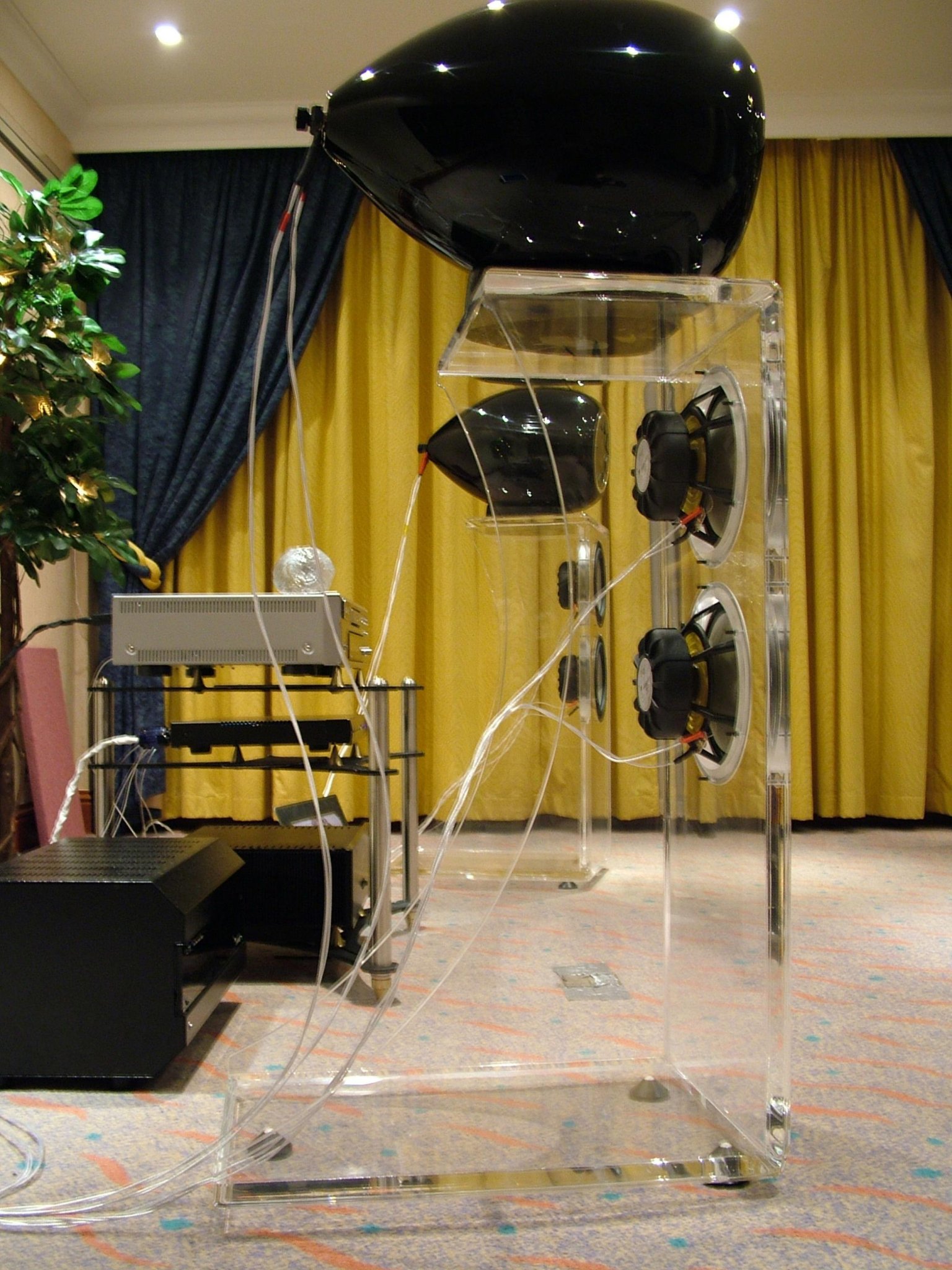

These Overlill Audio "Angels" sounded awesome at a Bristol Audio show about 20 years ago, 2005 I think?
The Acrylic was so clean its hard to see the curved edge on the sides.
The variable curve is a great way to give a "Variable Path Length" (VPL!) which eliminates any cliff edge for back wave cancellation
It also reduces cavity resonance in between the two sides.
The twin SEAS 8 inch drivers covered Fs (28Hz) to 300 Hz and then a stunning Manger driver all the way up to bout 18KHz.
A solid state, Dave Belles Ref power amp on the Seas and a gorgeous sounding (but pot ugly to look at!) Tom Evans class A tube amp on the Manger... Overall one of the most life like and natural systems I've heard... Vocals in particular were just so real... Just as I was about the hit play and it felt like Seal "spoke to me" I actually looked up in embarrassment that I had ignored him!!

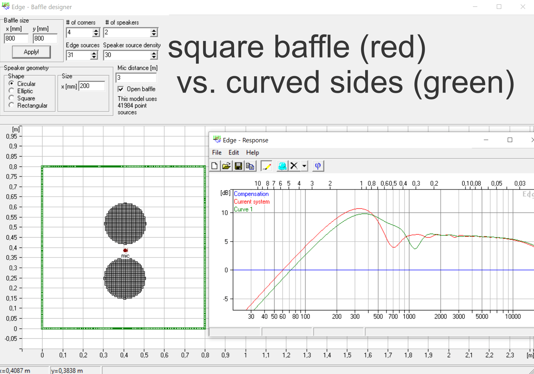

First statement is false, but it helps a bit yes. Edge simulation can use only flat baffle, but it translates pretty well for U-baffles. I used 14 edge points for curved baffle (not shown). Actually curving is meaningless below 300Hz, but obviously gives better economic proffit...

I had made times ago VPL U-frame simulations in AKABAK (lot of them) to find some U-frame shape what reduce first dipole peak and first minimum, result was that any shape reduce peaks and minimums nearly zero dB. Shortest path length defines peaks and minimums frequencies and variability has nearly no influence.

curved edge or straight, you are still going to get a cavity resonance in the Uframe; the only thing that really helps is crossing over to the top below that resonance. in this case, the top driver looks big enough for that to have been done
Again I am happy to disagree with you juhazi.Actually curving is meaningless below 300Hz, but obviously gives better economic proffit...
Fact: It actually increases the production cost! But the significant performance advantages are well worth the extra cost. Also it looks stunning... Compare it to the usual slab sided boxes with no back that most people churn out..
It requires a lot more material and 20mm thick acrylic is expensive, delicate and easily damaged... One scratch renders a piece unusable in commercial production. One has to buy enough material to allow for 60cm deep sides as that was the depth of the cabinet sides at the base... Then the "extra" material has to be CND away to create the variable curve which creates 60cm deep sides at the base, then gradually reduces to a carefully calculated minimum depth, then increases again up to the top plate.
The result is a substantial increase in bass extension with ZERO tunnel effect or any trace of lower midrange colouration... The cabinets were incredibly heavy for such a small design and even at high SPL when I put my hand on the sides (much to the anger of the Overkill Audio guys... I left a finger print!) there was zero vibration.
So the design is very effective but costs more to manufacture.
Re your technical opinion... Here are the facts Vs your "false statements":
In a conventional open baffle the sides usually vary from none at all (flat baffle only) to relatively shallow compared to the baffle width, this is to avoid rear chamber "tunnel effect" (standing waves/resonance between the two sides) which sounds really bad and is unacceptable to even a casual listener. 15 cm to 20 cm deep sides are common, some up to 30 cm deep. So this (a) limits effective baffle width to just the width of the flat baffle, or this dimension plus the total depth of the two sides... Again, imagine the sides folded flat and you have a rectangle.... ie you have a "cliff edge" baffle step plus a cliff edge F3 where bass plummets below the frequency corresponding to the wavelength of the effective baffle width.
So the result of the VPL design is almost a doubling of effective baffle width whilst maintaining a high WAF narrow front baffle width with no downside other than extra cost.
