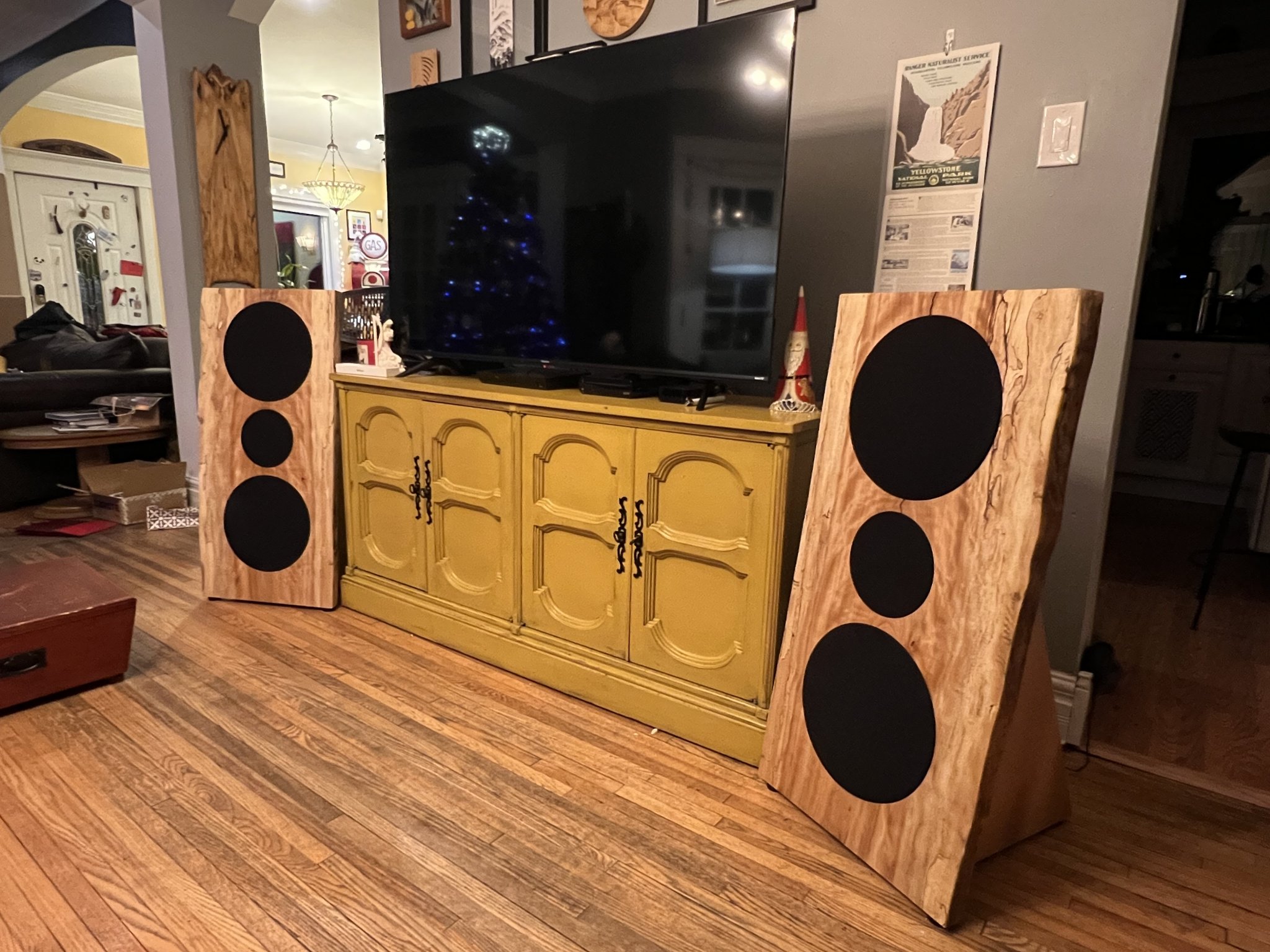

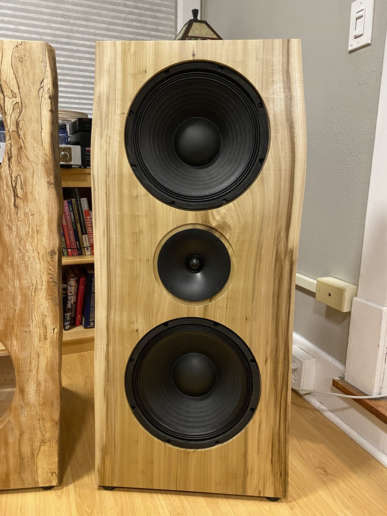

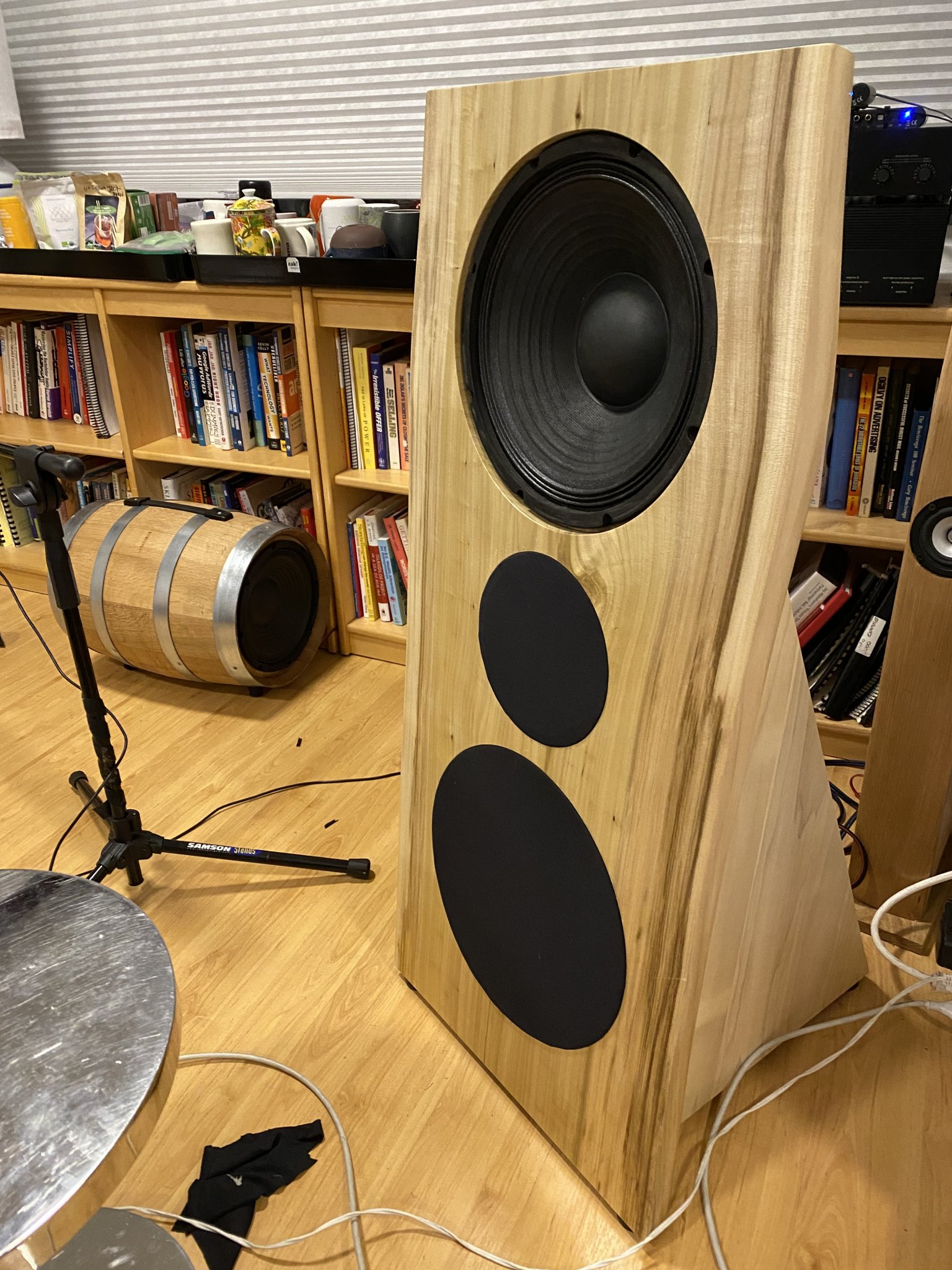

A Heretical Reflex+Open Baffle Hybrid
Constant Directivity, 96dB SPL, 300 Watts, 35Hz-20KHz
Crafted from Live Edge Wood​

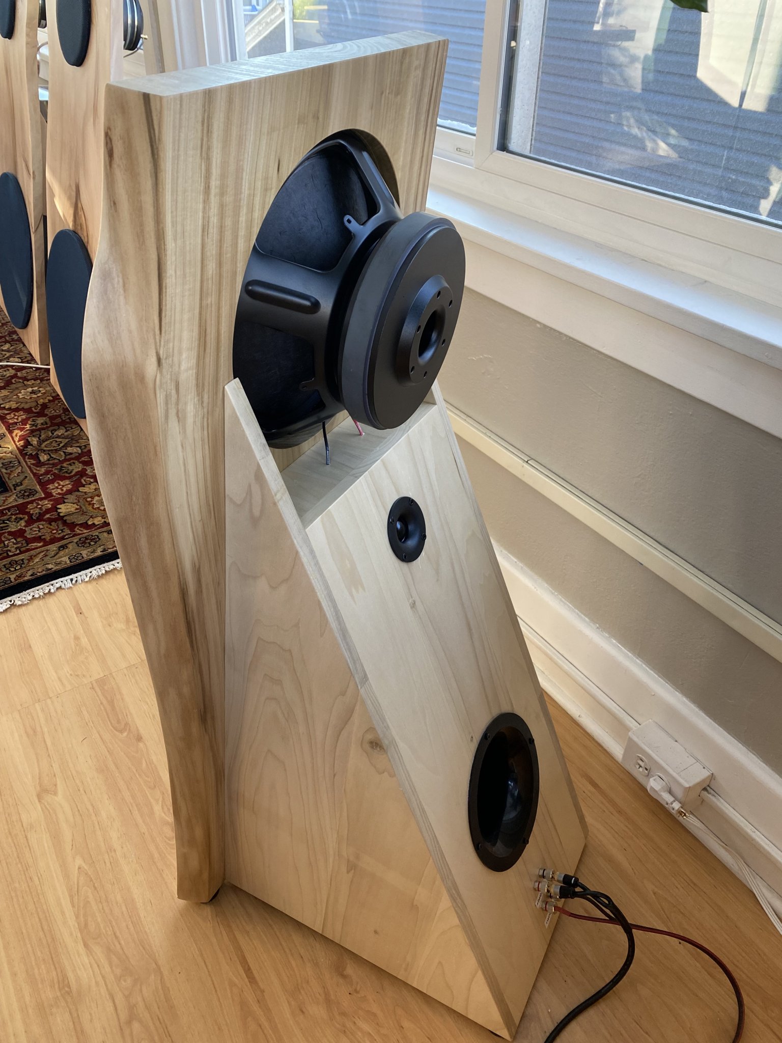

This design is Bass Reflex below 100Hz and Open Baffle above 100Hz, using one 12” woofer as a Point Source bass and the other as a Dipole Midrange. It combines the stage, imaging and open sound of Open Baffle with the bass and power output of a reflex.
Is this heresy? To a Dipole purist, undoubtedly so. But it delivers a huge un-boxy stereo image with the bass punch of a traditional ported design.

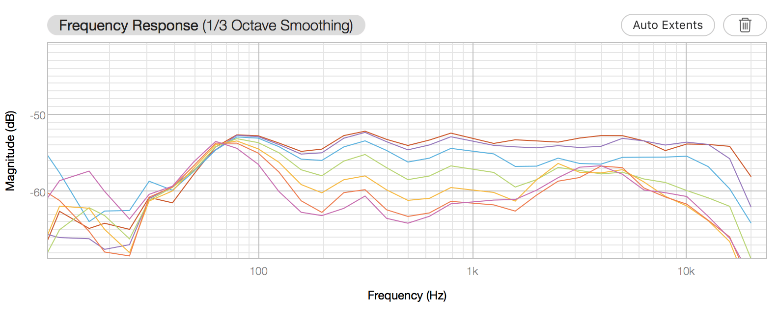

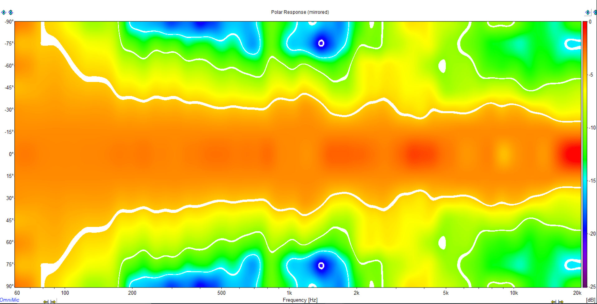

I’m proud of the polar response spectrum, it exhibits excellent Constant Directivity from 150Hz to 20KHz; it has -6dB points at about 45 degrees off axis, very consistently from 200Hz on up. Notice that even at 20KHz the pattern doesn't narrow much; this is because of the waveguide:

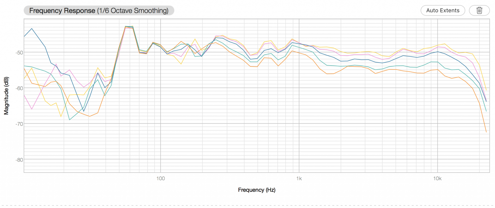

Frequency response at 0, 15, 30, 45, 60, 75 and 90 degrees off axis:
1/6 octave curve at 0 15 30 45 60 75 degrees:
flanagangster+1:6 oct0 15 30 45 60.png

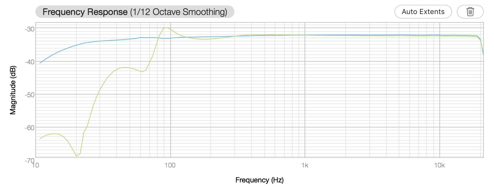

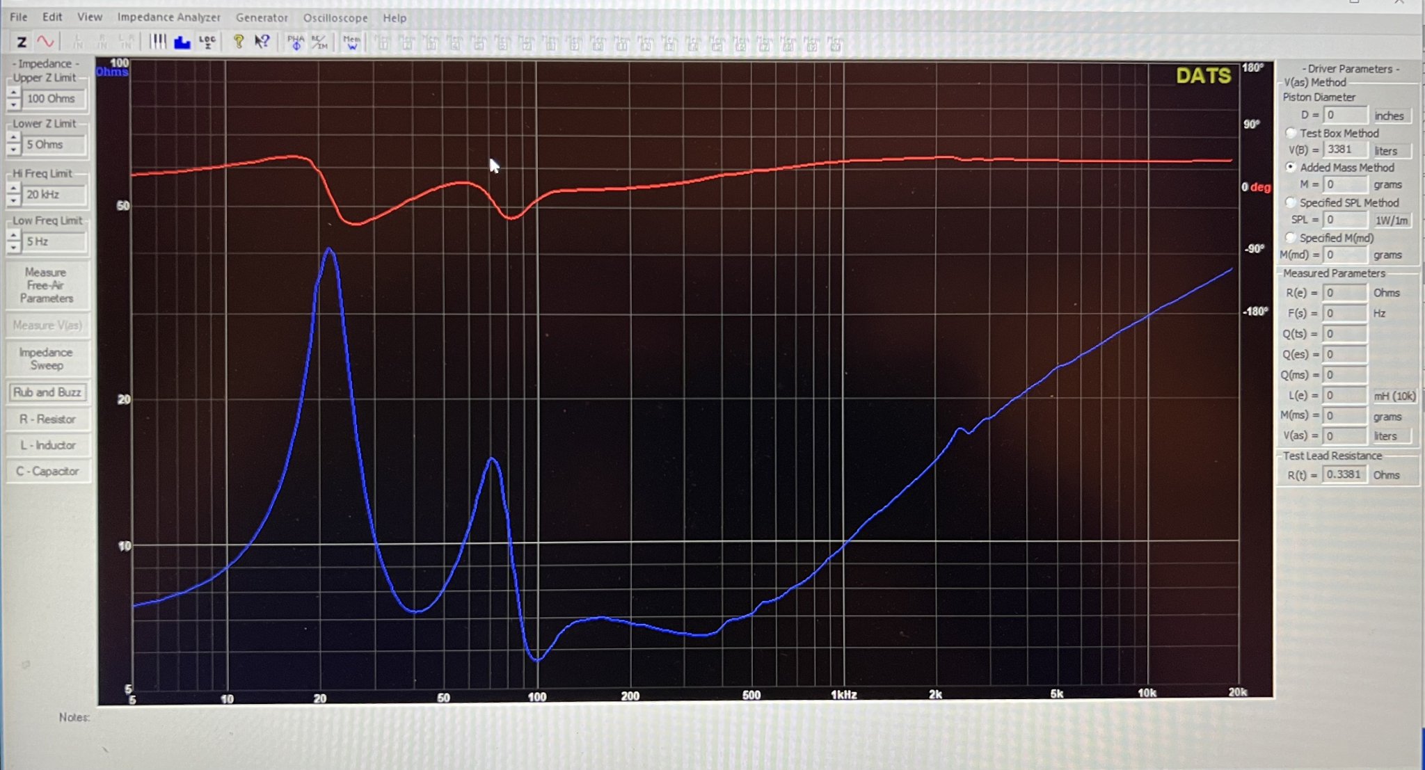

The above measurement doesn’t capture the bass output of the port. Here is the measured response of the port + lower woofer.

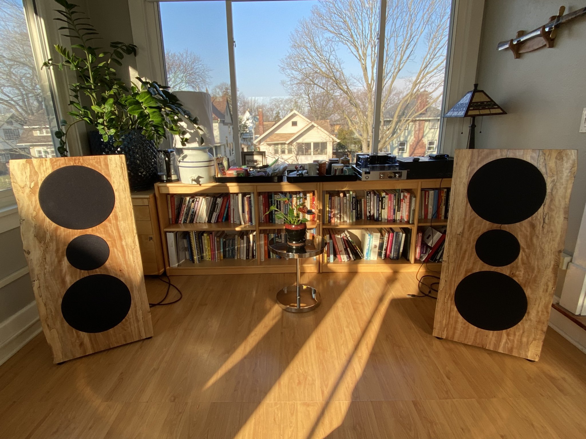

I made these for my friend Jeremy Flanagan who loved the Bitches Brew Live Edge Dipoles but needed something much smaller and more economical. These deliver 80% of the performance for 20% of the cost. I wanted these to have the luxurious room-filling sound of Open Baffles but be capable of functioning as “party speakers” when called upon to do so.
The woofers are Dayton PA310s with 96dB SPL sensitivity and 3-inch voice coils. The lower woofer operates from 35Hz to 100Hz in a 40-liter reflex tuned to 42Hz. The upper woofer operates as a midrange from 100Hz to 2KHz in open baffle configuration.
Front tweeter: Audax TW034X0 34mm classic soft domes matched to Troels Graveson waveguides. (http://www.troelsgravesen.dk)
Rear tweeter: Peerless by Tymphany BC25SC08-04 1" Silk Dome Neodymium Tweeter

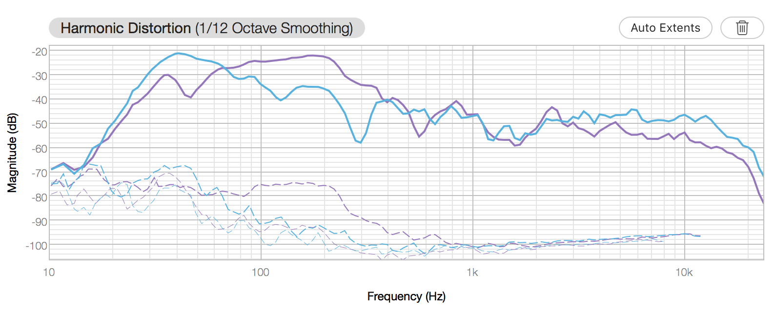

Some readers will be puzzled as to my unorthodox choice of using two identical 12” woofers, one as a midrange and the other for bass. I chose the Dayton PA310 for its high sensitivity and for its suitability for a DSP assisted reflex alignment in a small box, and because of its ultra-smooth midrange requiring very little help from the crossover.
The woofer has 5mm Xmax. This would fall far short of what’s necessary in an Open Baffle, but 5mm is plenty in a reflex, especially since the DSP filters out frequencies below 35Hz using a high-Q shelf filter. There is surprisingly little excursion at high volumes, and plus it doubles as an excellent midrange. And even with the small baffle size, the 12” dipole midrange effectively operates down to 100Hz.

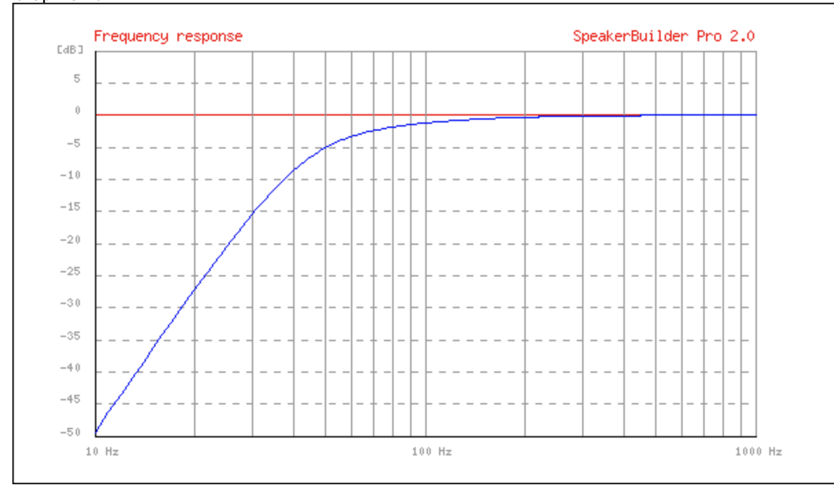

This is the simulated reflex alignment of the woofer:

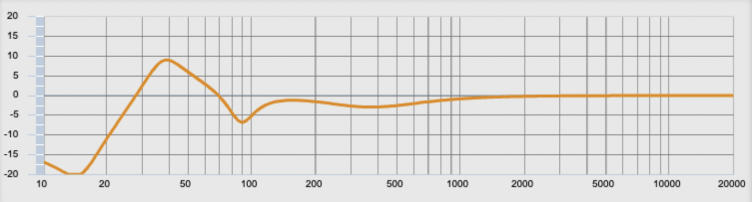

Below is the MiniDSP EQ correction curve for the woofer – notice the 9dB of bass boost at 40Hz which complements the above curve and renders the system flat to 35Hz:

NOTE: I used Precision Port 4” ports (large diameter ports are absolutely essential to prevent power compression). since there’s so little room on the inside of the smallish box, I had to cut the inside port flare with a jigsaw to leave enough space to install the bottom woofer.

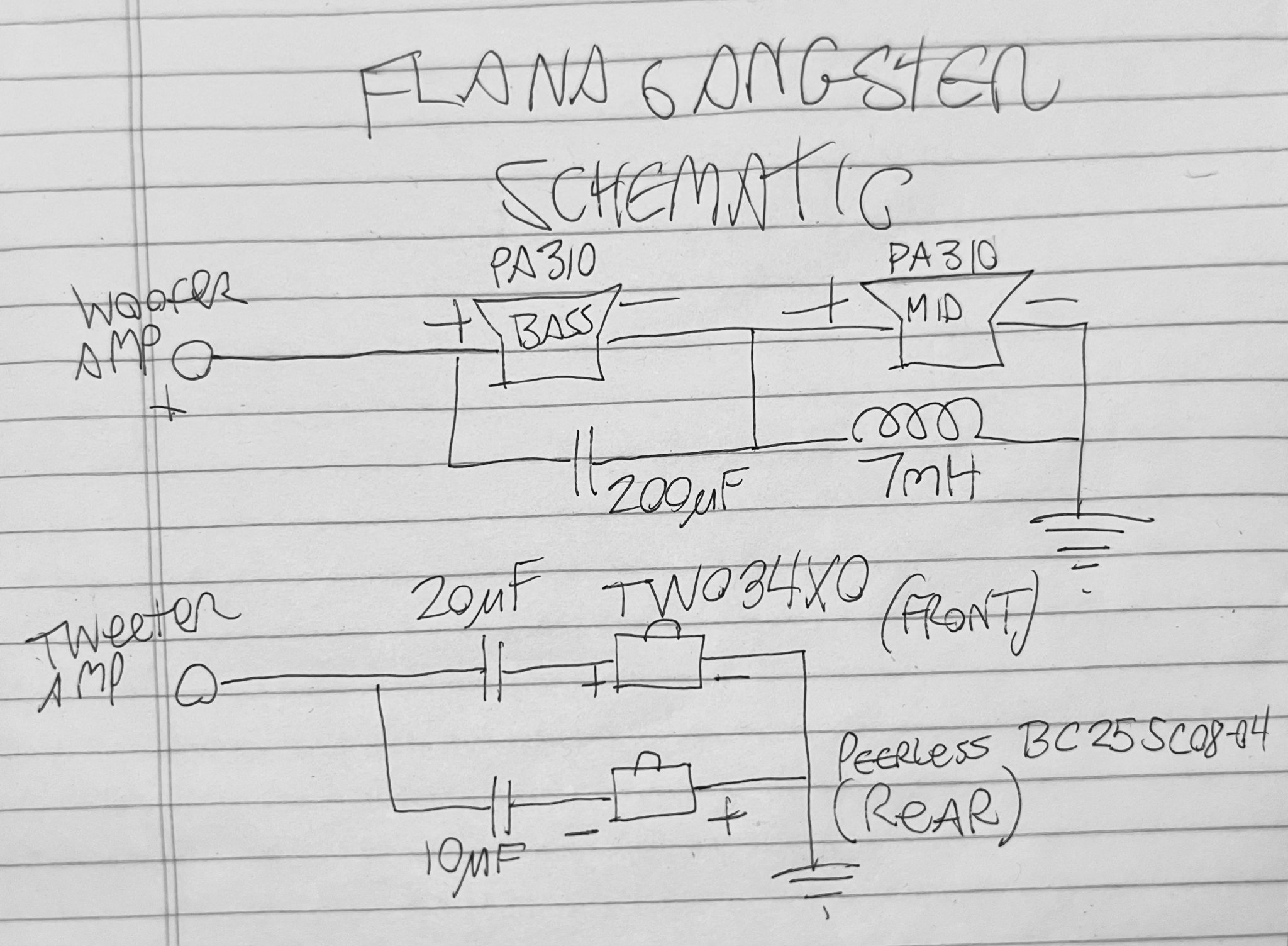

The 100Hz crossover is a 6dB/octave "series" configuration instead of the conventional parallel. It has better impedance interactions. This curve shows the drive signal of the 12" midrange, which is much steeper below 100Hz than a standard parallel design would be:
The blue curve is the input signal to the whole system, and the green curve is the voltage measured at the terminals of the midrange. The impedance curve of the woofer is being turned "upside down" and being impressed on the midrange. This is reducing the output of the midrange at 20Hz and 60Hz, which is desirable. A standard parallel network would impress the midrange's impedance curve "right side up" on the response, which would be undesirable.

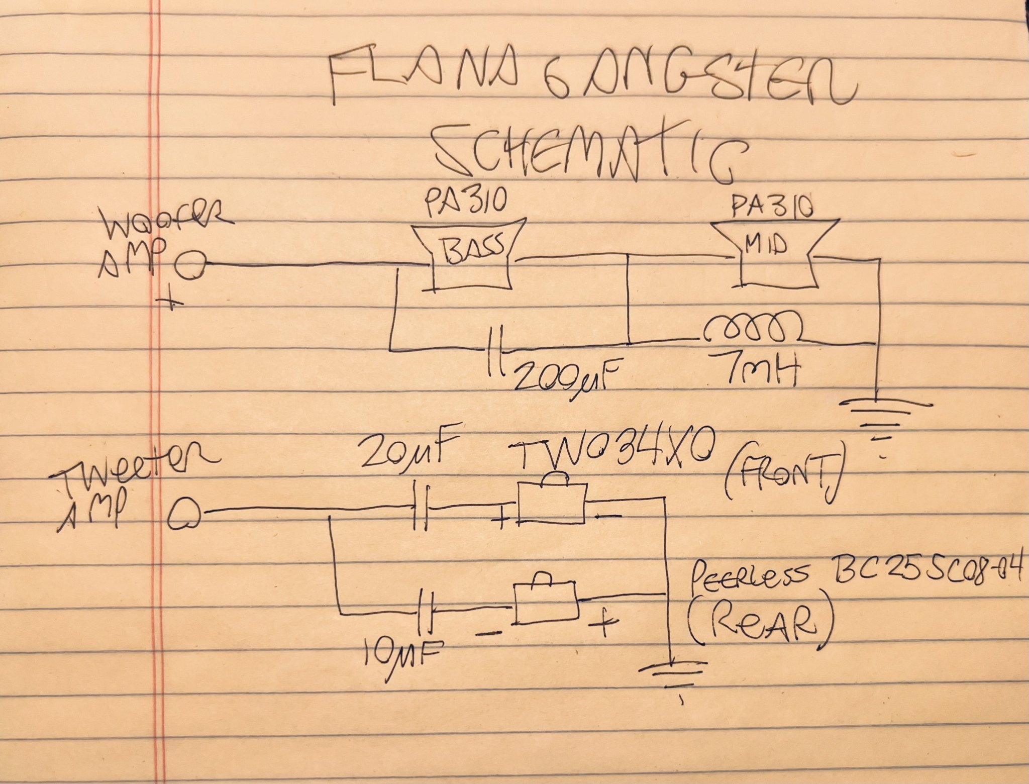

Schematic:
The LC circuit on the woofers is a 100Hz "series style" crossover. The capacitor on the TW034X0 is just for protection; the 10uF capacitor on the Peerless tweeter rolls it off at about 3K because I have concerns about driving it at lower frequencies. The rest of the crossover action is in the DSP.

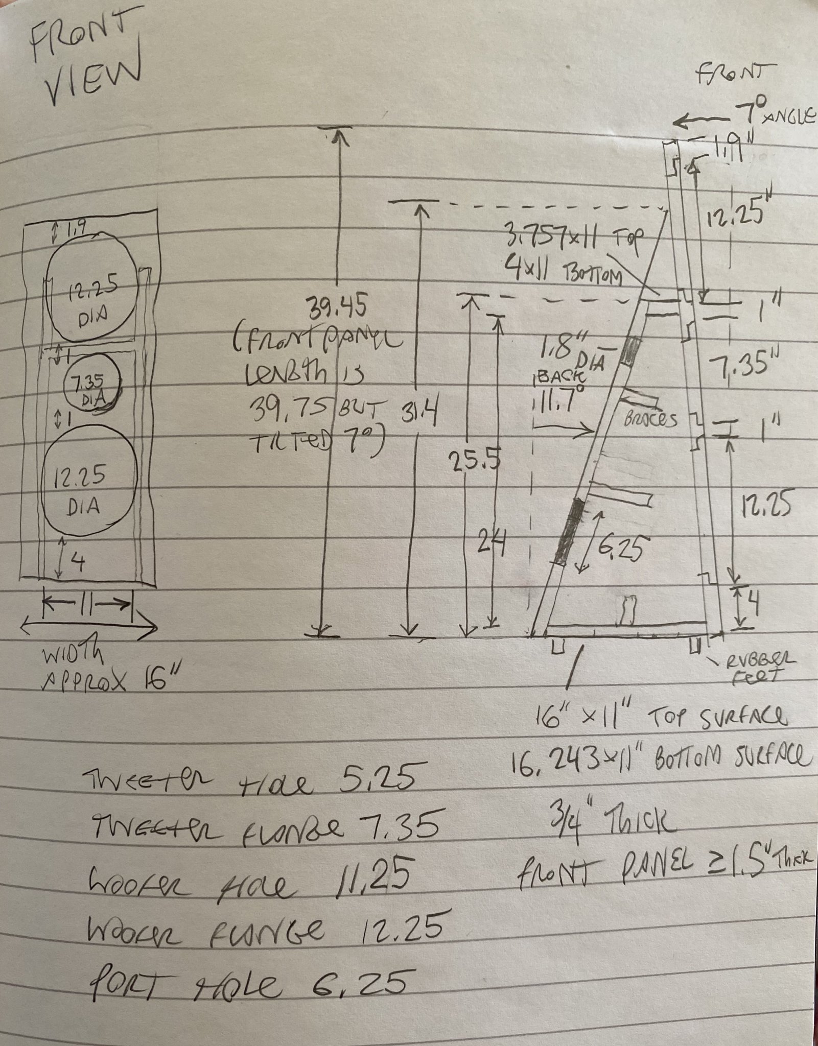

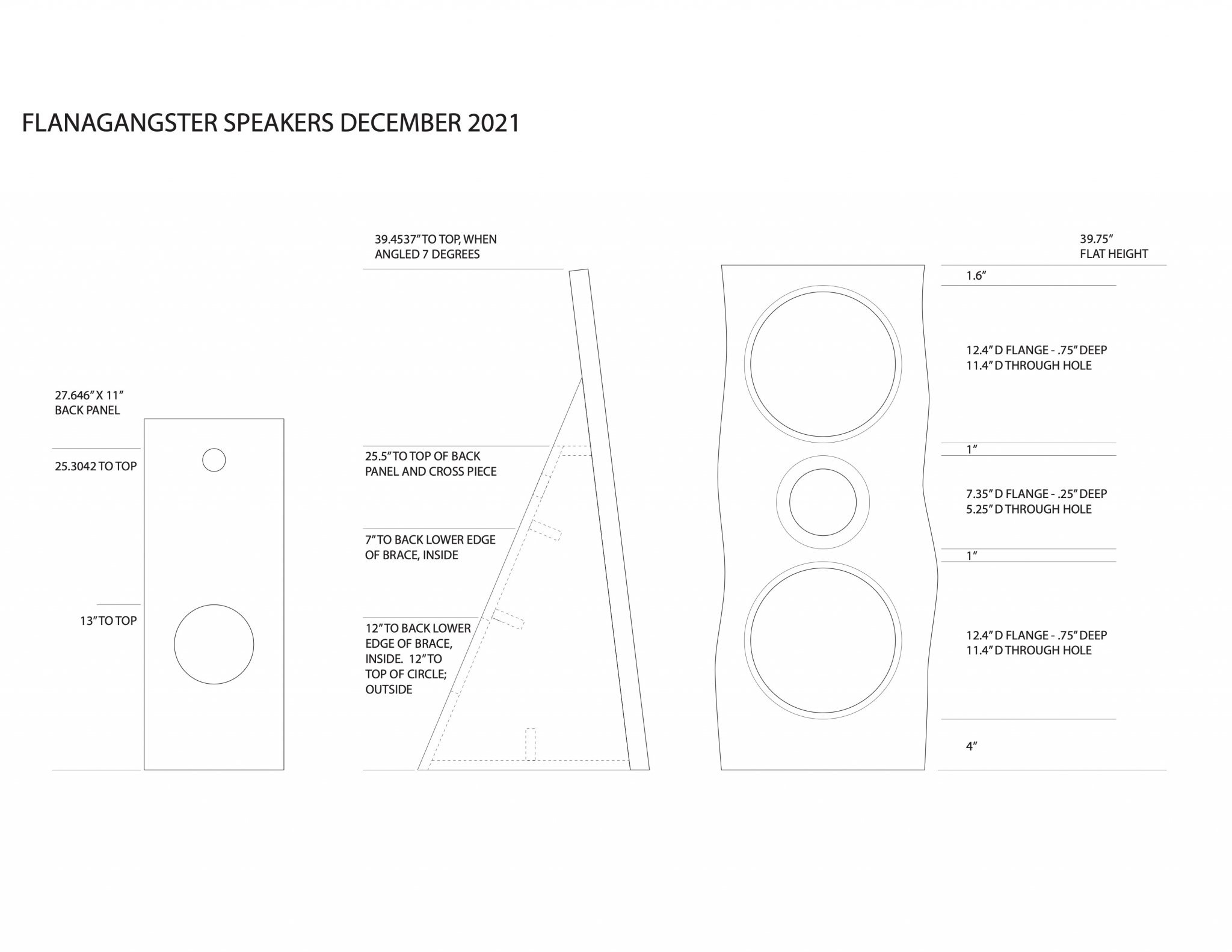

Seth's CAD drawing:
My original sketch:

Open Baffle speakers that radiate from both sides via woofers but have tweeters only on the front sound “wrong” to my ears. I prefer true dipole behavior across the whole range, so I added a Peerless 1” dome tweeter with waveguide on the back. This is the frequency response on the back side, measured 45 degrees off axis:

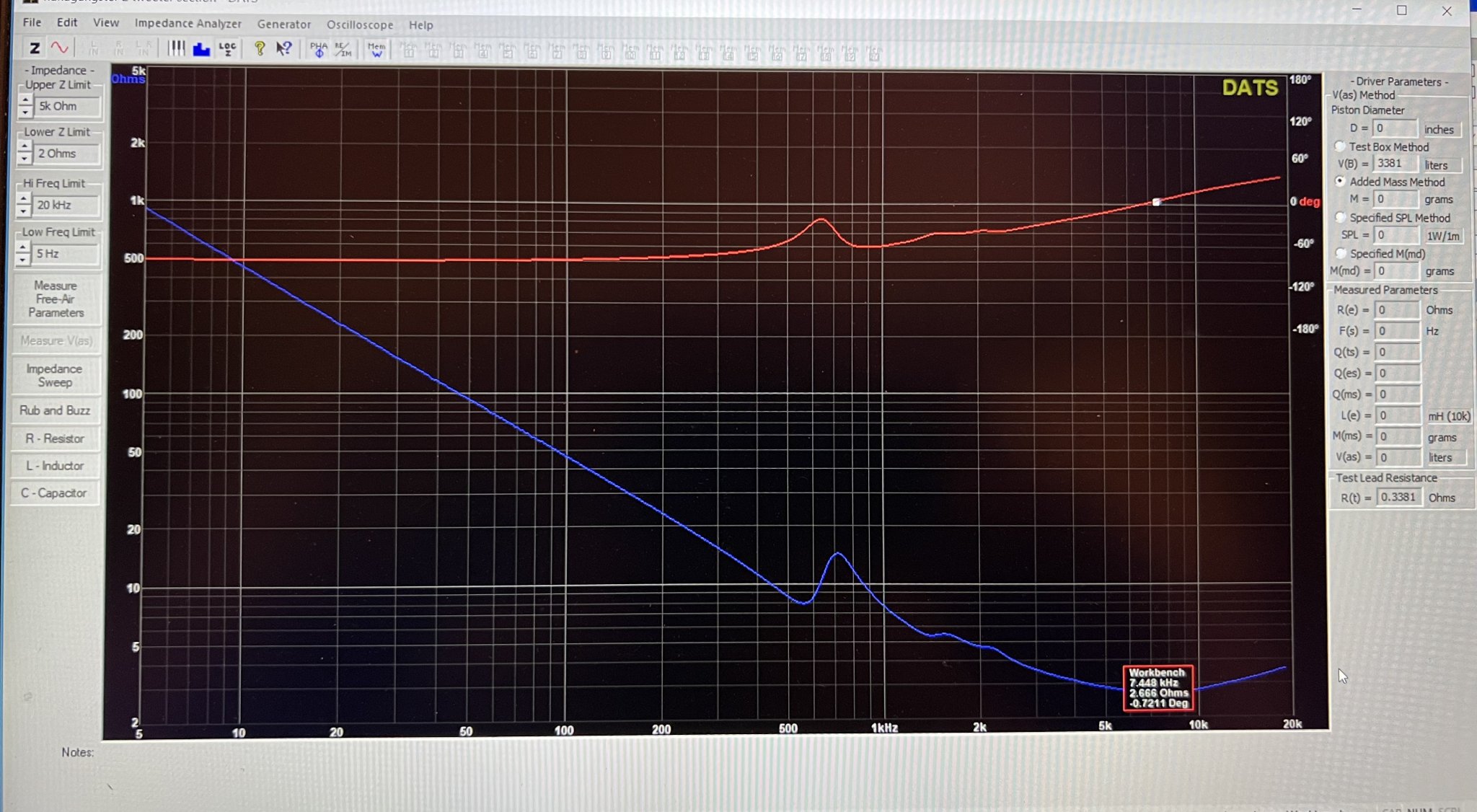

NOTE: The tweeters are wired in parallel and the impedance dips to 2.6 ohms. Since sensitivity is around 98dB and since most music doesn't have large power requirements above 2KHz this won't be a problem for most amps. But this could be an issue for some people.

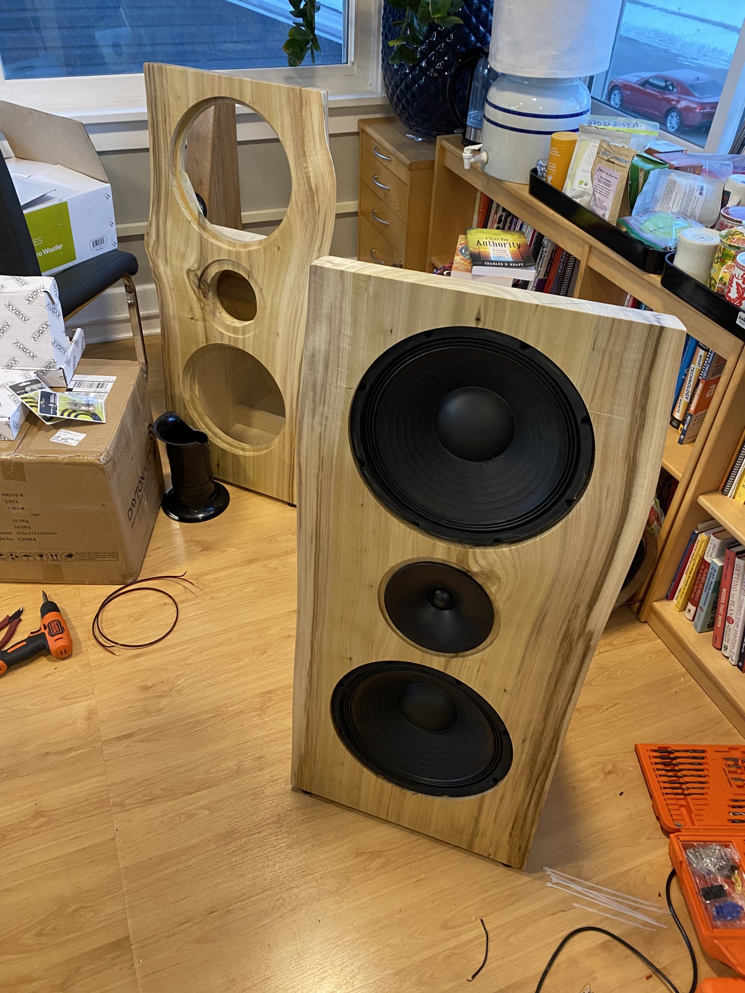

The cabinets were built by Seth Cothron (@studio38designs) and the 1.5” thick front baffles provide more than enough rigidity to get the job done.
Schematic:
Seth's CAD drawing:
My original sketch:

@perrymarshall can you elaborate on the 200uF cap you used on the PA310 bass woofer? Trying to cost out a BOM for these… thanks.

@tlarwa I am giving you the latest schematic and configuration files for the Birch Dipoles with Beryllium Diaphragms.
Config files: https://evo2.org/wp-content/uploads/2022/12/birch_dipoles_config1_17april2022.xml_.zip - these are for MiniDSP 2x4HD.
Schematic:
This is different from the original schematic in several ways:
The 22uF and 7 ohm on the upper left are a Zobel network. They just ensure that the amp sees a flat impedance curve above 200Hz.
The tweeters here are wired in series with parallel resistance across each tweeter. That gives a net impedance of around 10 ohms. It also pads down the tweeters because the tweeters are so efficient that they amplify amp and DSP noise. So I needed to reduce their efficiency. The rear tweeter circuit has an 8 ohm L-Pad.

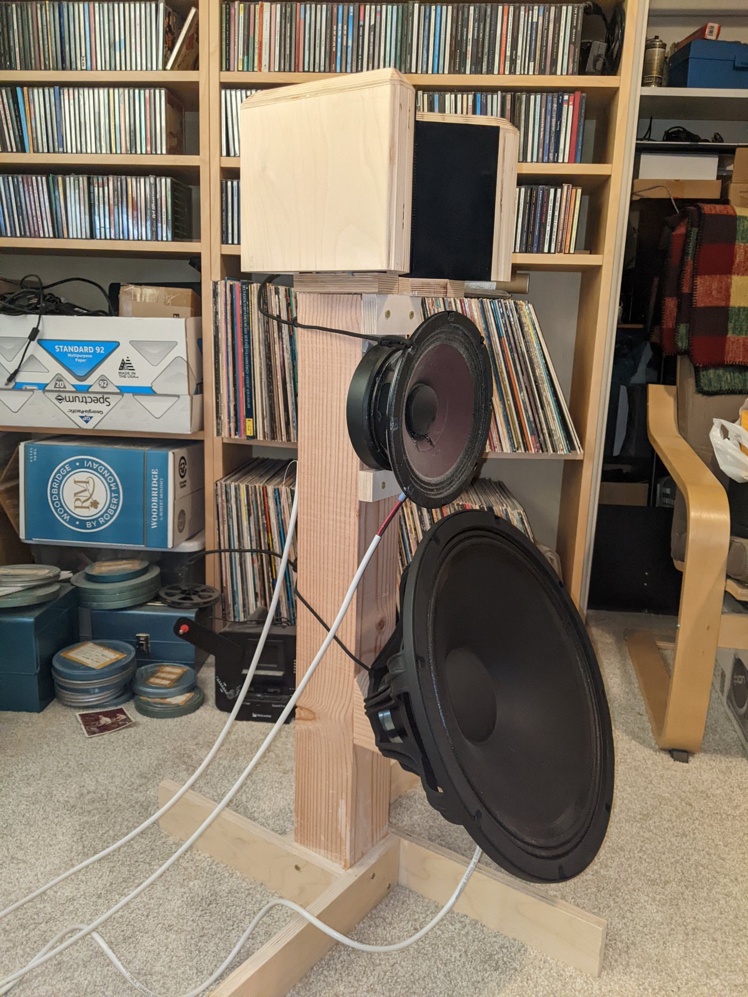

Too much nice woodworking in here, I figure I can bring the average down a bit with my latest OB lab project:
Top to bottom:
ESS Heil tweeter 1550 Hz & up
Eminence Beta 8a 450 - 1550 Hz
Faital Pro 15FH500 (8 Ohm) 80 - 450 Hz
Dayton RSS315HF-4 80 Hz & down (in the sealed box in the background, there's a second one midway down the left hand wall)
The Faitals were the only new drivers for this round, and they were on sale for a very good price. The rest I owned.
The rest of the system:
RPI 4 running Moode via SPDIF coax out, or Qobuz streaming via PC and Topping D10 DAC Toslink out
miniDSP 4X10HD
4 channels of Modulus 86 amps for the tweeters and mids, built by YT
Audiophonics Hypex NC252 stereo amp for the woofers (also new for this build)
Crown XLS1000 for the subs
The construction is crude, a 4x4 and some scrap plywood slapped together in an afternoon. The mid and woofer are held in place with paracord. The hood on the Heil was done a while back, so long ago that I can't tell you how much it actually changes the response.
The woofer is tipped back to aim the forward lobe more at my ears than my ankles (or the floor), and to put the nearby drivers as much as possible into the null of the woofer's response.

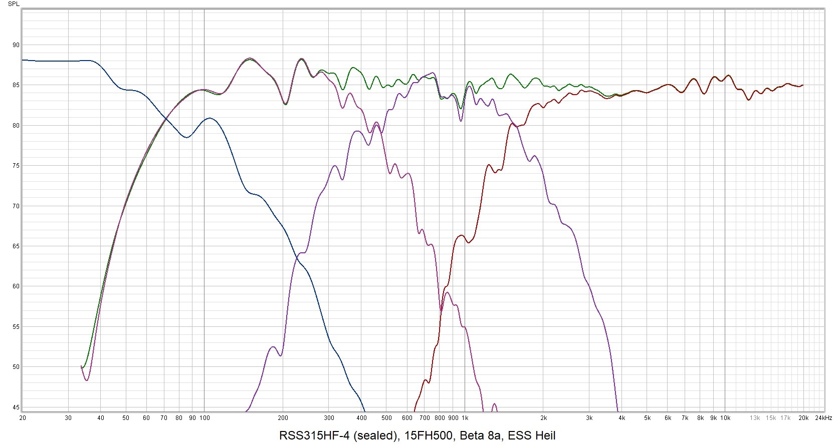

Getting good measurements of an OB system in a small room (14 x 11 ft) is not easy, but here's what I have today from REW and a UMIK-1. The sub measurement is a single sweep at the listening position with both subs on, PSY smoothed and level adjusted by eye. The rest were taken about 32" from the tweeter, mic centered on the tweeter, no smoothing beyond gating @ 30 ms (7 ms on the tweeter) and a 1/24 octave frequency dependent window. The green trace is the combined response without the subs:

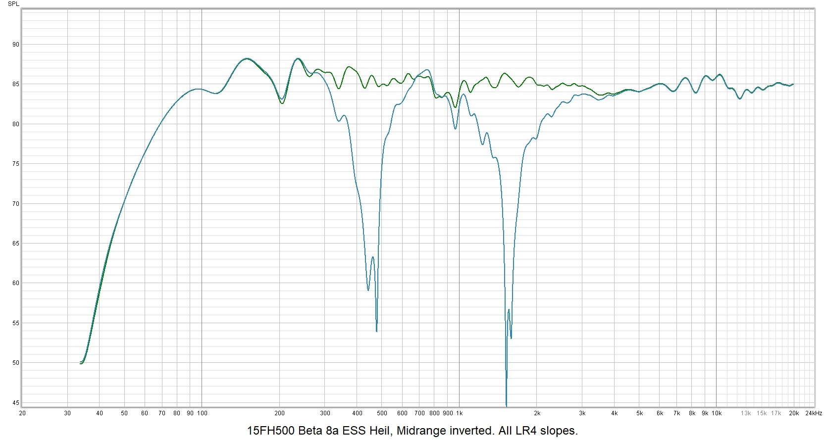

Tweeter to mid to woofer crossovers are all LR4 slopes, with whatever EQ was needed to get there. The T-M-W physical offsets worked out so that no delays are needed in the DSP. I put a first order highpass on the woofers to keep excursion low. There is a LOT of EQ on the Faital, but it's so efficient that I can get away with it.
The room has a huge peak at 39 Hz, deep notch filters are needed on both the subs and the OB woofers to flatten that out.
Here's what I get with the mid phase inverted - pretty decent nulls if I say so myself:
OB bass is not supposed to work in a small room, but this sounds pretty good so far. In fact the whole thing sounds pretty decent IMO. I'm going to live with this a while before making any changes, and contemplate how to make it prettier.
Bill

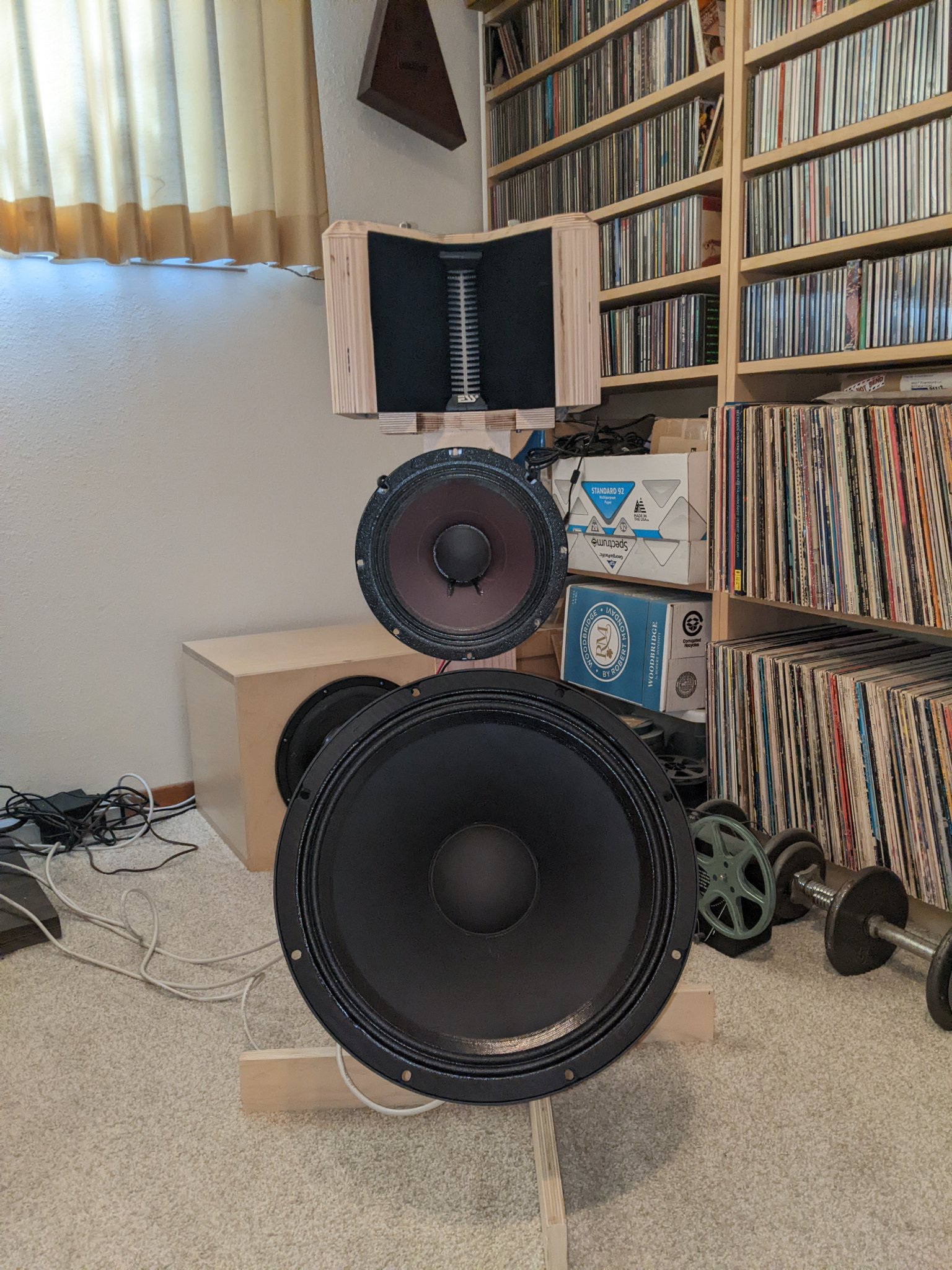

Top to bottom:
miniDSP 4X10HD
Bill

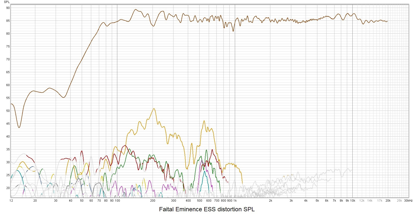

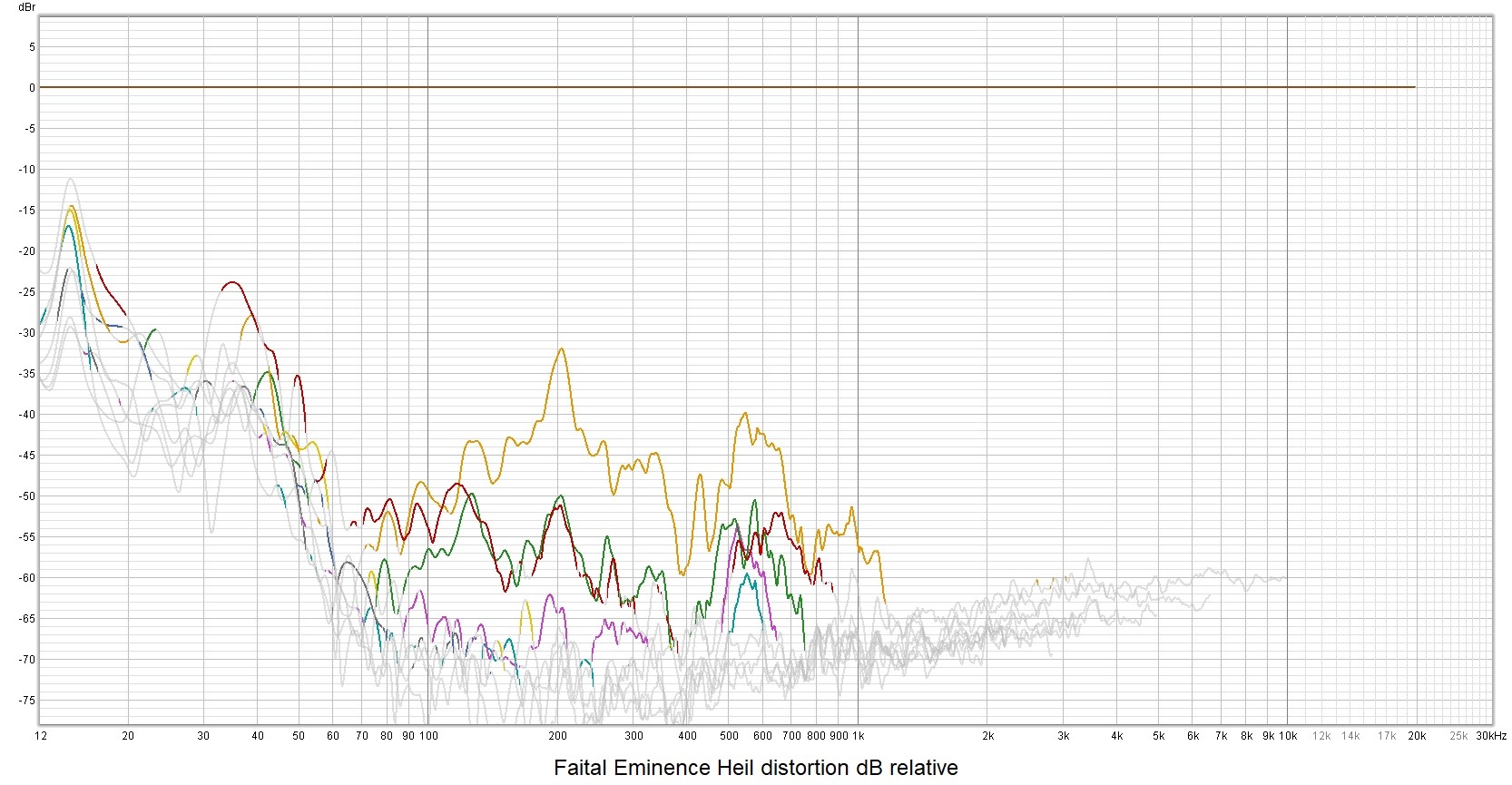

Can you reveal distortion lines?
Here is the measured distortion, excluding the subs, in actual SPL and relative. In each graph distortion below the noise floor is greyed out. Both the 15FH500 and the Beta 8a show a bit more 3rd harmonic (yellow trace) than I would like to see, but I'm not sure how audible that would be. I do ponder what drivers would improve performance in those two positions.
Bill
