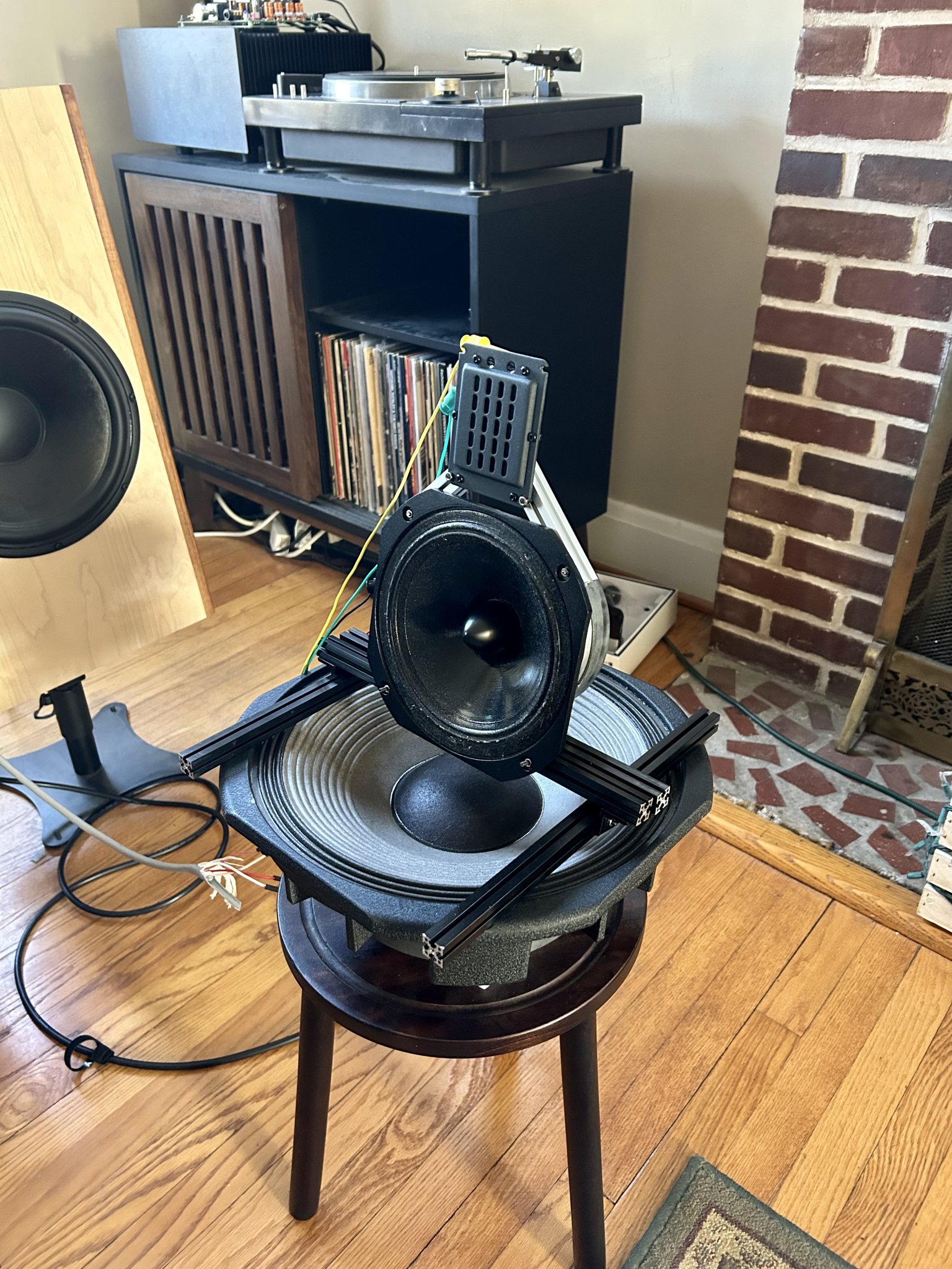

Revisiting some No Baffle Sculpture fun!
Finally getting ‘round to playing with my MiniDSP Flex Eight and the 6-channel class D amp I built with @Erica.C modules.
Drivers here are JBL 2217HPL, Focal Audiom 7A2, GRS PT2522-4. Crossover is LR24 at 250 and 2000. PEQ to taste.
Sounds good enough futzing around by ear that I will likely build a couple baffles for these. :smash:

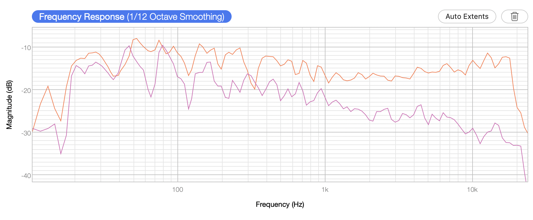

I'd like to show you some measurements of the Bitches Brew design and discuss more of the thinking behind it. (Original post https://www.diyaudio.com/community/threads/ultimate-open-baffle-gallery.123512/post-6682515 )
In this graph...
bitches brew on axis vs across the room 60 degrees off axis one-twelfth octave.png
You see the microphone about 4 feet in front of the left speaker, on axis, (red) and without moving the microphone, the purple is the right speaker, about 8 feet away and 60 degrees off axis (purple). It illustrates the behavior of a true Wideband Constant Directivity speaker. Even the midrange and bass are directional and 60 degrees off axis the whole curve tilts evenly downward.
The only possible way I know of to achieve this is with a huge horn (that would not fit in any normal living room) or else Open Baffle with CD horns that smoothly integrate with the radiation patterns of the woofers.
This is the same curve, but 1/3 octave smoothing instead of 1/12:
...which is more representative of what your ear hears.

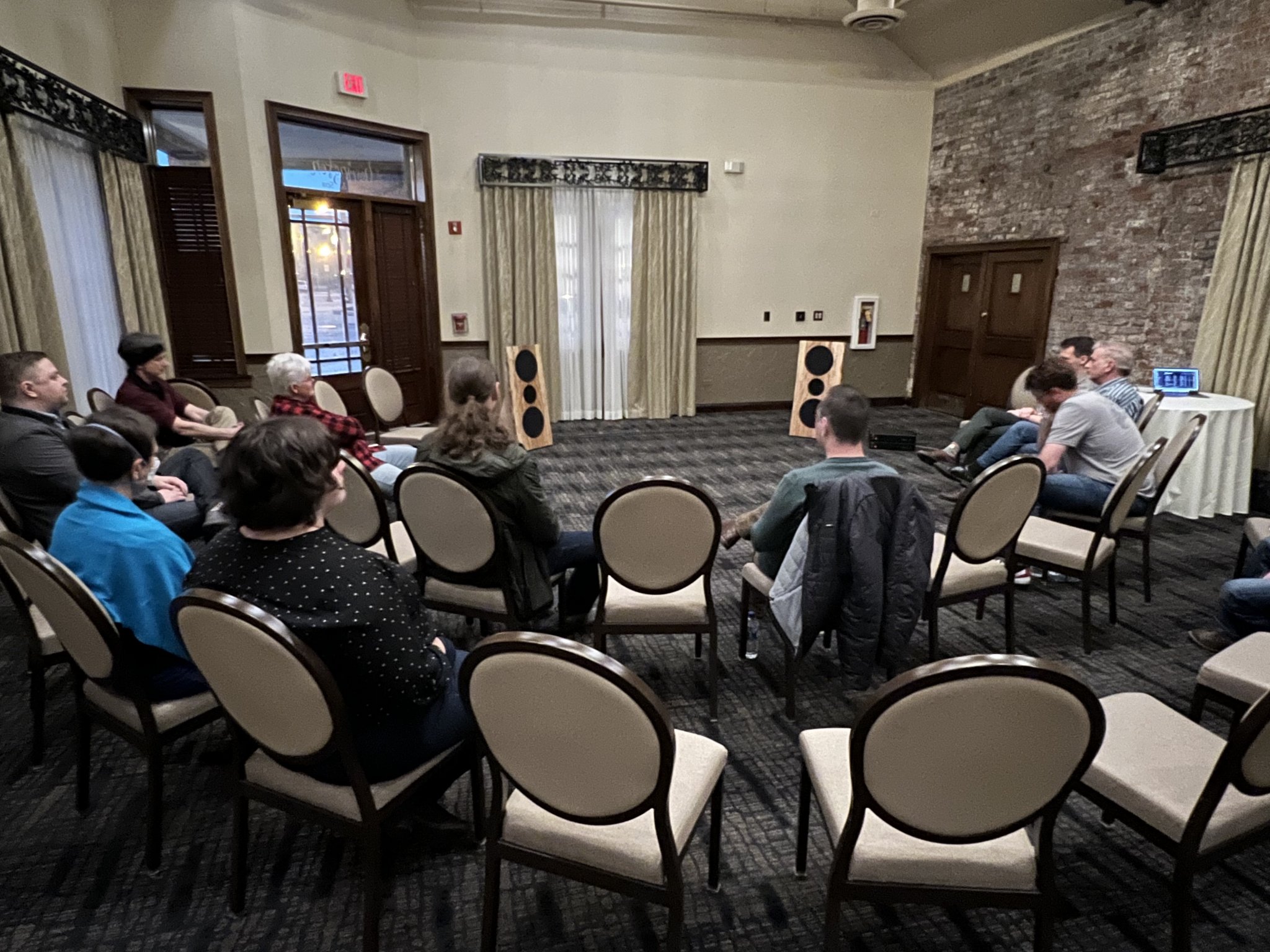

There is a huge payoff to this for stereo imaging, because I have hosted listening parties with 20-30 people and EVERYONE hears a great stereo image. I arrange the chairs in a big 2/3 circle that stretches from the outside of the left speaker all the way to the right. The photo below is a listening party at a hotel, with a different dipole project that I hope to write up someday:
You can stand right next to the left speaker and hear the right speaker equally well, across the room ten feet away.

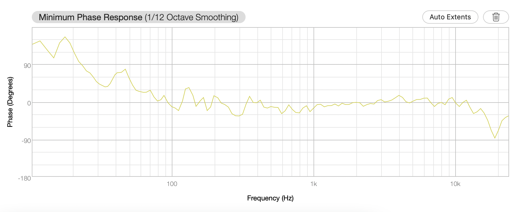

The other issue I want to raise is flat phase response. This is the phase response curve of the Bitches Brew design:
Very very few speakers come close to this; nearly all speakers with passive crossovers have polarity reversals and phase rotations. A very few manufacturers of passive speakers (Thiel, Vandersteen, Duntech) attempt to address this. The rest just ignore it. I work around the phase issues with DSP FIR filters. But what I want to focus your attention on is the low-end phase response, which runs only about 45 degrees positive in the main bass and only tends towards 90 degrees below 23 Hz. A reflex speaker will be at least 180 degrees out of phase at the tuning frequency.
Most people say you can't hear this, but you can prove otherwise to yourself if you have DSPs and do a little experiment.
Play "Fear of a Blank Planet" by Porcupine tree, whose bass drum has a lot of high-end slap but also delivers a very low fundamental around 20-30 Hz. Set a 20Hz high pass (infrasonic) filter and then try changing the slope from 6 to 12 to 18 to 24 to 36dB.
You will easily hear that with steep filters (=longer phase shift) you hear the slap first and the "boom" of the low bass comes LATER. As in, the two sounds arrive at different dates. Try it with a set of headphones if all your speakers have steep low end rolloffs.

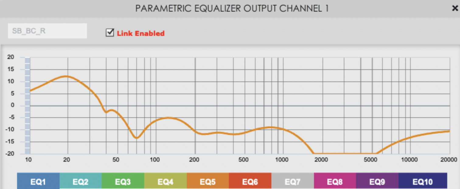

Open Baffle speakers have 6dB per octave rolloff from the baffle loss and 12dB per octave roloff from the drivers, for a total slope of 18dB per octave.
I used low Q notch filters to create a 20Hz bass boost for the Bitches Brew woofers which you can see here:
The low-Q EQ boost preserves phase information. In well-recorded music with lots of bass and percussion, the timing is impeccable.

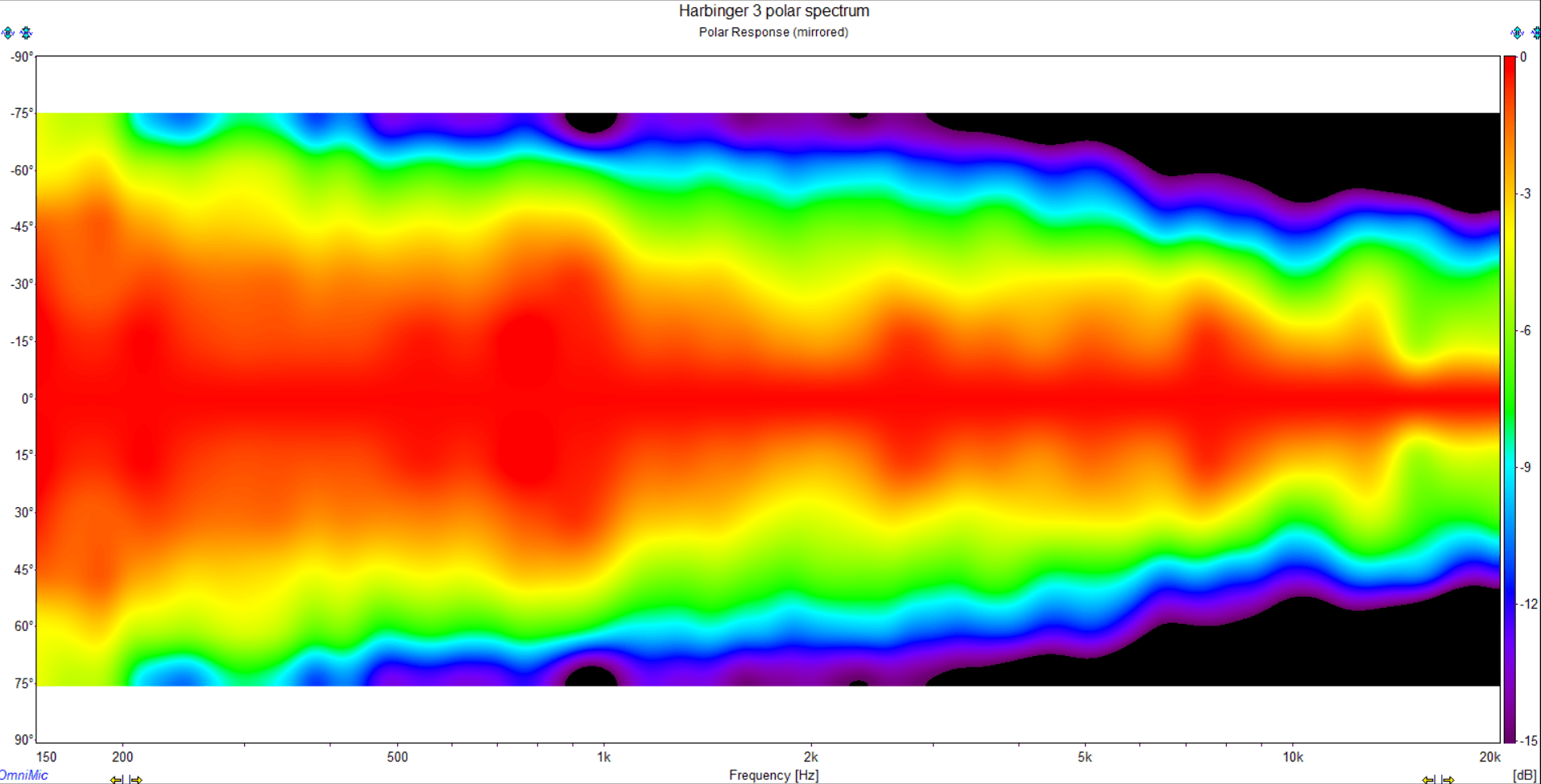

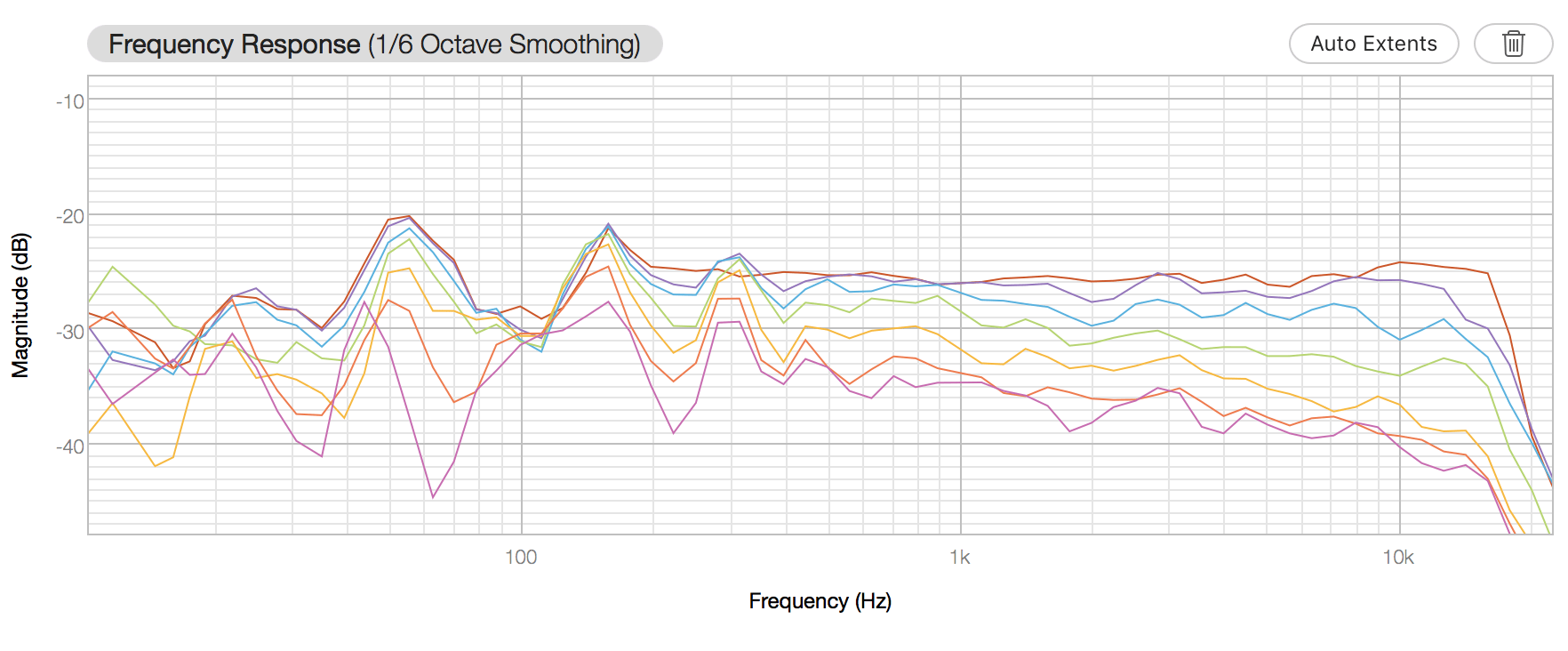

Do you have any full anechoic polar response, CTA-2034A or spinorama type measurements to share?
Have you considered sending them to Amir in Seattle to measure?
I don't have anechoic or spinorama, I do have these taken in my listening room:
In the above graph, I suspect the "bunching" around 100 Hz disappears at greater distances. This was taken with the speaker on a turntable in my room at 0 15 30 45 60 75 degrees.
Because of the limitations of my room, accurate low frequency measurements are difficult. Sending them to Seattle would incur some expensive shipping. But there is no question that the polar pattern is a figure 8 dipole. Do you know of any other speaker that is constant directivity from 20Hz-20Khz?
