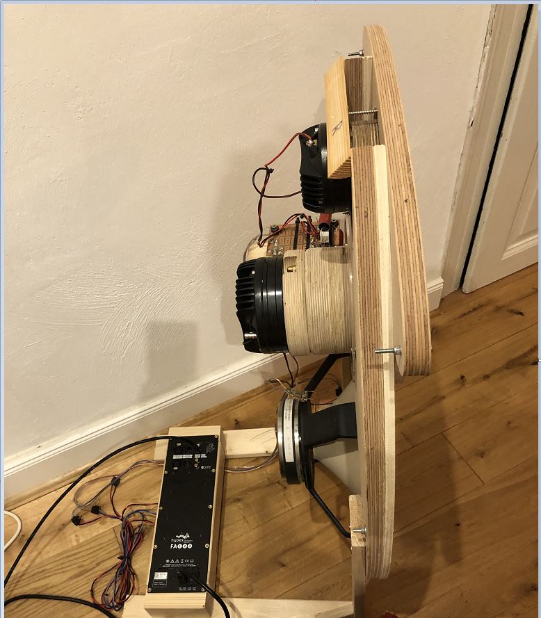

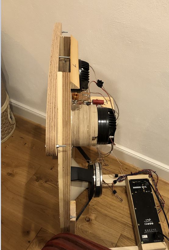

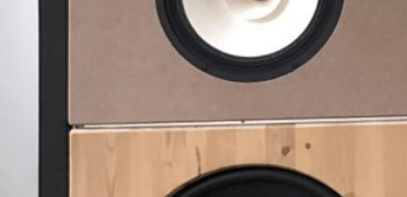

I sized by trial and error the full range baffles size to act like a high pass filter when placed on stands.
Leaving a little gap allows a little dip in lieu of a crossover to the bass baffles.
This gives a natural sounding blend while setting the 4th order plate amp lowpass at about 95 hertz.
Post script- there's a fair bit more apparent gap width than what appears in the phone camera close up photo.

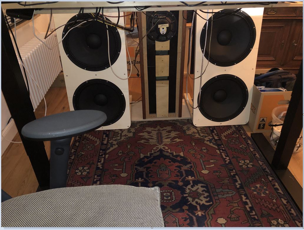

I’ll try them initially over 30hz-150hz, but I intend playing around with that and seeing how high they will go without compromising the SQ
Good plan. A hard cut at 30Hz should protect the woofers but what is the Xdamage for the BMS 18" woofer? The BMS looks designed for box back pressure so with OB it could easily max out. With clam pressure coupling and high power amps its something to beware of. Is there a way to prevent bottoming out?
Yeah they are too expensive to trash ! The people who have implemented the clam shell configuration do so with them acoustically in phase so that the cones move in the same direction at the same time. The pressure between the cones should not therefore increase.
I looked at the price. Shite. Definitely its a good idea to protect them. The clam arrangement with the drivers moving in unison means they assist each other. Theres about 50% less air resistance over a standard OB which is obviously much less then the intended box with pressure braking. So the clams are the perfect way to bottom and destroy a driver. The drivers assist and push each other into mutually assured destruction.
Do a search. I bet some have trashed woofers with clams. But it would take a brave person to admit to doing that so maybe its unheard of?
If I were you Id use the paper X-displacement-o meter that Siegfried Linkwitz discussed, to work out X-max vs freq with your amps and then put in a protective high pass. By keeping the woofers below X-max you keep HD under control and have a safety margin in term of X-damage.
