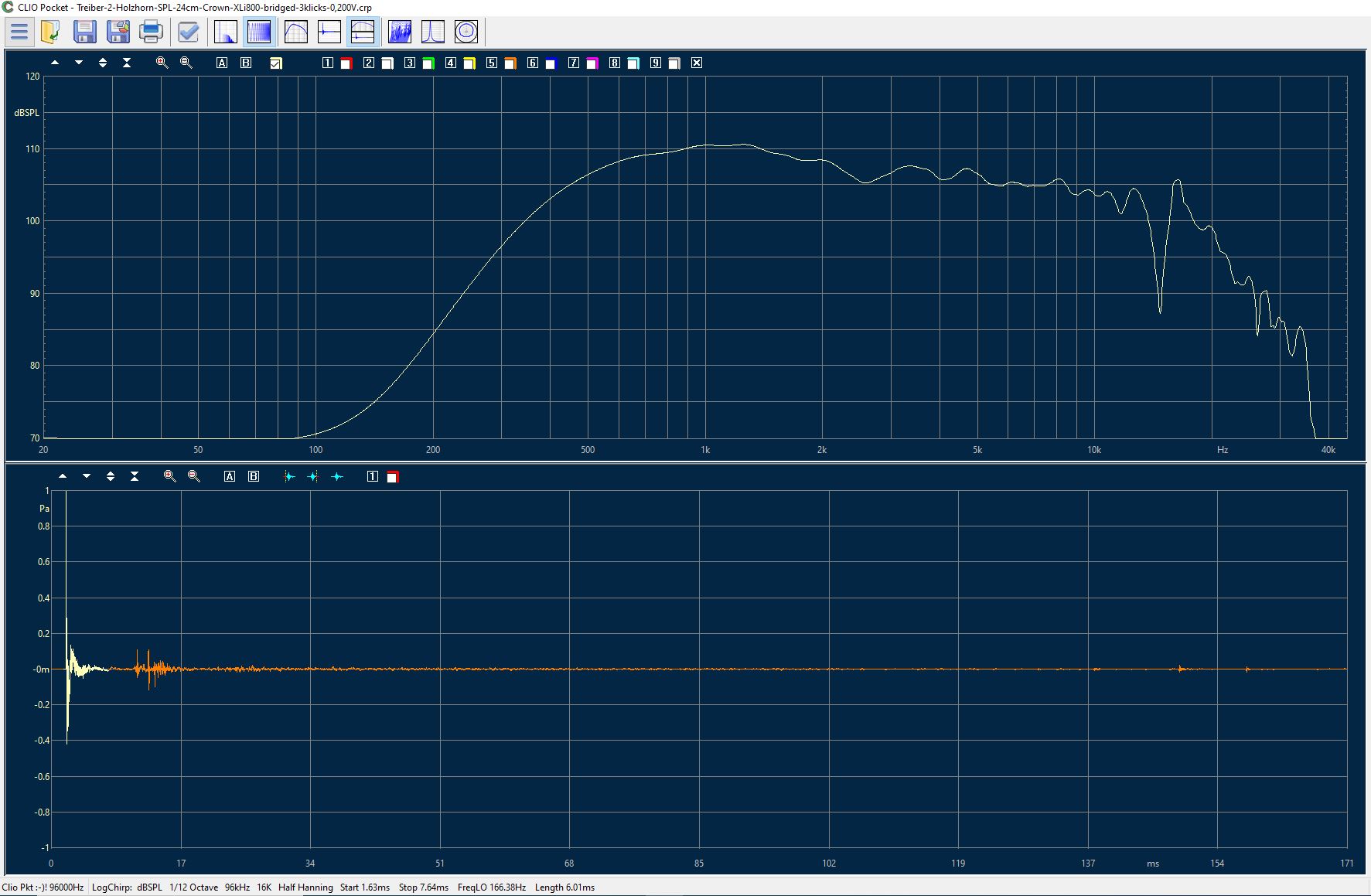

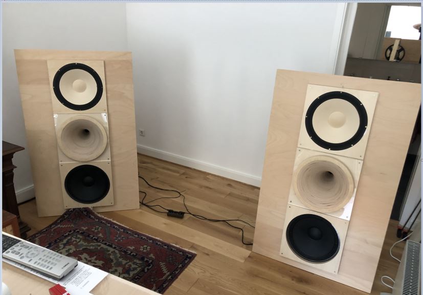

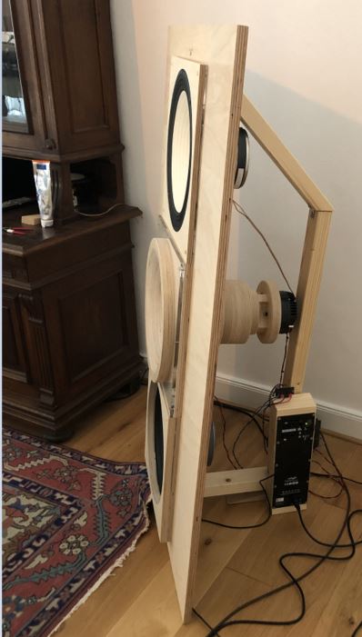

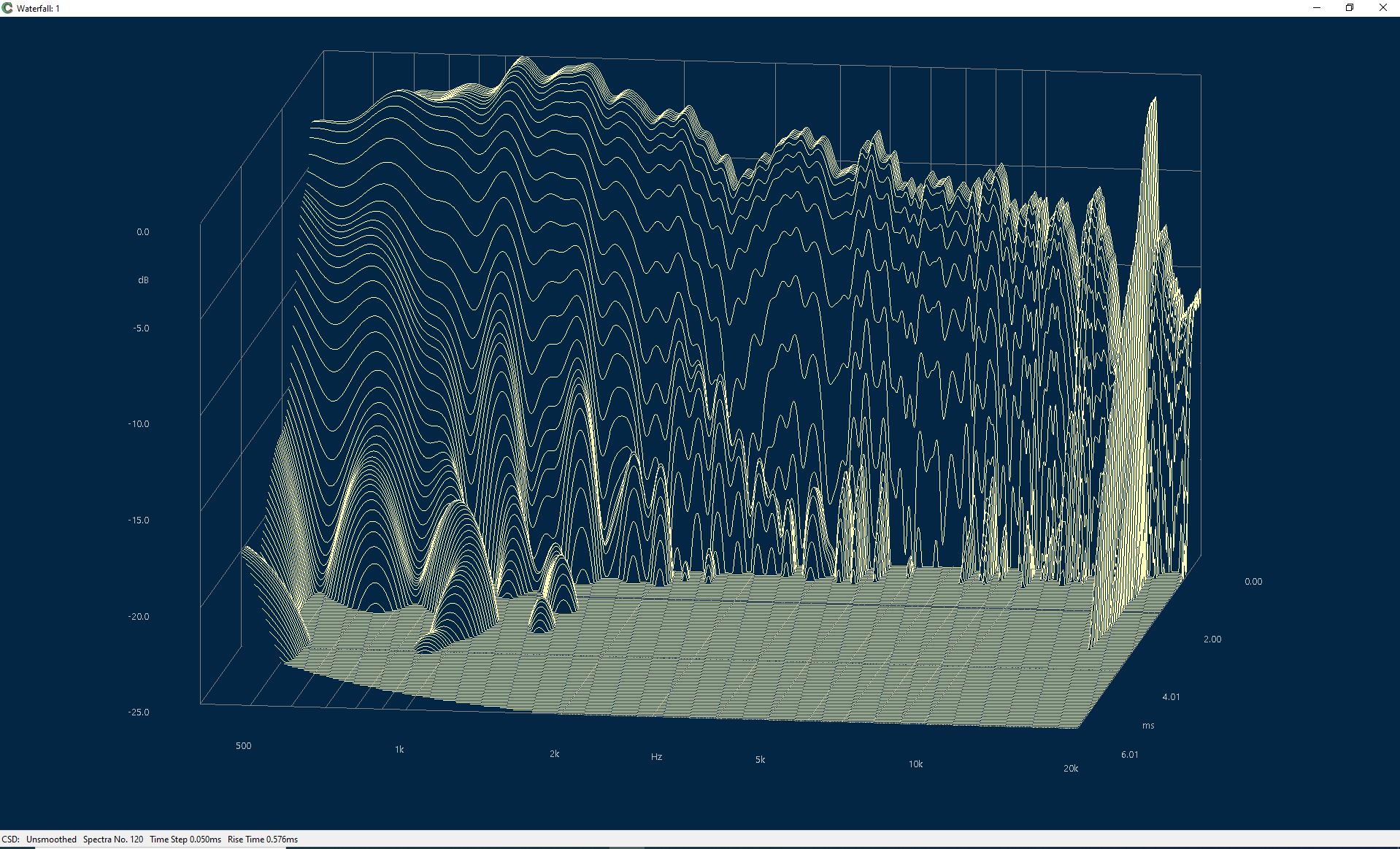

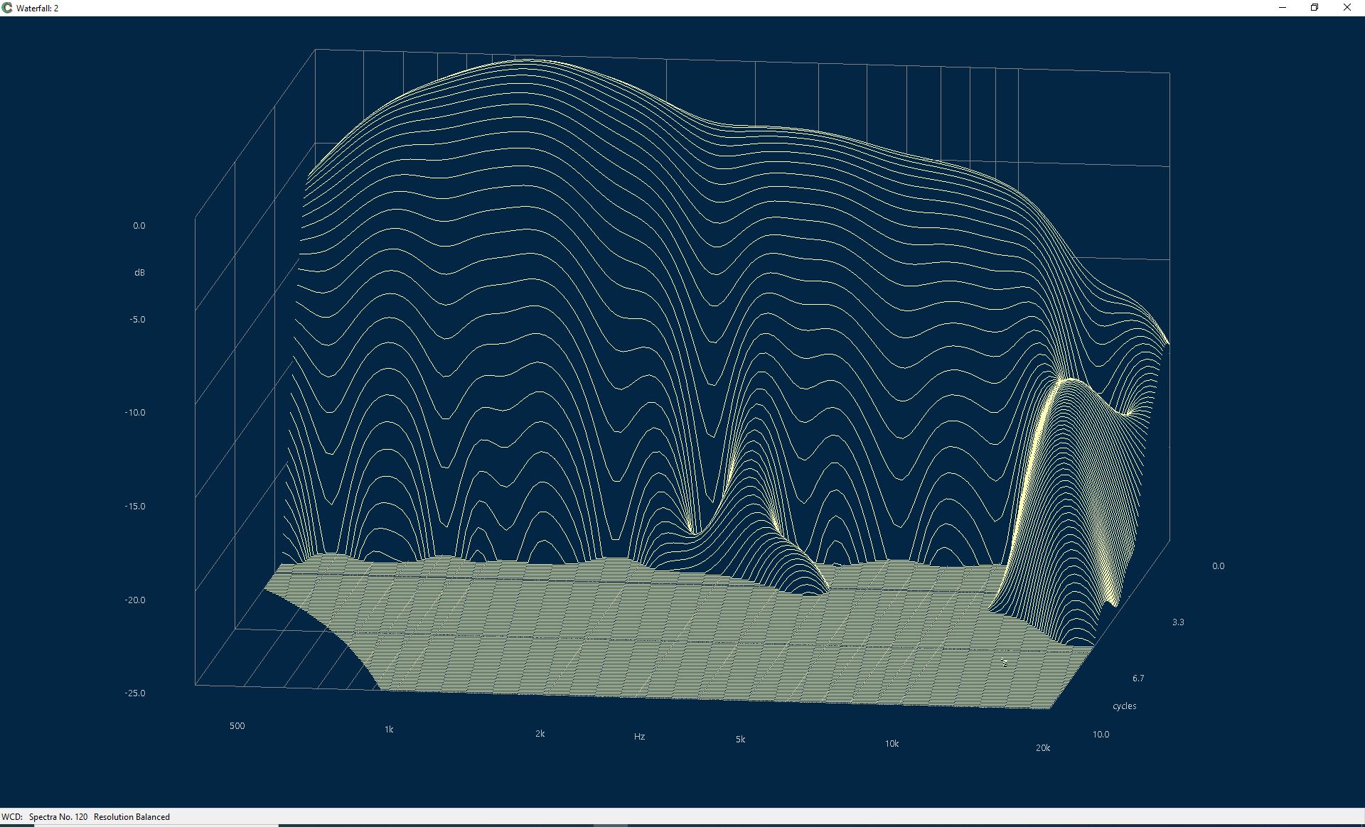

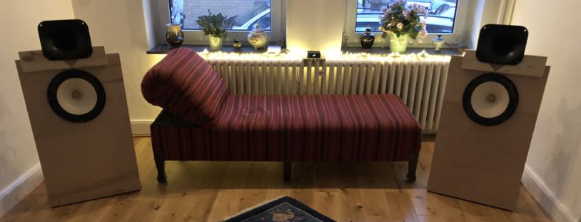

Here my construction for the preliminary evaluation of the combination of Subwoofer Celestion FTR15-3070C and Sonido SCW400 (not sold anymore) as open baffle with a quite large wooden horn.
Subwoofer
Woofer low midrange driver
Sonido SCW 400
Mid - high range wood horn and compression driver
LMH sTrak 40 cm with Eighteensound NSD 1480N 1.4 inch driver
Plate amp
Hypex FA123
SW
20 Hz HP BW3
85 Hz TP BW2
Delay 501 uS
Gain +7.5 dB
W
20 Hz HP BW3
440 Hz TP BW3
Delay 501 uS
Gain 0 dB
MH
800 Hz HP BW1
PEQ 1200 Hz Q=0.6 A=-4.5dB
PEQ 4000 Hz Q=1.2 A=-1,5dB
Delay 0 uS
Gain -7.5 dB

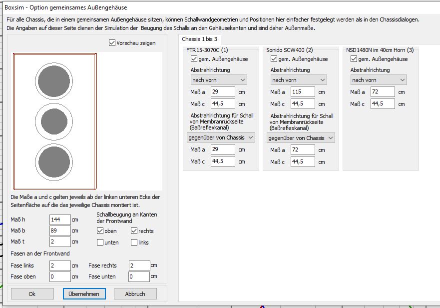

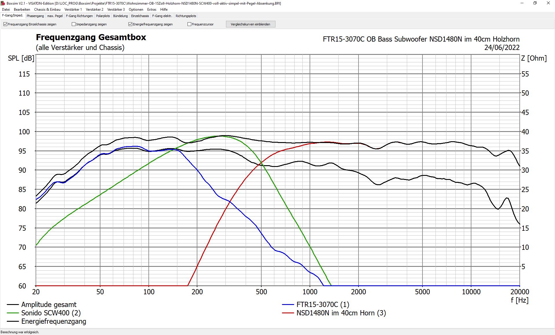

Visaton BoxSim simulation with imported CLIO pocket measurement for the wood horn driver combination
Sketch of open baffle construction
CLIO measurements wood horn

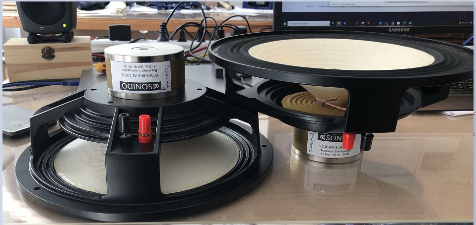

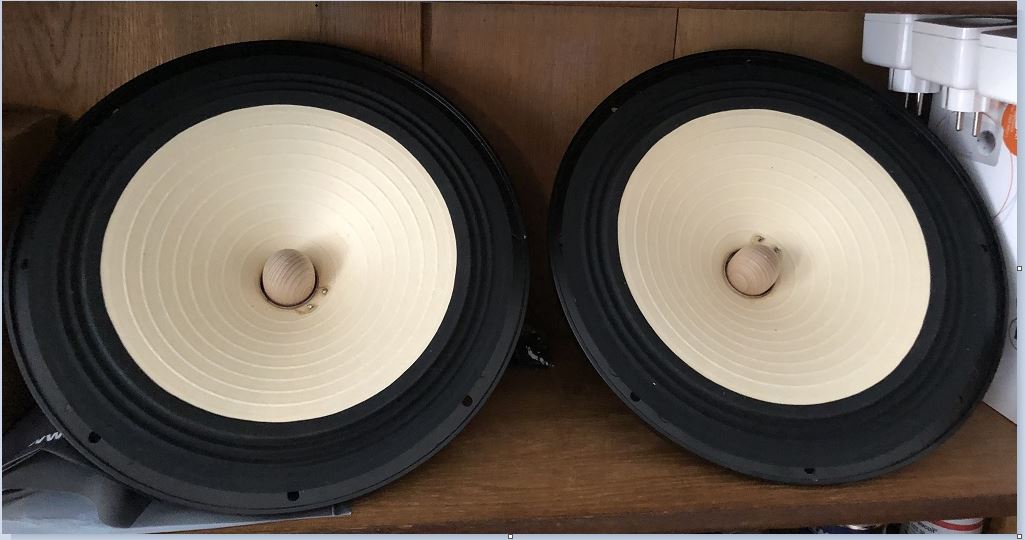

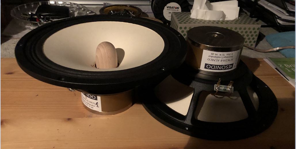

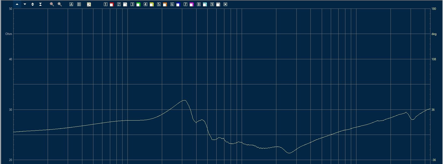

Hi there, it is historical. The driver has been chosen without the initial purpose to use it in an open baffle project. This chassis is the 15 inch bass with the lowest distortion available in the midrange for a decent price beside some very expensive special purpose chassis like the woofer of Acoustic Elegance like this here AE DIPOLE 15. From a PA use perspective it is more a midrange driver with a very good kick bass down under no more than 80 Hz. The Sonido SCW400 woofer is probably even less suited for open baffle use, i have these woofer since a couple of years, Sonido do not sell it anymore. The Sonido chassis are known for their vintage behavior like Saba cones with very low Rms (very low value for mechanical losses of the mass-spring system) of the values good for low listening sound pressure levels. In the final version i will use two of those Celestion 15 inch woofer in the subwoofer segment of a segmented baffle like this one:
With the active crossover with PEQ approach you do not have serious problems to get low frequency sound pressure out of a bass chassis beside some efficiency issues, i have to equalize more to get out more sound pressure than with a special purpose open baffle woofer. Many people says that the so called special purpose open baffle woofer are low cost castrated woofer with a far too small voice coil diameter and a low cost mini size magnet like this woofer here:
LAVOCE WSF152.02
LAVOCE WSF152.02
In the final version of the open baffle the project will be 4 way with 2 Celestion 15 inch as subwoofer and this chassis here for the 3 octaves for the kick bass from 110 Hz to 440 Hz:
this vintage style 12 inch Sonido custom driver with no whizzer cone have a Qms=17,8 value and the lowest Rms value i have ever seen for a 12 inch bass

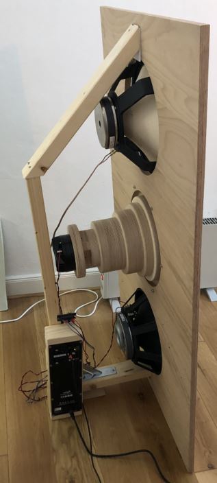

I use them now in my open baffle light test construction here:

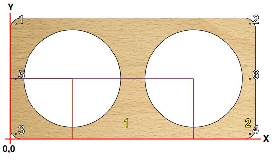

the segment of the baffle will be this one, wood parts are in delivery:
