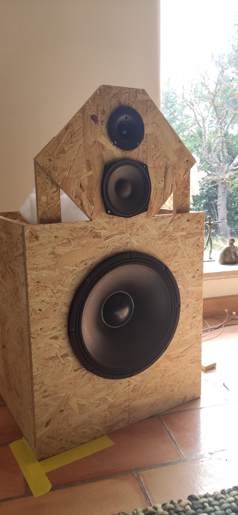

I wonder if I should try that from 400 to 2000...(BC 6md38)
Do you think I would get good results?
I tried a kind of triangle it was not good...
Rectangular offsetet gives better results but not perfect...

Thanks for your reply.
I was only focus on the open baffle lower cutoff frequency and diffraction. Diffraction software show that it is better to offset...
As I crossover at 400hz I am not sure if I need such a big baffle...
For the time being I'd like to find a nice shape that would optain nice baffle step and diffraction results.
I might try the linkwith shape or the truncated pyramid...with centered speakers as mentioned.
Thanks again

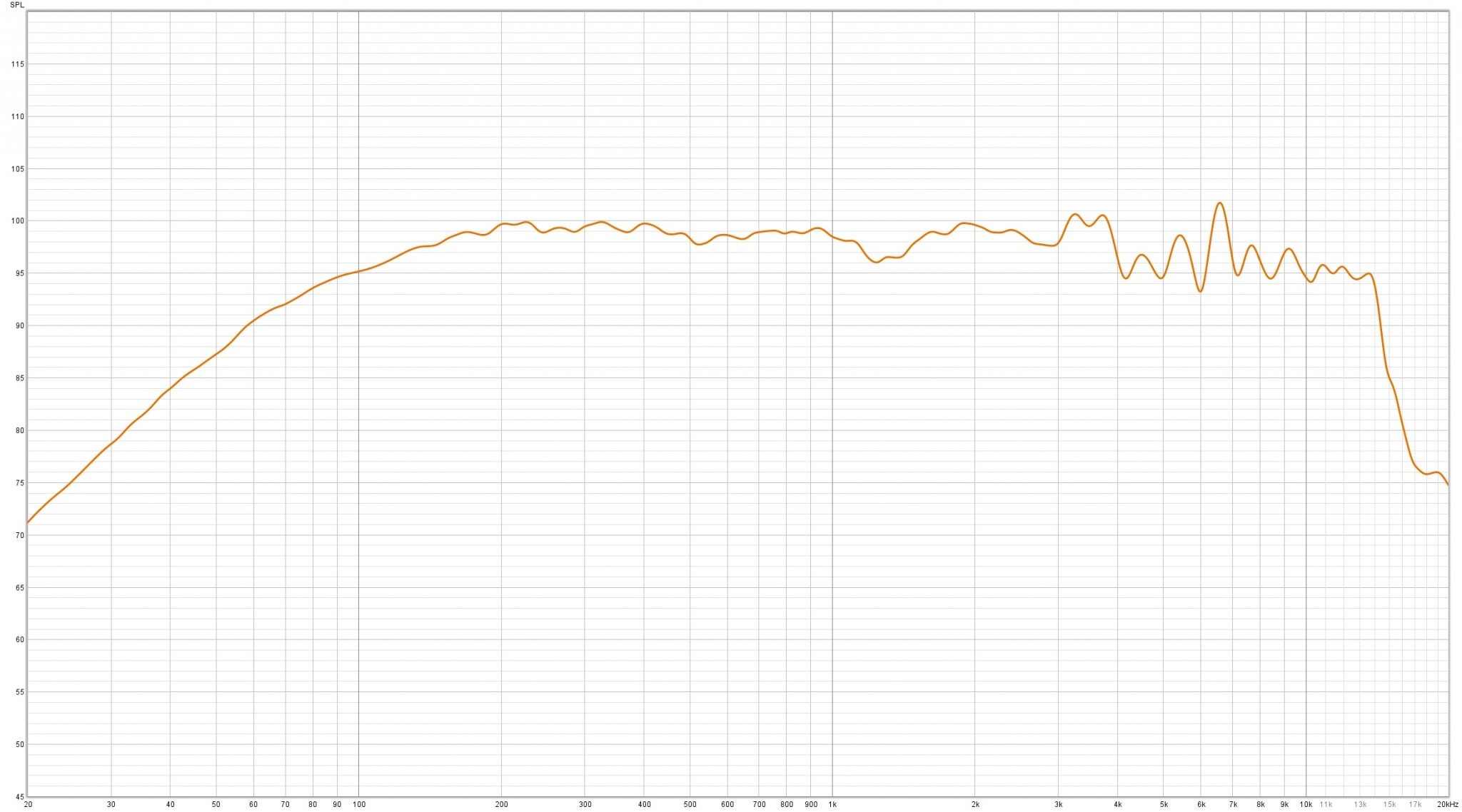

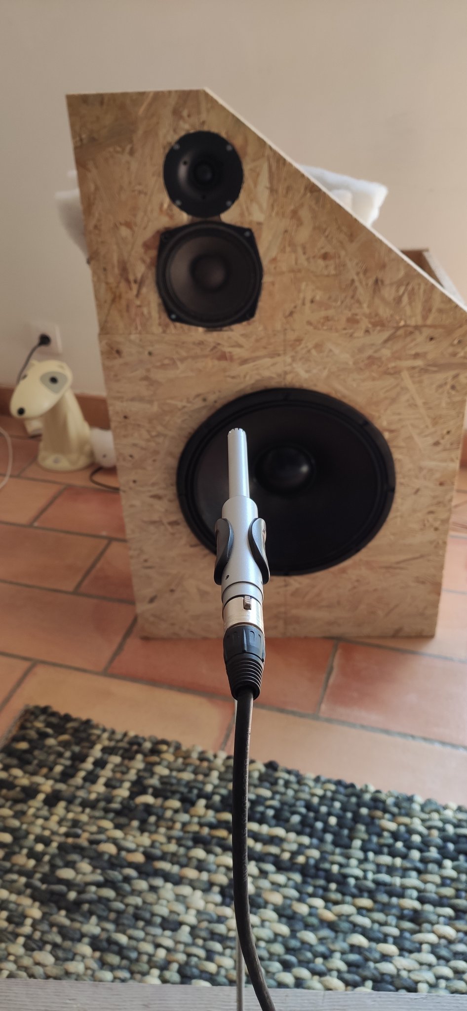

vessk0 wrote:
My baffle is almost 125cm wide (including the wings) and the roll-off of my Supravox 165GMF is happening at 200Hz.
Measured nearfield as a full range with no XO:
Sorry, but nearfield measurement doesn't tell anything about open baffle effect. With baffle that wide, mic distance should be roughly 2m.
Open baffles should also have more free space around to let the backside wavefront to meet frontside.
http://gainphile.blogspot.com/2011/01/measuring-open-baffle-loudspeakers.html
With everything said this morning I reduced my baffle in a smaller linkwith like shape.
Nice results so far.
I understand what you are saying that rear wave matters. Otherwise we would go sealed and that's it...
But then questions are asked :
-how do you know good placement?
-do you treat rear wall with absorbant, diffraction panels...?
Regards Greg

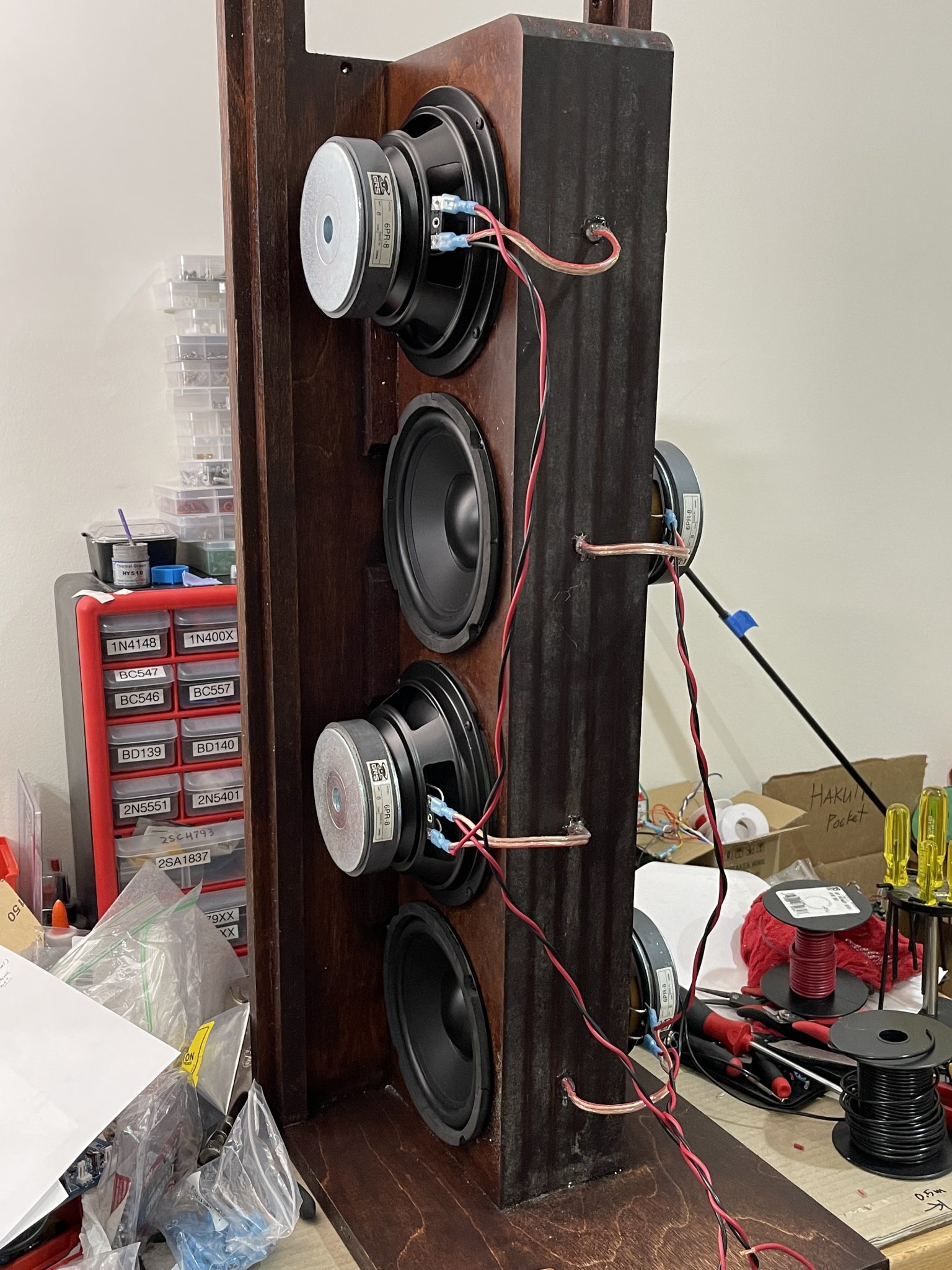

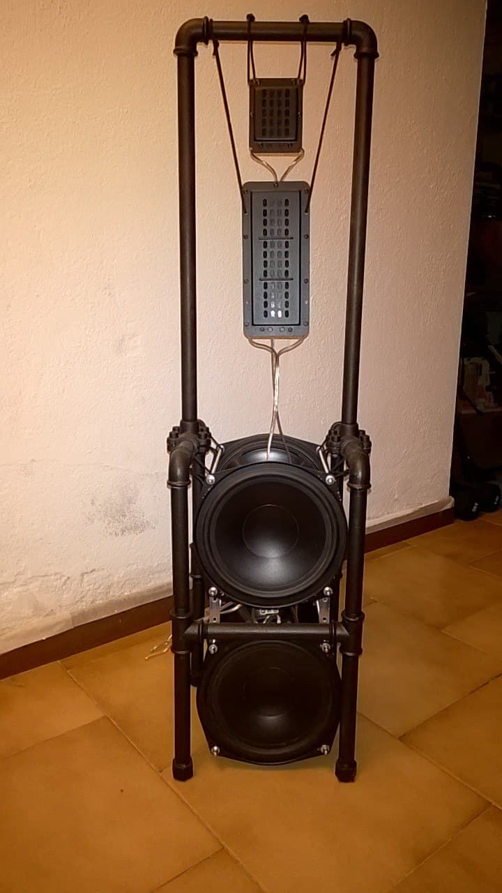

I've made a similir system, but with alpair 6P and 2 and then 4 visaton woofers WS 20 crossed at about 500Hz, but the 6P was too small to manage the power required for decent level without baffle and lack high frequency. Also the WS20 as no good power handling for low frequency, too much distortion, as so I've decide to invest for a definitive woofer (AE 15") and mid-tweeter (neo 8 and neo 3)...
Following an intermediate experiment with 4 visaton in quadrupole configuration:
so steampunk!
