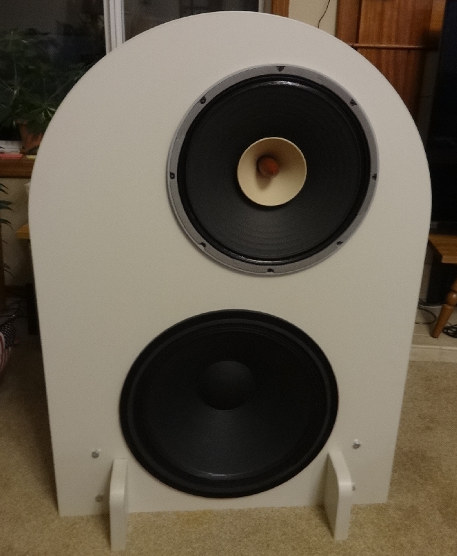

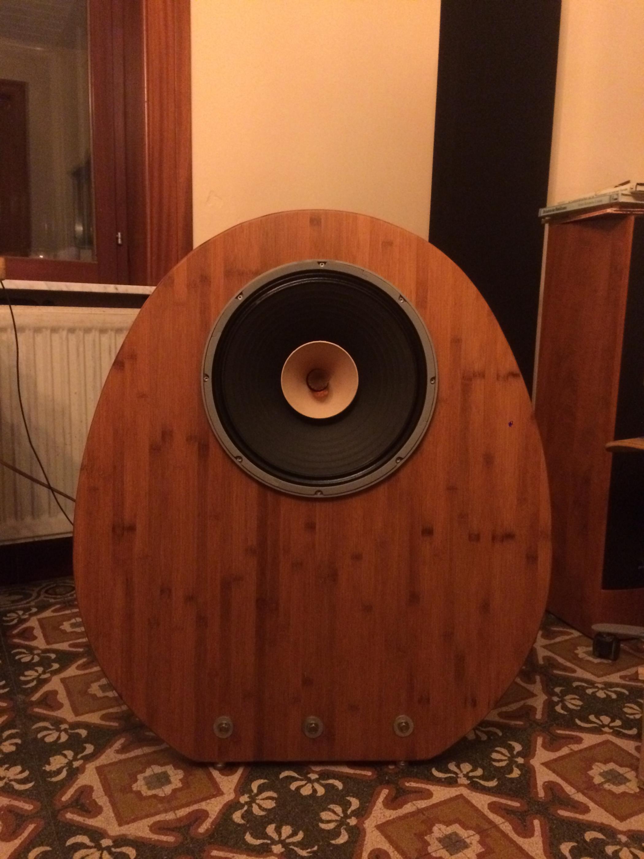

Nice! Here's mine -
How do you like their sound? I put mine asymmetrically, as you can see. The other one is a mirror image.

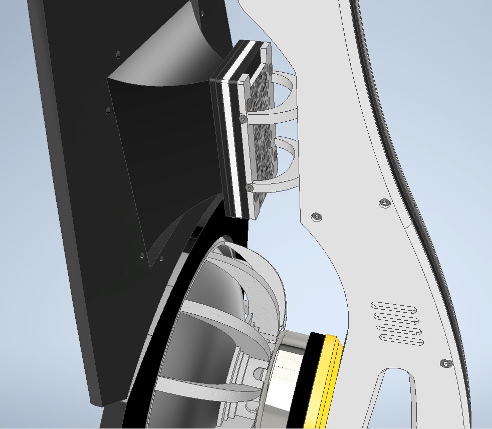

Thanks for the kind words. I'm a newbie though!
Nice cad ability, BTW!!
Something to keep in mind: the TPL magnet is pretty strong and leavig the back simply open might expose the "membrane" to someone inadvertently moving a steel piece near the magnet...which could lead to destroyed membrane. That would be me working with a screwdriver nearby, or a loose screw...hence I built the back protection to keep myself far away during experimentation. Maybe your are more careful than I am!

Nice! Here's mine -
Hey Joe,
I've been reading up on your journey with these. It seems you're where I want to go (similar baffles + bass support).
They sound very promising, but no cigar (yet): I expected a much lower f3 in these baffles (based on the statements on the decware forum). Meanwhile I'm at around 75 hours break-in and building subwoofers to fill in the low end, which should get tonal balance right. They're too bright now, even with a good boost at 100hz...
Do you feel they have sufficient output at 100-200hz in your baffles (btw are the extenders at the back still in place?), and are they smooth enough higher up without RC circuit or other EQ? Curious what to expect after more break-in.

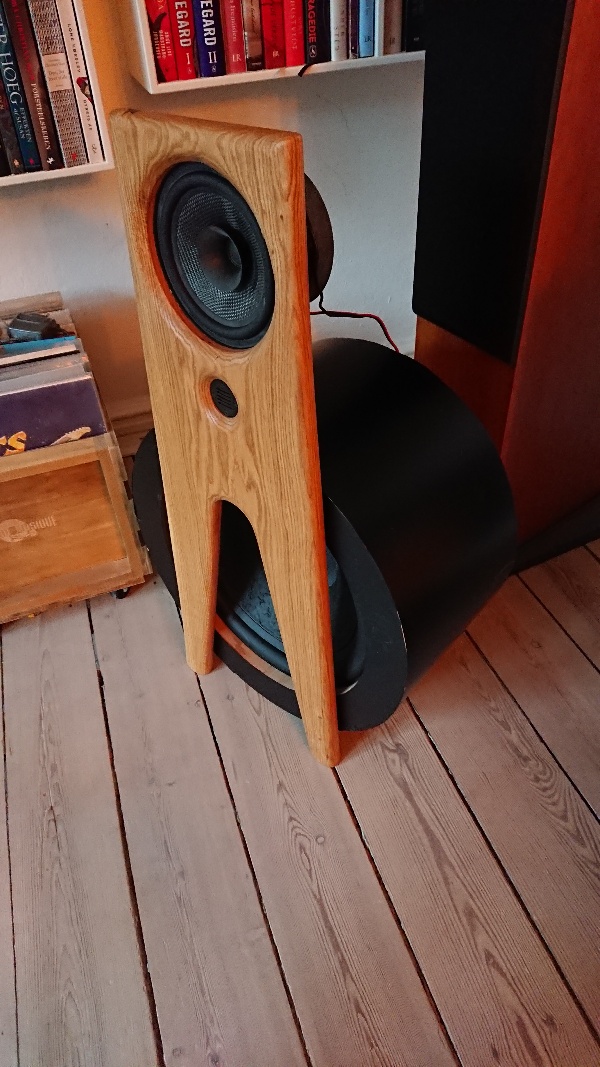

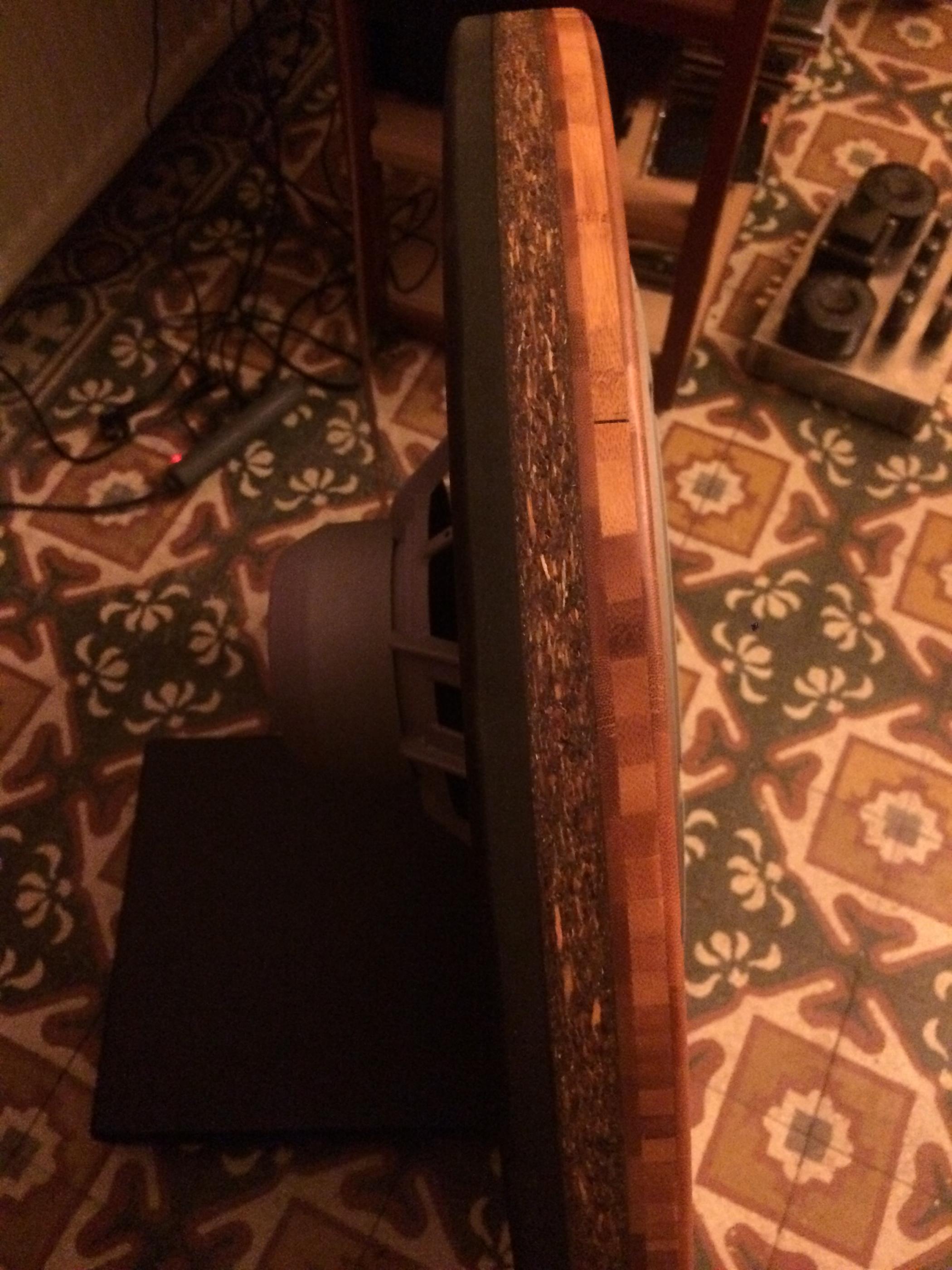

I use around 200 Hz to 7 inch, the 15 inch does not sound very nice above this frequency. Some boost needed but its ok.
Thanks. Yes, its massive oak made out of one piece.
Barrel for woofer is sliced mdf. This is not the best material. Its not heavy enough so I might need some concrete tubes instead.
Nice piece of wood, I thought so.
I made concrete tubes once...what a pain.
I've been working a lot with epoxy lately. More expensive build, but you could get very creative with it. Just something to think about. You'll never have to worry about it cracking or rattling, seals super tight obviously, well damped, could be clear, colored, translucent, mixed with wood or whatever you like embedded in it. Casting epoxy takes shapes much better than concrete, and is easier to work with when finishing.
Also lets me use wood that I would have thrown away before, because of cracks or spalted wood that's a bit too rotten and I would not have dared to turn on the lathe. I just embed them in epoxy now, and turn them into a solid shape of whatever thickness I want without fear.
And the wood is not going to shrink, warp or move one bit after it's embedded. Very rugged, beautiful and if someone did happen to accidentally hit it with an axe and take a chip out you could easily fix it too lol
I don't intend to create my own concrete tubes. I can get standard tubes in the needed diameter and depth. They cost 30-50 dollars and weigh 40 kg.

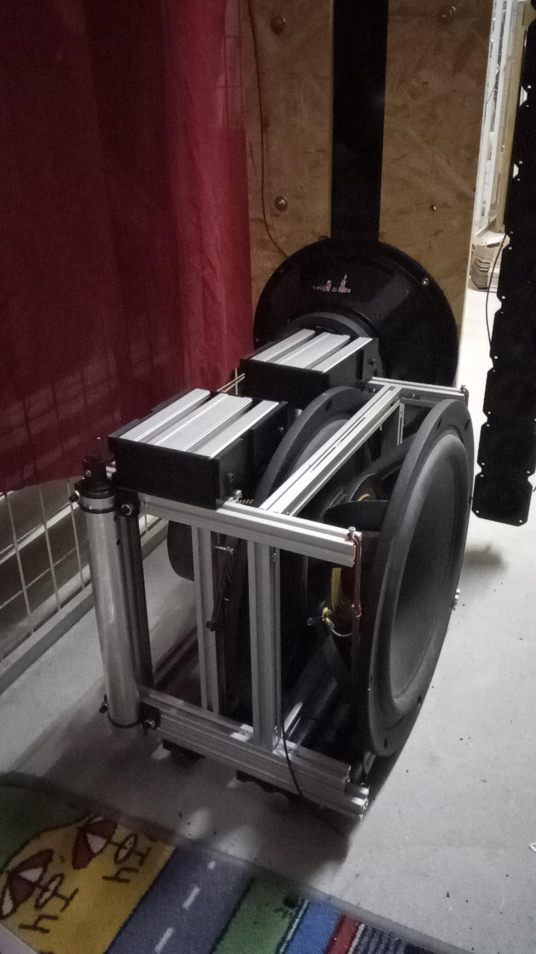

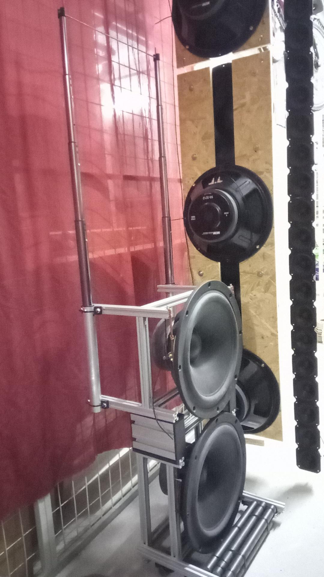

Let me show my Frankenstein project. I like dipole speakers with naked drivers (or minimal baffle). These are an attempt to make a speaker that can be stored away when not in use. "folded" it measures about 380mm high, 350mm wide and 280mm deep (this can go below a coffee table).
It can unfold with the woofers on top of each other (6dB gain), or keep them in the compound dipole. The woofers are the SB34NRX75-16, which indeed produce a lot of SPL at least enough for me.
On the top frame I attached two telescopic rails (taken from hand luggage trollys, who travels these days anyways...) that extend to max 90cm. Not very strong, but sufficient to hang one's favorite speaker combination for mid high. The telescopic rails can slide in the alu rails, to allow for offset between mid high and woofers.
Currently not in use as I am working on permanent line arrays in the living room, still keeping the frankensteins if I ever want to test some different drivers.
