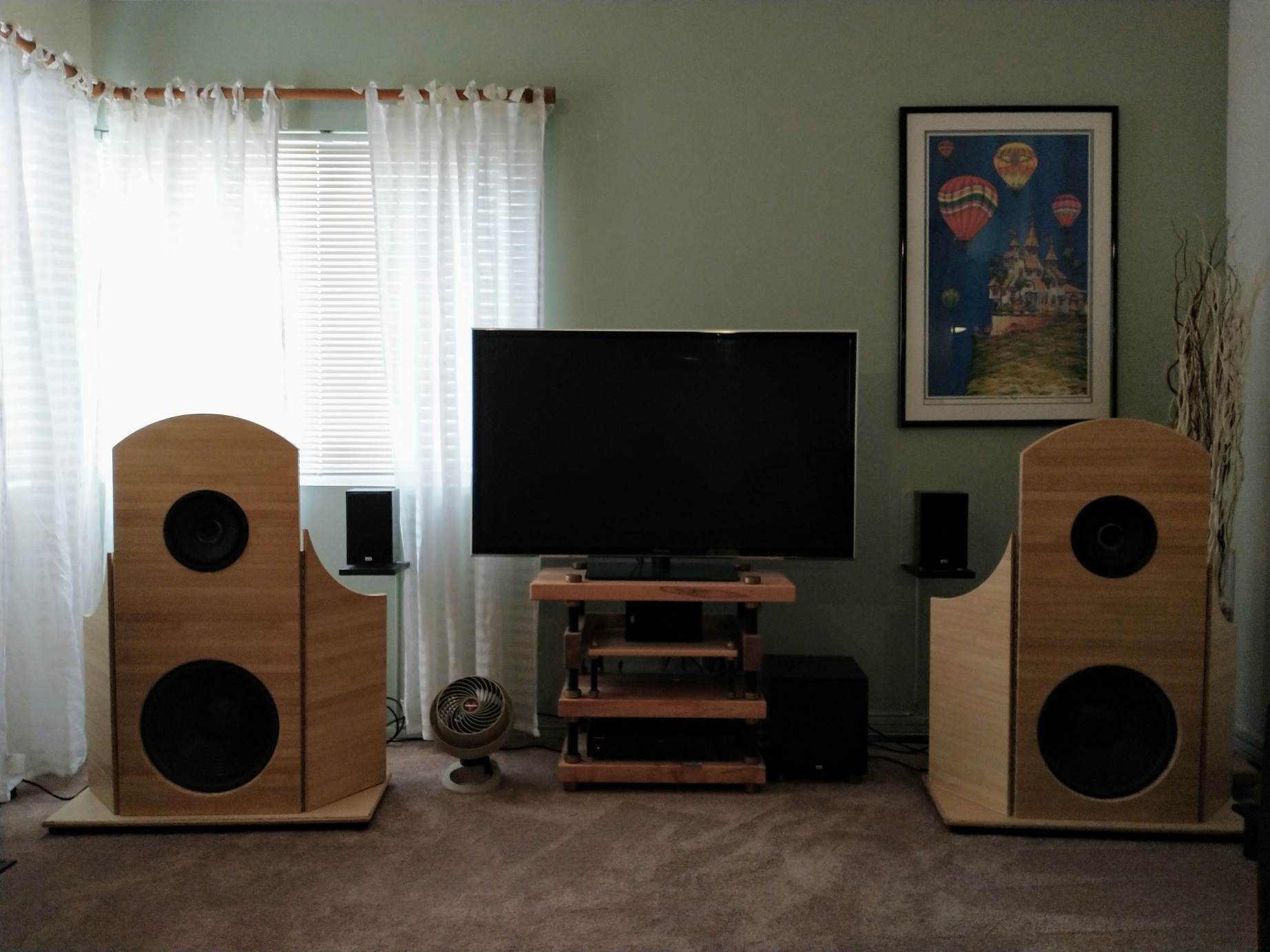

This is an open baffle I did a few years back. Made from Maple, Pine and Cherry I logged and milled. Pine had some nice spalting in it.
Drivers are Scan 10F 4424 and 22W 4535 up top, and Dayton PA 380-8 on the bottom. The base of the speaker is a 1.5" thick slab of Maple, and there are 3 channels of amplification and a mini-dsp 2x4HD mounted on top of it behind each speaker.
Not sure how much they weigh, but I'm sure it's a lot. Had to use the tractor bucket to lift them up on a stand outside to measure them. I'll try to dig up the measurements and add them later. It was hard to let these go out the door, but there's always something else that needs to be tried.

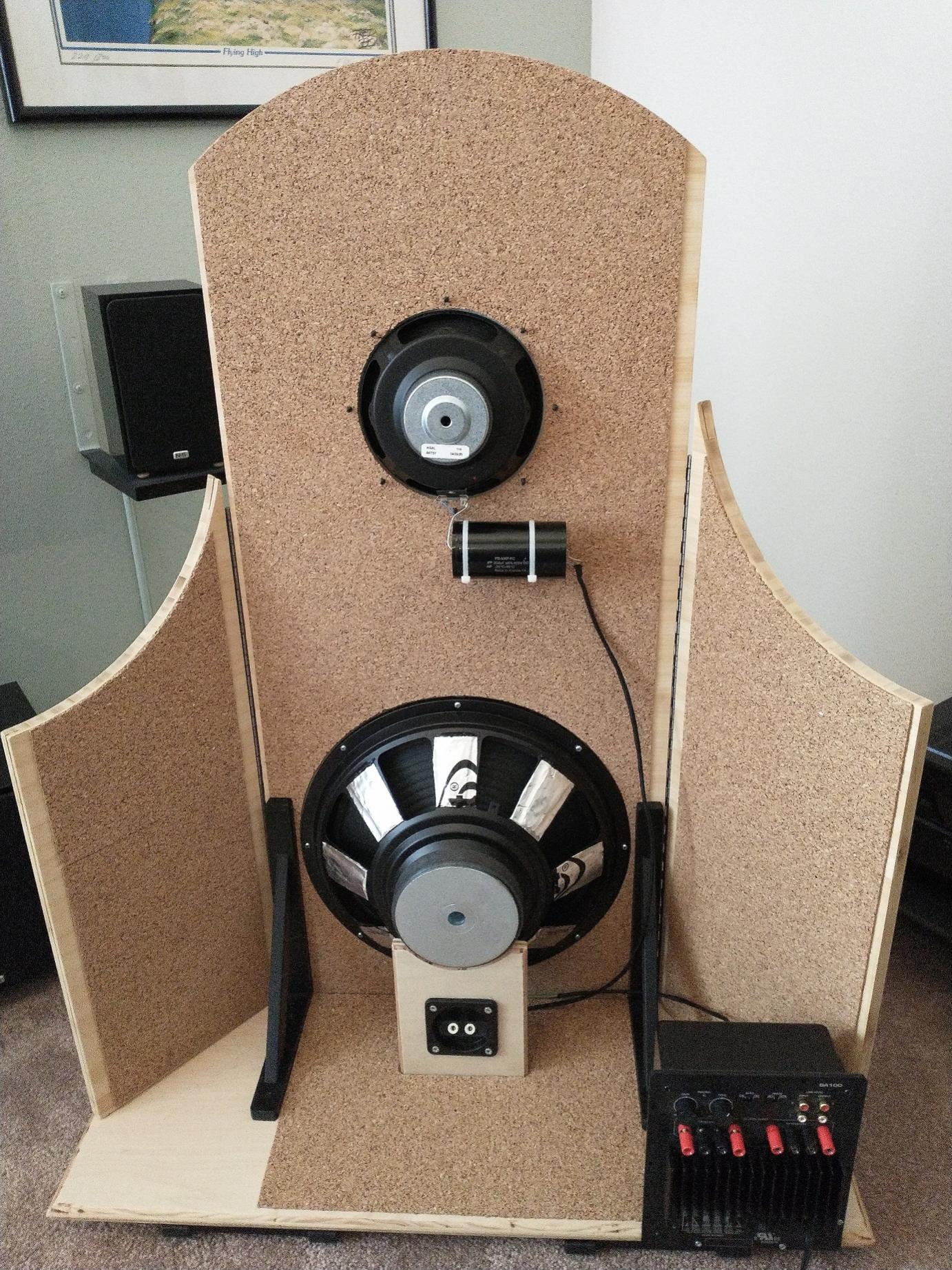

My OB journey began with a pair of Tekton OB4.5s that I still love.
Wanting a diy OB project, I started with a pair of Betsy 8" drivers and a 3/4 thick sheet of Plyboo cut to the Wild Burro specs. Augmented with a pair of subs, they sounded fine but completely owned our condo's living room.
I moved the Betsy drivers to the 18" wide baffle, added a pair of GRS 15PF-8 woofers and cut the wings down. (Admittedly they're still pretty large.)
A 200uf cap keeps the full-rangers from working too hard and the woofers are each driven by a 100w plate amp.
They don't pull off the disappearing act like the Tekton's, but I like what I'm hearing. What they give up on the top they make up for with the ability to rock a bit harder.

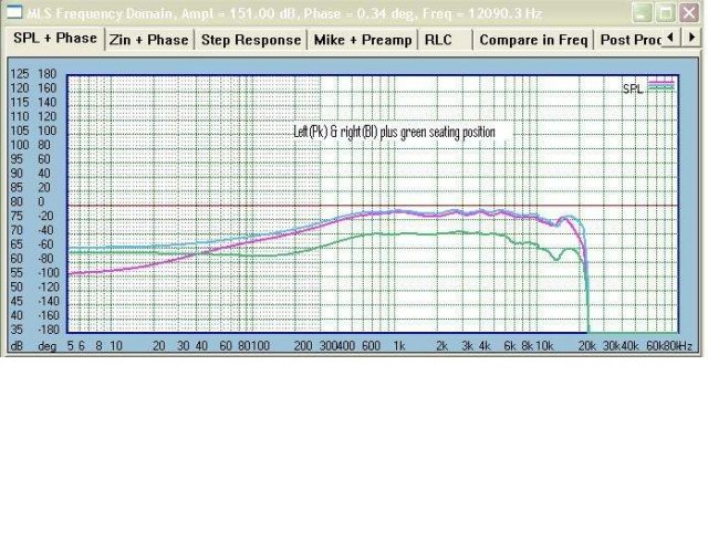

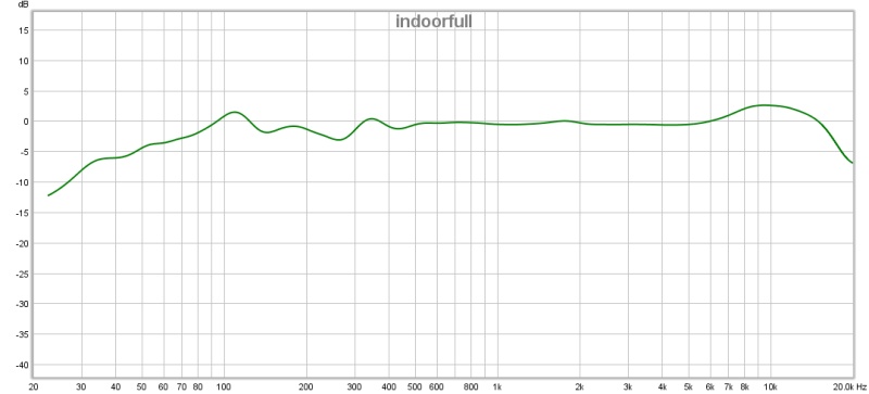

I managed to find a measurement I took inside the shop. My shop is 54' x 30' with just under 10' ceiling, so no room gain here.
1/3 octave smoothing with 500ms window, so all the room reflections are in there.

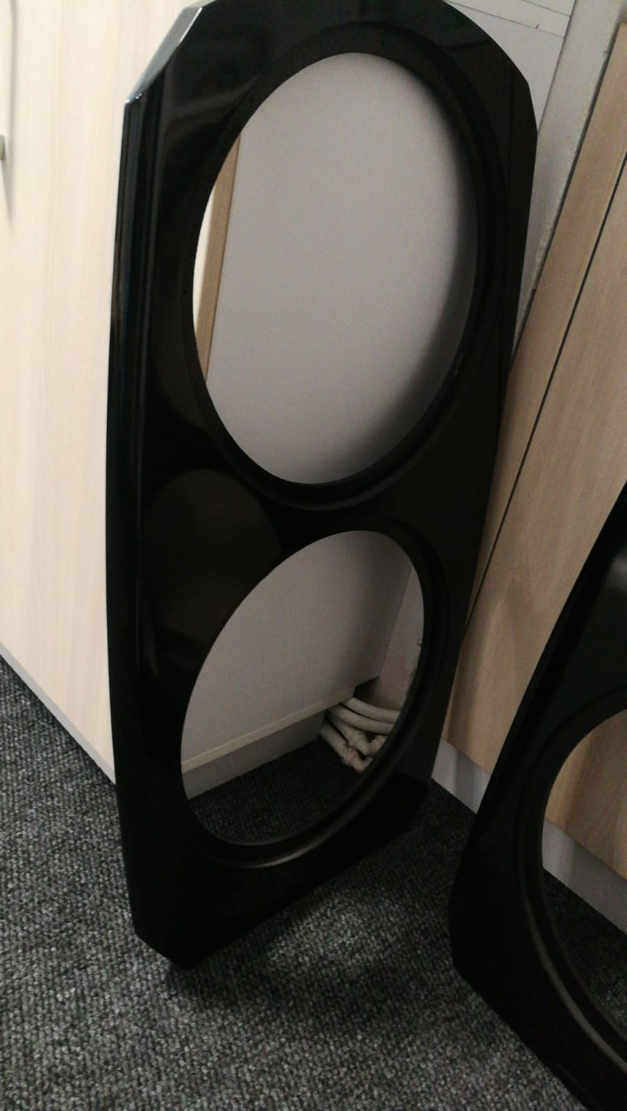

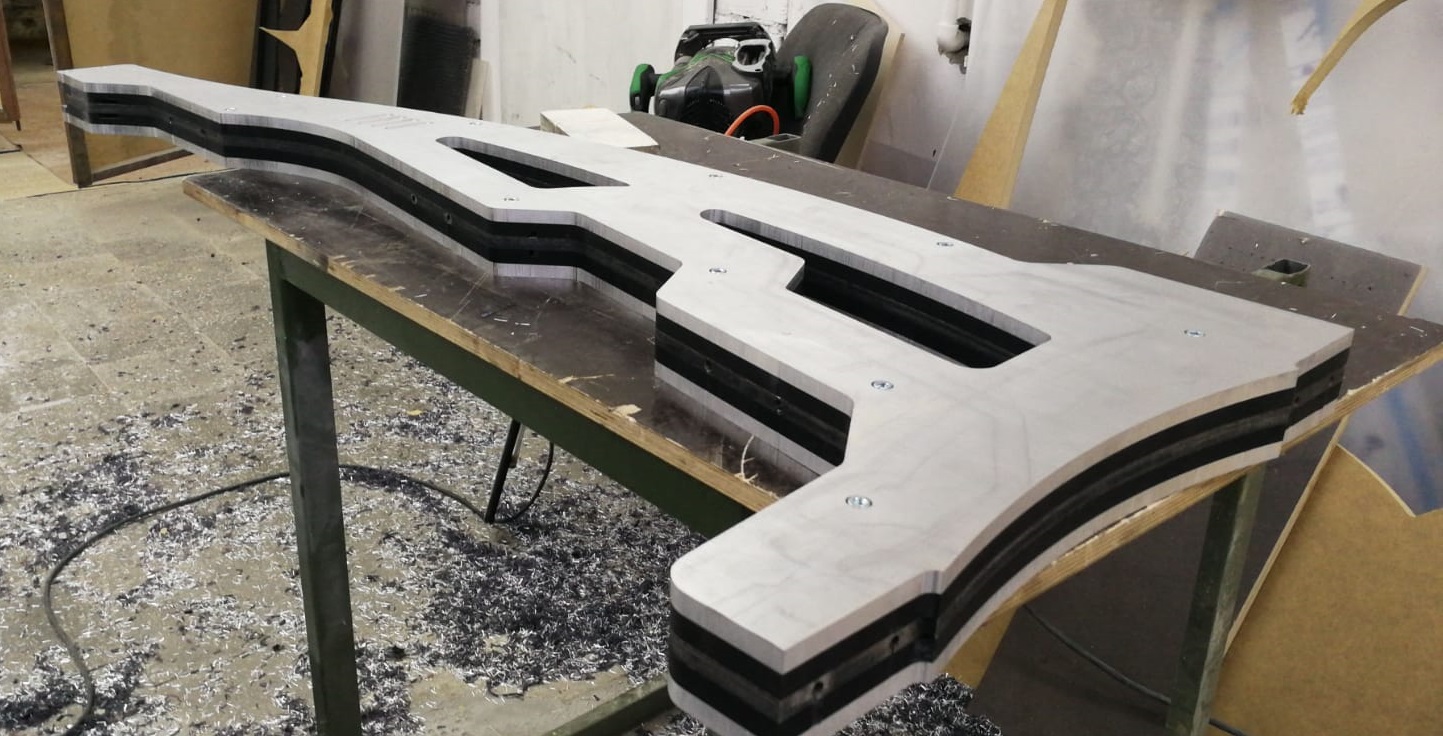

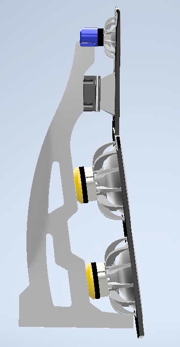

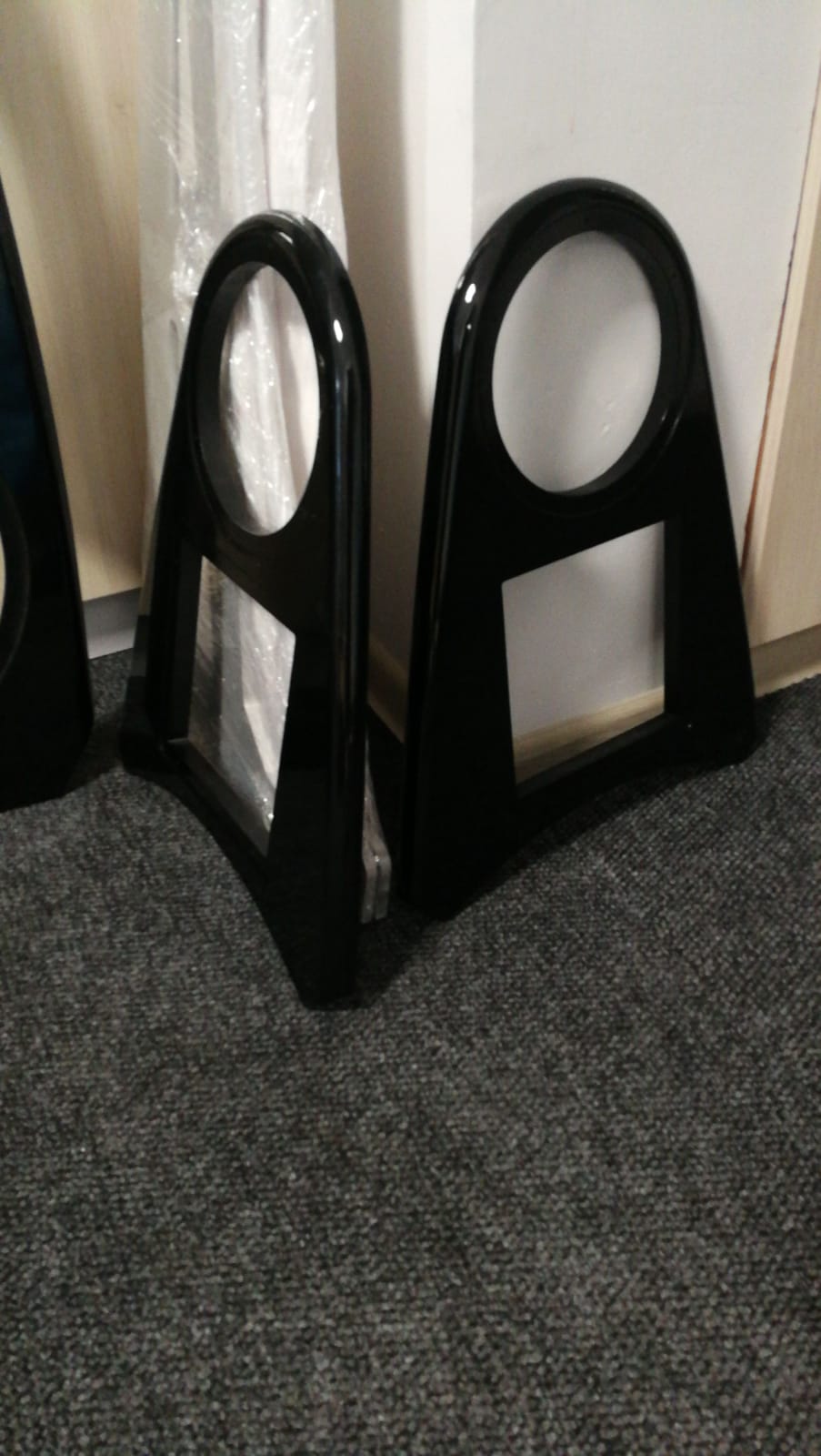

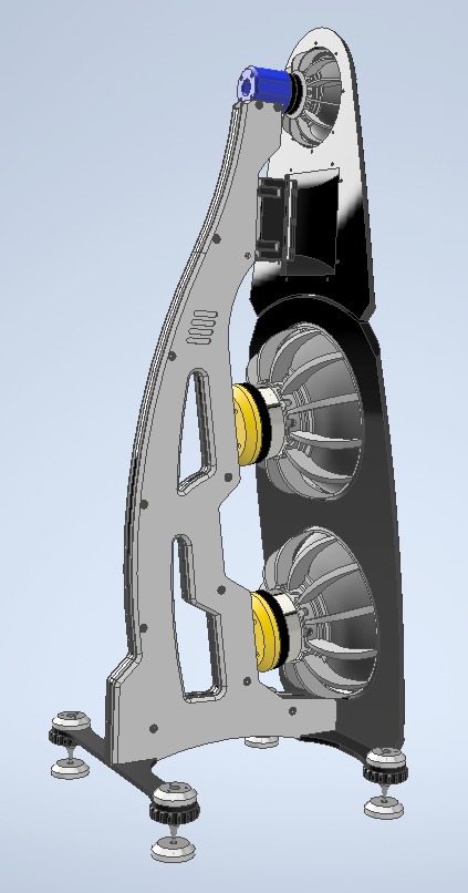

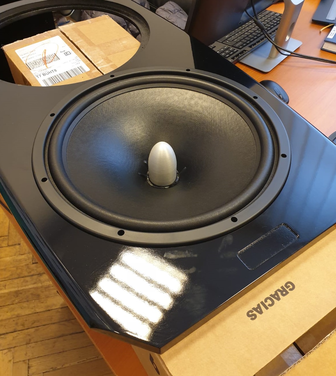

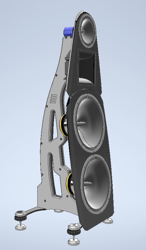

Open Baffle AE15
6 years ago I had my first Open Baffle project with 2x Alpha15 + Supravox + Fostex. I was very impressed (especially the bass)
After that I left with the Troels Gravesen projects and now I have Jensen Accu (Jenzen-Accu)
But after buying an 8-channel DAC8PRo, I decided to go back to Open Baffle. I read a lot and in the end I decided to go for the AE and Beyma speakers: 2x AE15 Dipol + TD8M + TPL200 / H The speakers have been bought and the process has begun 🙂
My friend Gen is very helpful to me in this whole process. So far I have managed to cut the boards, the rest - follow 🙂

Very nice vitalica, I like the design. What method will you use to attach the frame to the magnets?

Before the speakers I posted above left my shop, I had a couple friends over listening to them. One of them asked me to play Hells Bells by AC/DC, which is not the type of music I normally listen to and had not heard in many years, so I pulled it up and cranked it up for him.
The look on their faces was priceless, and no doubt I was making one too. The crystal clear sound and apparent size of that bell in such a large room was really something to hear.
It was one of those moments when, by the time the intro was done and both guitars came in, you realize you have never really heard the song before then.

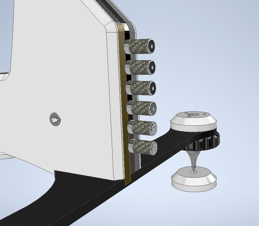

The AE speakers will be fixed to the rear frame through the existing thread through the AE15 and TD8M magnet.

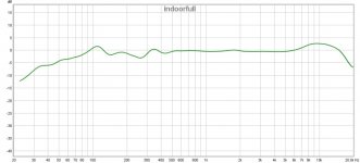

Very nice!! Nice AE drivers!
Not sure what your plans are regarding the TPL-200, but would encourage you to try them open-back. I have TPL-150H and tried them in an dipole speaker with factory back cover, open back, and open and with a rough prototype of a waveguide in the back. Here's my thread with measurements done outside 180° with back waveguide: post #120.
It was explained to me dipole behavior up to about 6kHz is important. This approach achieves that and most importantly I like it better too. It's a cheap experiment with with a foam waveguide.
Another thought, since you will be grabbing the woofers from the thread in the back: consider having a 1-2mm gap between woofer frame and panel to avoid the woofer getting the panel to vibrate. Allows for a much simpler panel construction and avoids vibrations. It was suggested to me and thought it made sense, although for the time being I'm going baffleless.
