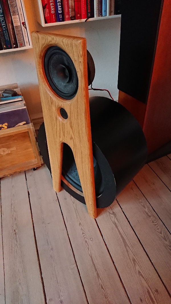

My Bastanis in a new baffle.
Very nice!
May we see what's behind the baffle? 🙂
