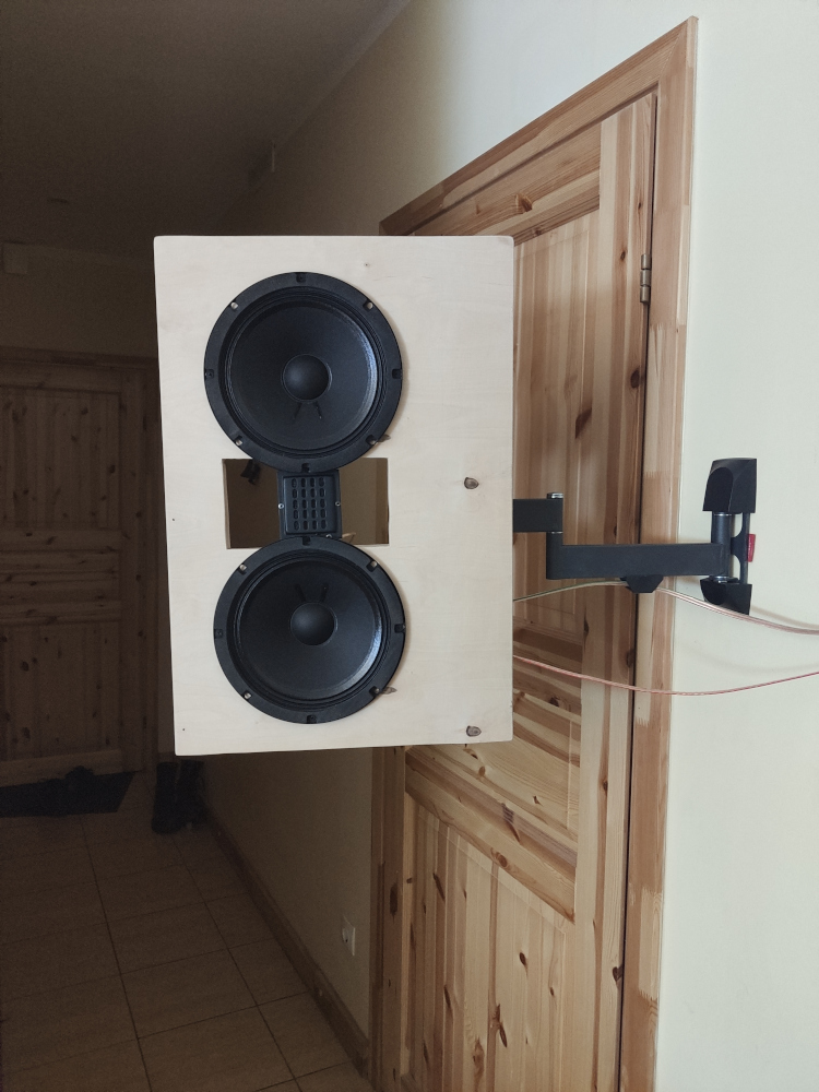

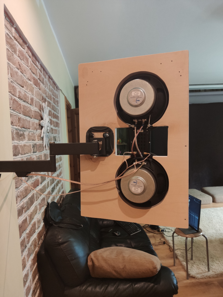

Open baffle surrounds
My open baffle surrounds.
Drivers:
Faital Pro 8FE200 - 80-3000hz
BG NEO3 - from 3000hz
About 9db boost at low end was needed for Faitals.
Amplifier: Primare A30.5
Audio interface for digital-analog processing: Allen & Heath ICE-16
DSP processing - JRiver
Drivers:

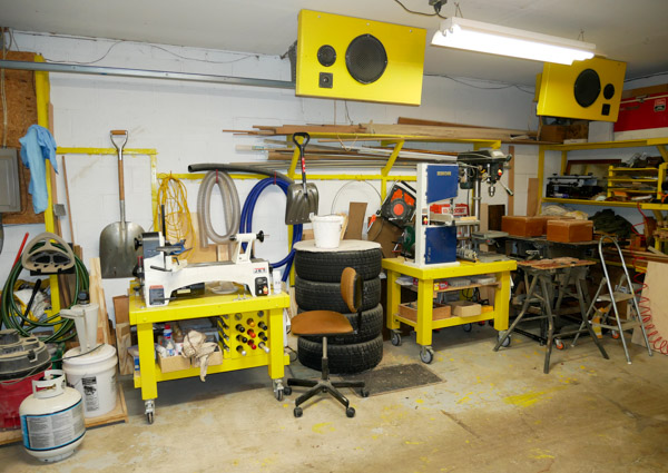

I had an old set of 12” three-way speakers. I came across an article about open baffle speakers and decided I try it (I’m glad I did). I wanted to upgrade the speakers in my garage and I had no space for boxes. It was an experiment that turned out better than expected. I attached them to a ceiling joist about 2-3 feet from a wall. I am impressed with the sound. The bass is natural (which means reduced bass compared to traditional speakers); with reduced bass I can play a higher volume without disturbing the neighbors (I checked). They sound best when the garage door is closed, the entire room is the speaker box. I recycled an 8 inch 2-way set to make open baffle speakers for the opposite wall. I hear all speakers anywhere in my garage (I think it is called soundstage). I am very happy with the open baffle speaker system.

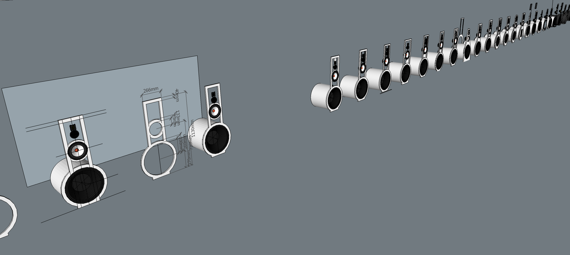

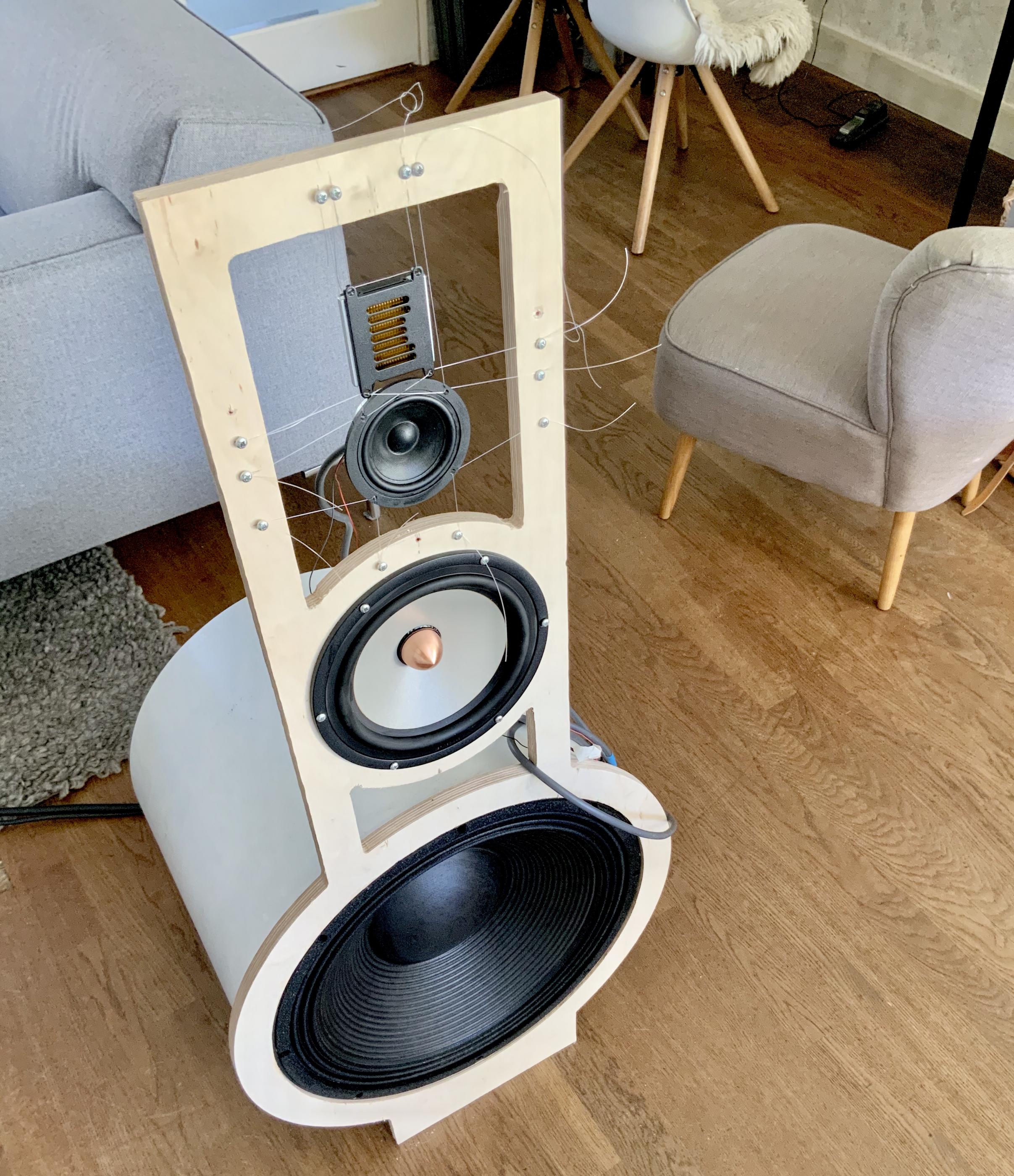

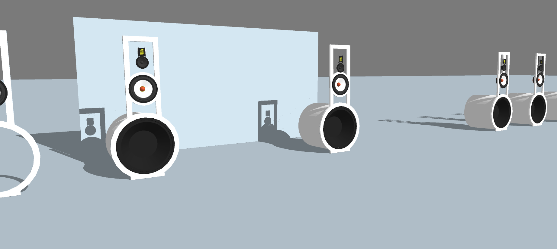

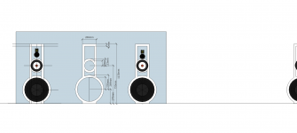

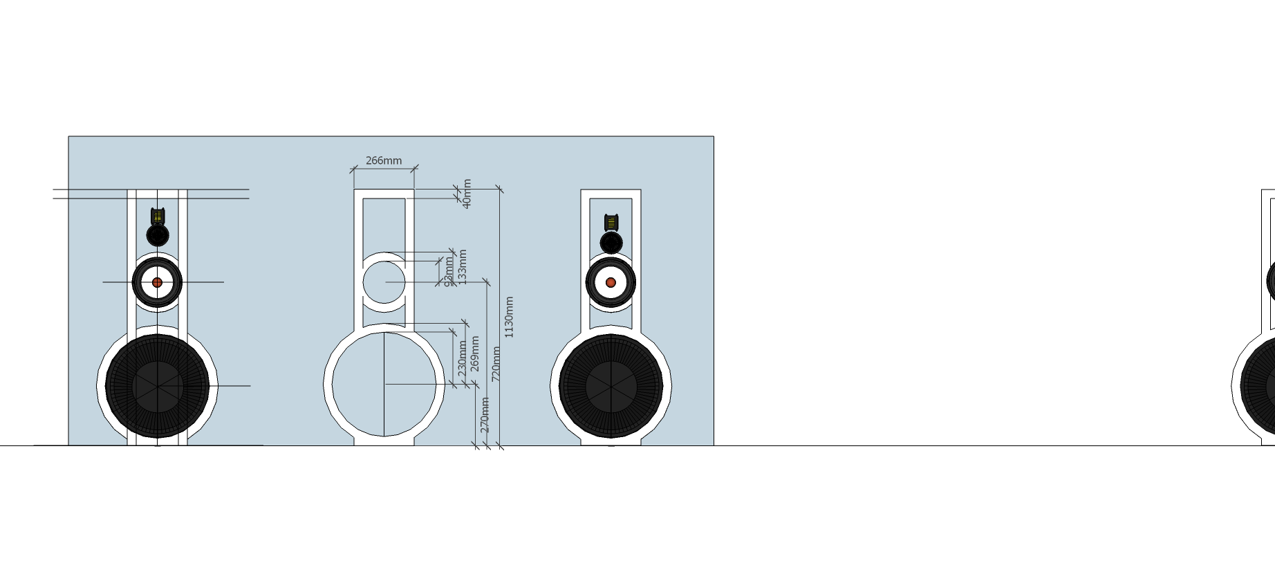

OBSP
OBSP open-baffle-speaker-project - forum.zelfbouwaudio.nl
B&C 18SW115-8
Seas Excel W22
Scanspeak 10F-4424G00
Mundorf 17D2.2
temporary Inuke 6000 dsp for lows
minidsp OpenDRC-DA8
UCD400/180HXR
B&C 18SW115-8
Seas Excel W22
Mundorf 17D2.2
minidsp OpenDRC-DA8
UCD400/180HXR
tube is pvc pipe, but it was not round, so I made rings of mdf on both sides to make it more round and nice
crossovers are at 100, 900 and 4000 Hz
Very cool.
I considered something like this, with instead of pvc, new hardwood drum bins instead. Too expensive for me, mostly in the shipping expense.
Nice concept, losing the baffle where it counts
Thanks. I do similar approach with a DSP, but try to avoid too much eq, but I dont like voices from the woofer. I have heard very good speakers with higher crossover point, but I simply can't make I work.
