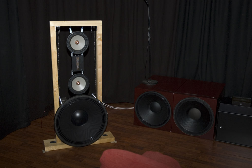

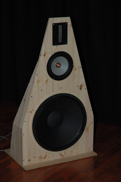

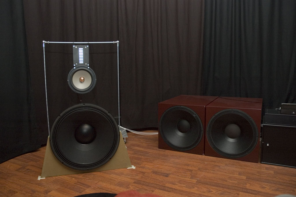

Speaker on a Swing
Stig Erik Tangen,
the designer of the "Almighty Subwoofers" and other impressive projects has undertaken a great trip into swingin' speakers
Read the full story here:
http://www.diyaudio.com/forums/multi-way/142015-my-open-baffle-dipole-beyma-tpl-150-a.html
😀 Michael
Stig Erik Tangen,
😀 Michael

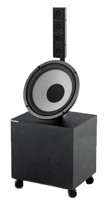

Almost bought a pair in need of a refurbishing. Opted out since I couldnt find any info on the drivers etc (at least not in the time I had to make the decision)
The Gradient 1.3 Revisited
amt
