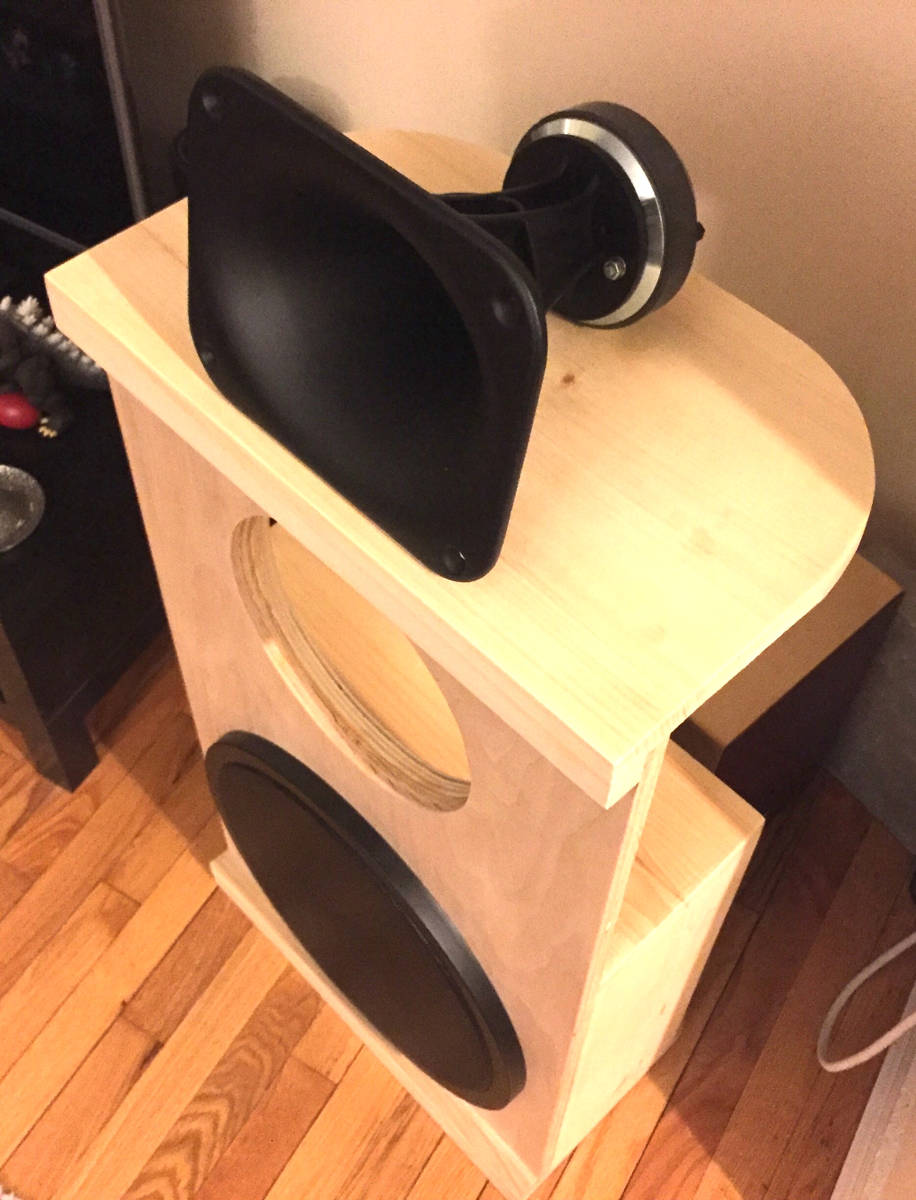

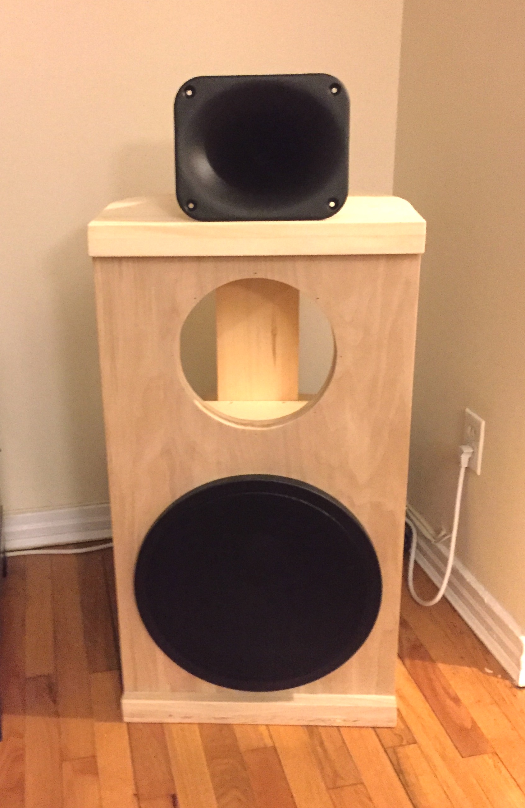

Thanks for the suggestion felixx! I wonder if most/all compression drivers with a voice coil diameter of 1.75" can be crossed below 1000hz? The BMS, B&C and a cheapo Pyle (among others) share this feature. Most 1" compression drivers incorporate a smaller voice coil diameter.
Indeed,but maybe you can push the "hemp" a little bit to 1,5 khz.... Also check the waveguide,but in the end you need to experiment live,with all together.
BMS as the B&C are pro drivers and can be pushed to the extremes but you are use them to home listening and I doubt it you will push so hard on them....
1khz will be "at the edge" but I think should be fine (careful at the waveguide).

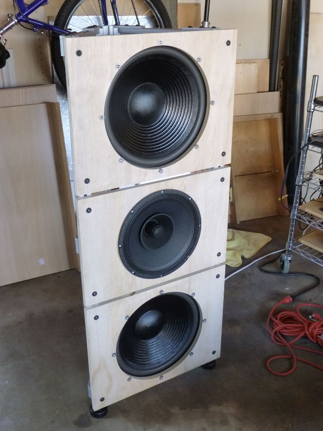

Latest reshuffling of drivers. Still using the old MCM 21" woofers (2 per panel) and new to open baffle use, the PS220-8. The opening for the woofers is 5.5" wide, giving approx 1/3rd sd opening. The fullrange is slightly blocked, but still sounds nice. No measurements, just enjoying listening.
