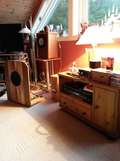

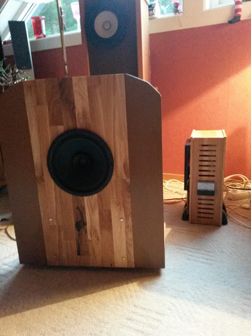

Hello Xerxes,
I use the coax out of the RM765, named 16x01R with the original crossover and two Chassis named 300F05 for one baffle. The 300F05 are housed in an 200mm deep U Frame, goind down to 50Hz till they drop down with 6dB/Octave. The surprise for me is how dry the bass comes over, without room resonace. The next step is the fine tuning using a DSP.

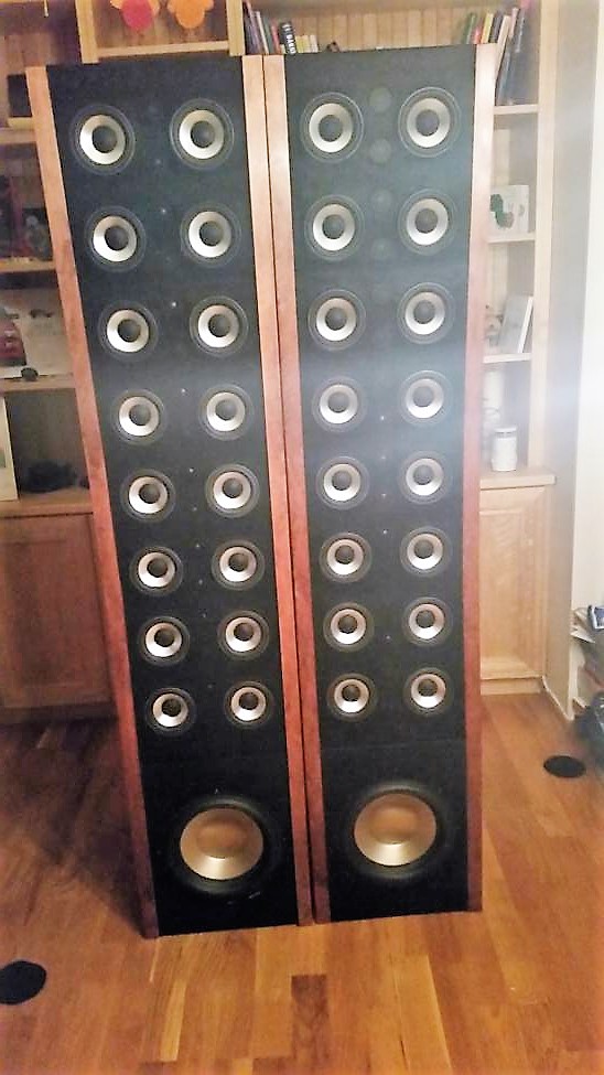

The ongoing saga of my new open baffle woofer arrays plus diy planar magnetic towers has been moved to the planar and exotics forum. I thought I'd toss a photo in this thread as well since I drew so much inspiration from the projects that others have posted here.

Rewind: I made ESLs for my previous project. I got tired of their humidity dependent performance (something I could have fixed in another design, no doubt). I also wanted something that I could make narrower, and that therefore required a bit more excursion. Of course in the end, I mostly wanted to see if I could make a decent planar magnetic speaker.

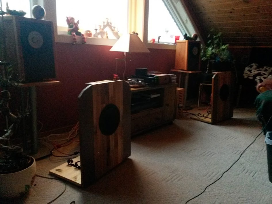

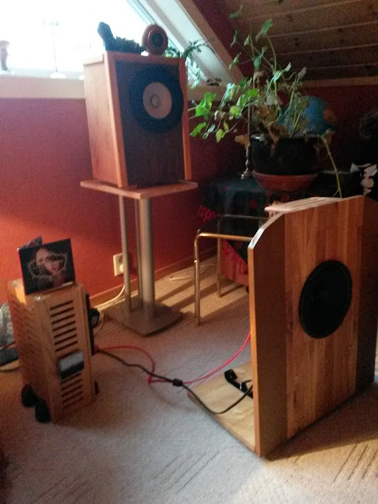

First try on OB...
Hi all.....
As a fullrange user and partly builder of audio systems I have been interested in OB-builds for some time, and took the chance 1 month ago to get me some Betsy 8 inch drivers to try out.
And the result is amazing - clear and enveloping sound that is more musical than my BR Alpair12P. The Alpairs is more HiFi with a clever, distinct lightning sound. But the Betsy is more easy and good to my musical ears(mind). They both give a 3D organic sound.
My Audio SetUp is: Sony SaCd player - A homemade Metrum Transient DAC - A homemade Luminaria (SIT classA) preAmp - Mono LÀmp (Resistorversion with SIT transistor).
Now I maybe have to find some OB woofer? to get more punch in the lower reals. Maybe - but not realy needed. Time, work and health must decide....
