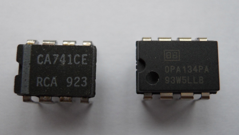

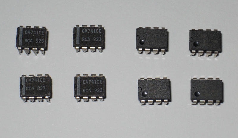

And these are the actual devices in the quick 741 vs OPA134. Offered these as a choice for a new preamp or to replace some chips in some audio gear you wouldn't think twice... would you 😛 The OPA's are really hard to photograph for some reason.

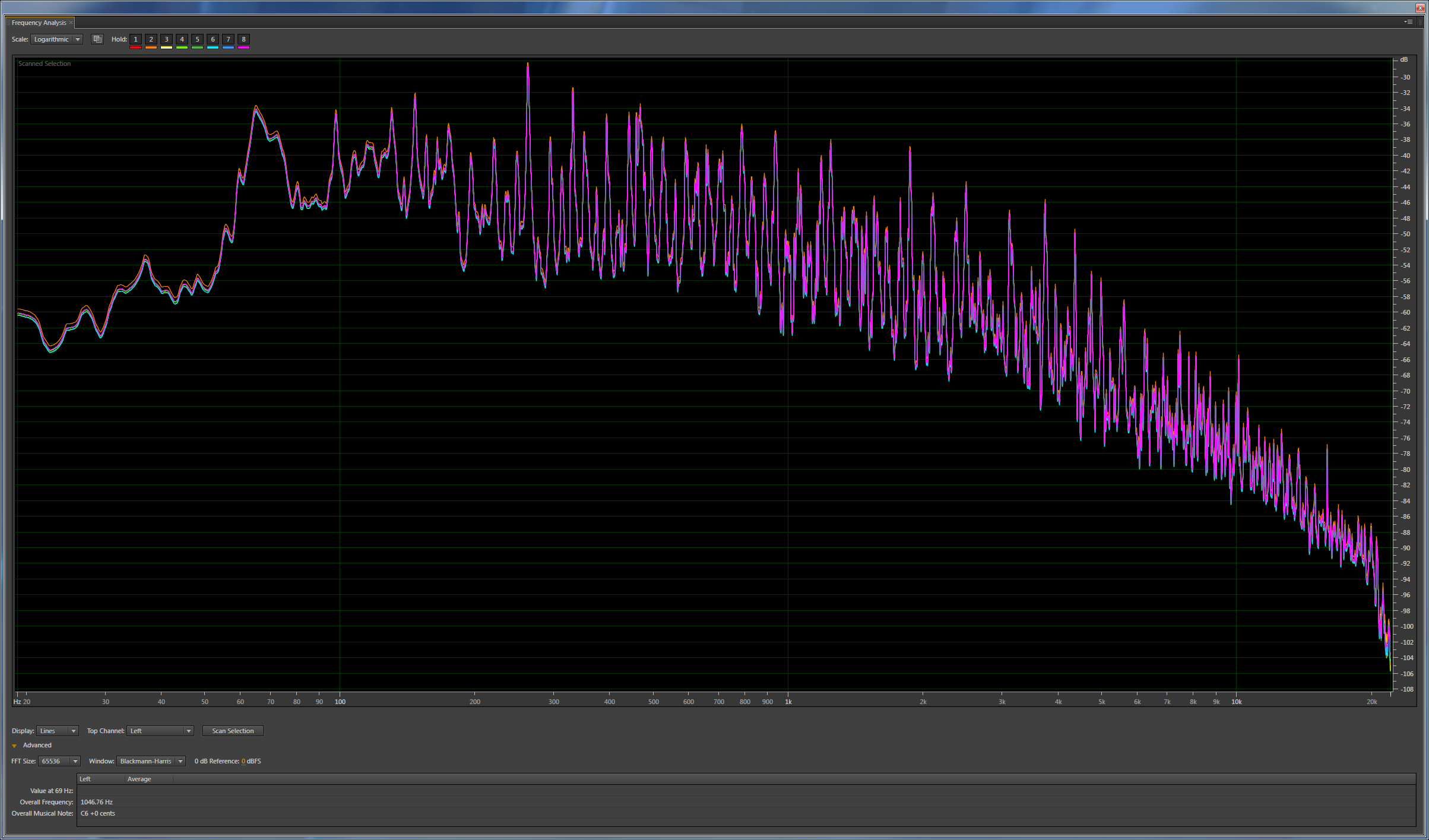

I was hoping to at least pick out the 741, but after trying an ABX test in foobar2k, I couldn't reliably tell any of them apart (there should have been a "can't tell" option!).
In the interests of science, I then tried to "cheat" by comparing FFTs of them all, and noticed that one is 0.5dB louder than the others, which is presumably the original (I know I'm not the first to notice, but I deliberately didn't read the thread until after I had done this). This is enough difference that I'm sure those with more sensitive ears than mine could hear it. You can see this in the first attached screenshot. There are smaller differences between the others, with the lowest one probably being the 741. I won't say which trace is which file, to avoid biasing anyone.

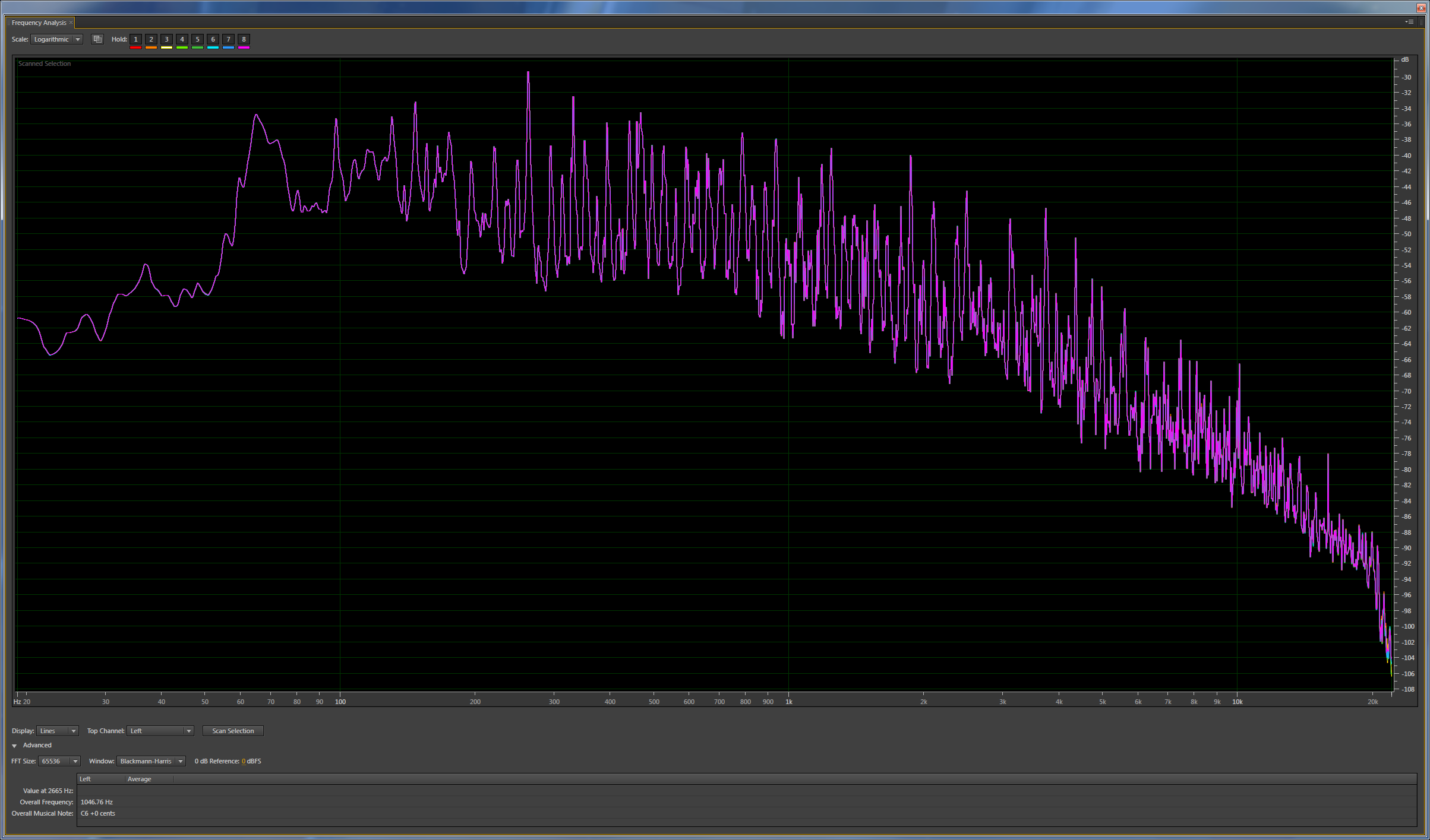

In the second screenshot I normalized all the files to the same value (-18dB RMS). Now the traces nearly overlap exactly. I expect that if I had taken the time to align the files so they started at exactly the same point, and were exactly the same length, and there was no clipping, then the difference would be even less.

Your right... how on earth did that happen. I've obviously screwed up either the input to the test circuit or the output going into the laptop on "orange".
And here's me thinking it was deliberate! That's why I posted the crytic comment earlier on - thought Mooly was trying one on ... 🙂
Picked it up when looking at the overall waveforms in Audacity ...
