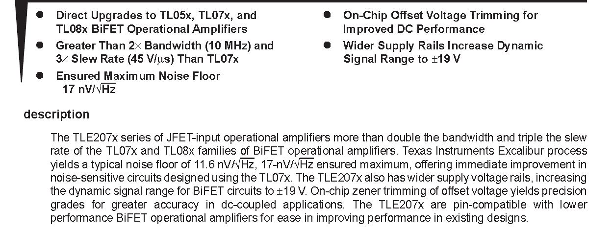

From your tone I take it that you have taken measures in ensuring the latest offering (TLE2072 with SR of 45V/us) is stable in the circuit.
So, when there is no design "mistake", I believe I could prefer the TLE (even tho I have never heard it). It may stand out in sonic, or it may stand out in distortion (like most non musical expensive opamps).
It is not easy to stand out in both sonic and distortion, so I believe TLE will stand out in distortion. WAIT! There is one file is very close to the "original". The location of the file is not far from Peach and as of now it gets zero or one vote 🙂 I will check this file at home tonight.
The TLE2072 is quoted as being an updated and "new improved" TL072. It never seemed to become favourite in the way the original TLO's did at the time.

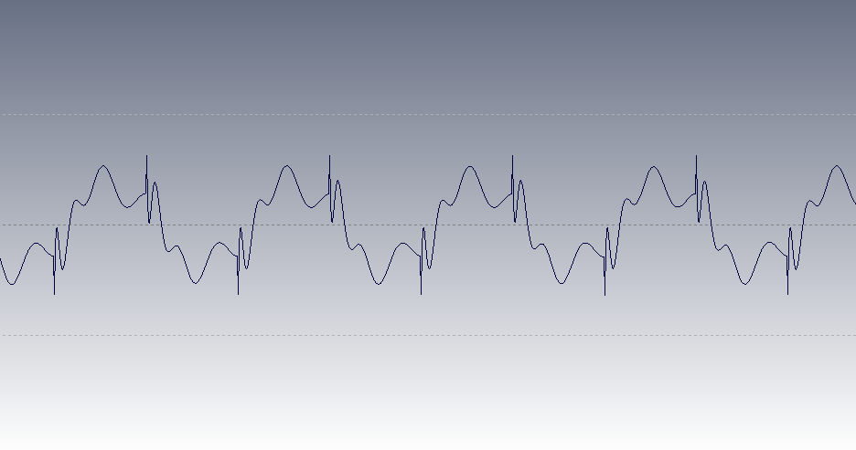

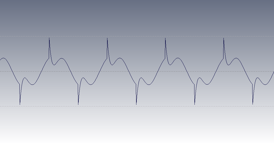

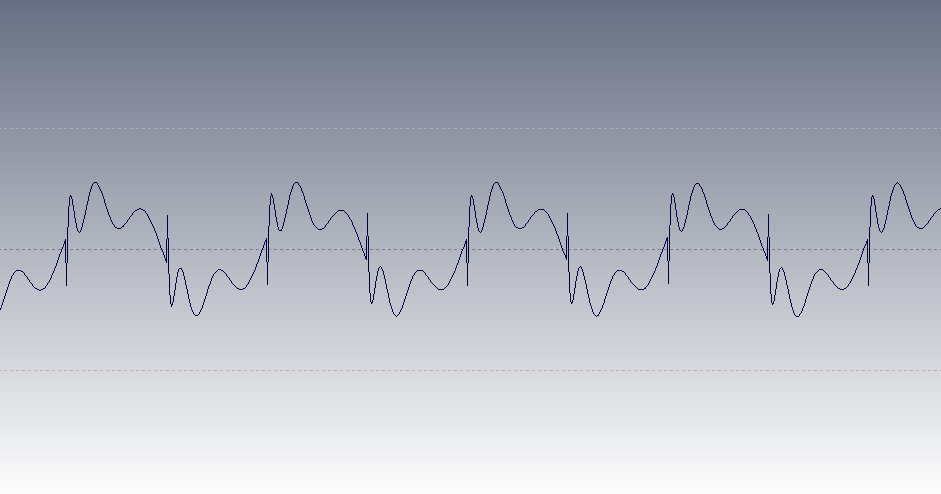

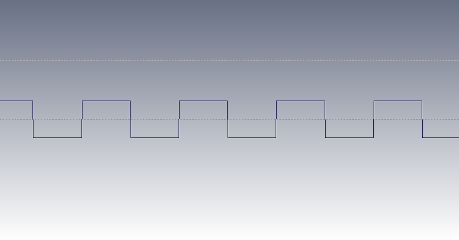

It's not good practice to visually determine the difference of audio files. Wave shapes can look very different but still sound exactly the same.
I have made some examples so people can experience this for themselves.
The sound files can be uploaded here: Zippyshare.com - waves.rar
Point of topic: Never use visual clues when you want audible clues.

Indeed 🙂
Get the best headphones you can get and listen to a square vs sine wave. Once you get above a certain frequency (that is pretty low in the scheme of things) then sine vs square vs triangular all sound the same. Your age and hf hearing cut off point will determine what that frequency is.
If you sweep a square wave up in frequency, the harsh raspy tone gradually becomes smoother and smoother until you find that last trace of "audible harmonics" dissappear completely. Try it 🙂

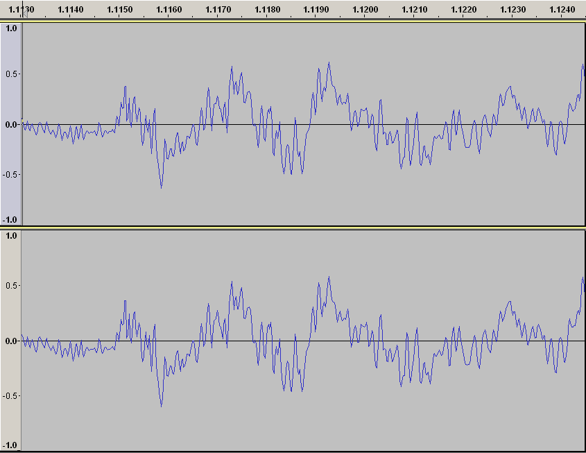

To kill 2 birds with one stone - many would regard 128bps MP3 as the pits, badly mangled sound, easy to hear the 'damage done'. Therefore, it should be easy to see that damage - in something like Audacity - there must be visual clues ...
Okay, here is a snippet of some intense drumming, solo work with cymbals going flat out, one track is the original WAV, the other is a 128bps MP3 of the same - size of the whole WAV file is 1,015KB, the MP3 is 185KB - so "severe" loss of information in the latter.
So, which is which?
The bottom one of course....
