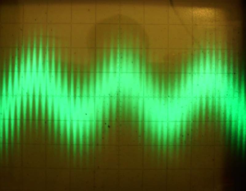

Please help..! 🙂
(I just rearranged the earth wires in my whole system.
Now every device (func.gen., PC, scope, amp) uses the main AC earth point in the
right way and when they all are connected no ground loop and hum is created...)
But I noticed at the output there is a ~450kHz wave around 15mVpp as attached.
First I thought cool, its another oscillation... but its there even after turning off the amp (and discharge the PS).
Then I looked around a bit and saw that it's already there @ the signal (RCA) GND...

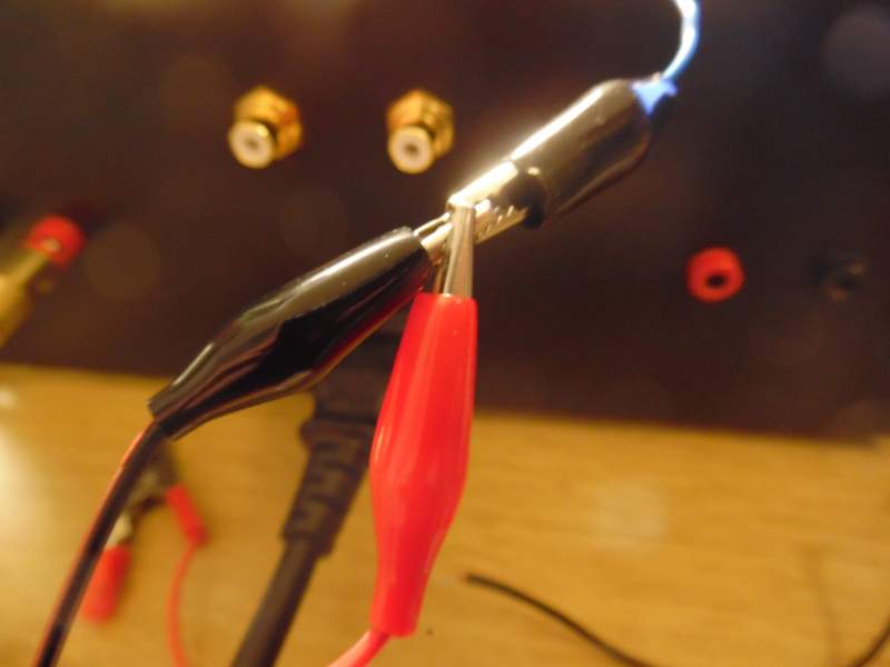

The scope's
If I increased the 10nF to 220nF the wave were eliminated at the RCA GND but at the amp output it is still there.
It is just a measurement error? The scope's GND isnt at the right position?
Then I tried to plug the scope to an un-earthed outlet but the result was the same.
And then I reduced the problem to the root (without any amp parts involved!) I guess:
I have the same and exact result when I just short my scopes wires and then I connect it to the earth of my amp as attached...
Why this is happening and how should I eliminate it. Its very frustrating to chase an oscillation when its not even a real one... 😀

- GND: is earthed so I put it on the earth point in my amp which is separate via a 10R||10nF as adviced earlyer.
- "hot wire" is at RCA GND
Fluorescent lights (tubes and compact), solder station, SMPS LED lights, SMPS anything.
All these send out interference and the bad ones send out a lot.
Go around the room and switch off everything. Maybe do the adjacent rooms as well.
I posted this one for the first time to my other thread (stability) but then I moved rather here, OS's reply there was:
You are picking up the "filth" of the 21st century.
Most likely your PC. Harmonics of cheap chinese CFL , other
cheap SMPS's can cause this RF hash , as well.
For your audio , filter across the ground loop breaker and/or
an AC input filter.
OS
New experiment: if I plug my scope and my amp to an unearthed outlet then the wave is gone...
If either of them is earthed then its appearing immediately...
Pff, yeah, it was indeed my PC... It was a bit tricky though... First I turned into sleep. Nothing....
Then I switched it of. Nothing... Then I plugged it off. Yesss...
Already when its plugged in it produces this garbage.
Now I have to use my amp and the scope "unearthed"... :-/
Is there another, more elegant way to solve this while my PC is plugged..?
(With all devices earthed as they should be of course...)

PS: How'd you people know I had a bit of a "power supply day" today? Opened up Sony AC-240 (found simple unregulated supply with little ceramic caps across rectifier), tried out TP-Link Wifi router on oldschool 1200 mA linear regulated brick (definitely a fair bit less hash on MW compared to stock "Leader" brand 12V/1.5A SMPS). Said brick needs about 4 W in idle just for itself though, so I kept looking, and lo and behold, our old DSL router had a chunky linear wall wart with 12V / 1200 mA and correct plug and polarity - perfect. Not bad for something that was just floating around in the way for months. I am guessing power consumption still is a bit higher than before, but what doesn't one do for a more "DX-friendly" home. It occurred to me that an efficient (as far as possible) linear universal power supply could be a real niche, thankfully I didn't need to solve that problem right now.
