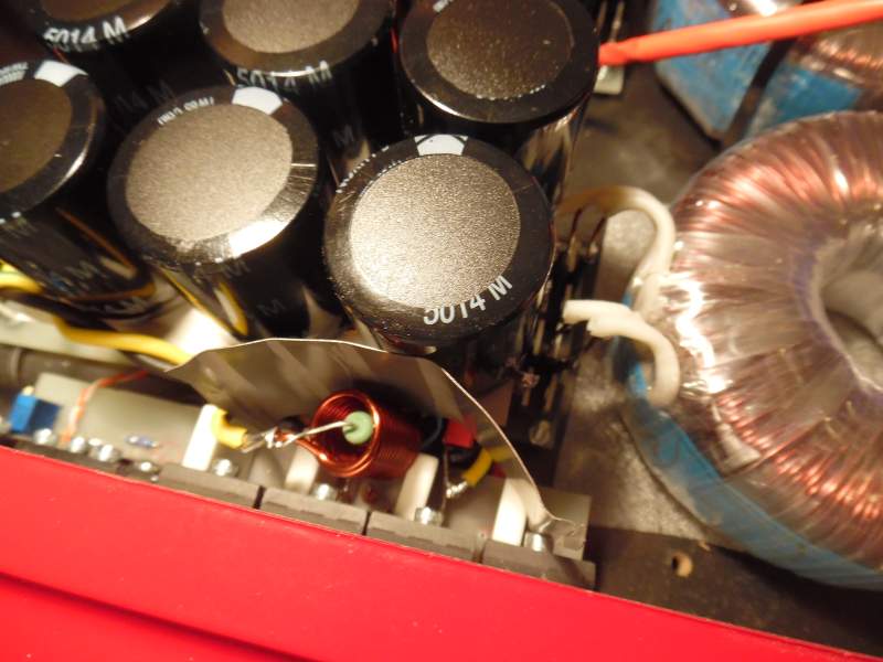

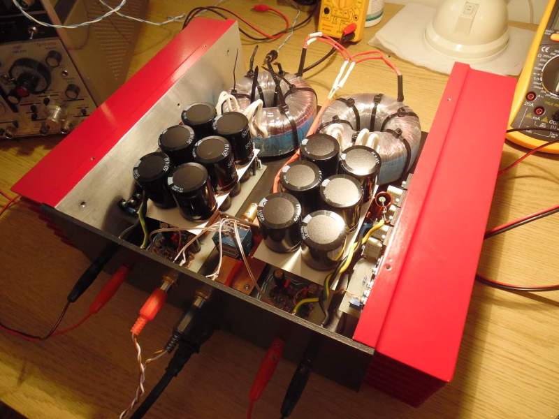

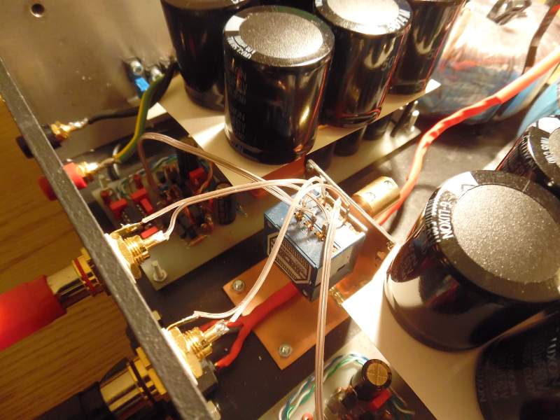

Hi Guys!
I made a lot of mods in the past days on my amp and among other things adding some
extra main PS caps on the "second floor" extreme near to the input pot as you can see.
A little hum appeared (typical cap charge noise...) so I started to investigate...
First I removed the extra caps but the hum decreased just a tiny bit...
Then I tried my trafo material metal "tape" around my trafo and it helped a bit.
But fortunately I didnt stop at this point but made some other experiments.
BTW: I tried to apply this post factum belly band as tight as possible but it
made some mechanical noises even if I put a sponge layer/foil between the parts
and it turned out the metal tape in itself produces some noise so I had to look
for some other solution... So if the magnetic shielding helped maybe it's better
to shield the sensitive point instead of the trafo so I started to look for the
sensitive part... Then after an hour accidentaly I found the part: the output coil...
Its not extreme near to the trafo but about a 10cm and when I put this Si tape around
it the hum disappeared completely... Then if I put back all of the extra caps the amp
remain completely silent... This coil is also some new "improvement" it wasn't there
when I started the chase before so it wass another good lesson to learn... 🙂

You might want to pull apart and twist your input wires from the jacks to the pot and then to the board.

I forgot this one 😱 .
When I had my trafo breakout point aimed at either of my main output
inductors , I heard a low level hum ( 30mm distance).
Your caps rectified hum is of a worse variety (more harmonics). My
caps are much further away (70mm). Your right on top of them ! 😱
PS - sheet neoprene >1mm is the desired material for GOSS bands/
tape.

Good point. I will come to it soon in my build 😛
No need for the twist that was exactly my point with the post to share that now withYou might want to pull apart and twist your input wires from the jacks to the pot and then to the board.
the output coil shielded there is NO hum at all despite the large caps near to the pot..!
As I said the material in itself had some mechanical resonance without having a mechanical contact to anything else... 🙄sheet neoprene >1mm is the desired material for GOSS bands/tape.
OS
And based my experiences now it can be spared with such a layout.
Ohh what a good feeling the life without HUM.... 😀
Put the inductor (not the resistor) on the end of a 6 inch twisted pair of wire. Then you can move it around and put it anywhere you want.
You mean like put it rather to the speaker terminal end?
Shouldn't the coil be placed as near to the OPS as possible to decpuple any reactance from the output wires?
For start I tried the 1cm diameter 13 turns || 10R, is is too big..?
I'll try to decrease both the L and the || R (maybe 2R2 will be enough I hope...) as well.
Sorry I think I was confused. I see the coil you are using. It's about the right size. I am still trying to work out though how this is causing hum. It's probably 2-5 uH and one end goys to the amp output and the other to the speaker. ????
I was wondering how it was causing hum too. Unless the amp is oscillating there shouldn't be any sort of signal there.
Edit. I think it's actually picking up noise and amplifying it through the feedback.
Yeah, why not..? Simple inductive coupling. Or this effect exists only in my amp..? 🙂I think it's actually picking up noise and amplifying it through the feedback.
Output inductor on a high Z FB network will do as you say easily.
The CFA's not as much. But both will still do it. It seems the inductor and
even the PCB tracks will send this EMF through the FB network.
Distance is your friend , even with the 1KVA ... 3-4 cm away gives no hum.
An open (unshielded) EI will wreck havoc.
OS
OS
Better yet, use thick heatsinks and put the transformer on the opposite side to your amp. I've seen several commercial amps that have the trafos boxed in with heatsinks.
Measure ACV across the inductor with the amp idle. If the DMM doesn't measure something significant, then it cannot be hum induced directly by the trafo. I would think the inductor is becoming an antenna and causing the amp grief, although it should be well shorted with a 10R resistor next to it (unless the resistor is magnetic perhaps). I have never measured levels across such a small inductor large enough to be audible across a speaker, let alone when that inductor was shorted by a small resistance.
It cannot be straight inductive pickup. The output where the two emitter degen resistors join is a low impeadance point. The feedback resistors go from here back to the IP stage. The other side of the inductor is going to a Lo Z speaker load. The inductor is also shunted with a low value resistor. You would need very high L currents to drive hum through the speakers in this scenario.
If the L was accidentally inside the feedback loop then it would explain everything. But if it indeed is located correctly we have to look for another mechanism I am afraid.
You say it just can not happen ??
The fact that cortez "foiled" it , throws a wrench into that conclusion.
It was the redirection of my "breakout point" that eliminated my last
10db of hum.
This effect was much more noticeable on a VFA , BTW.
