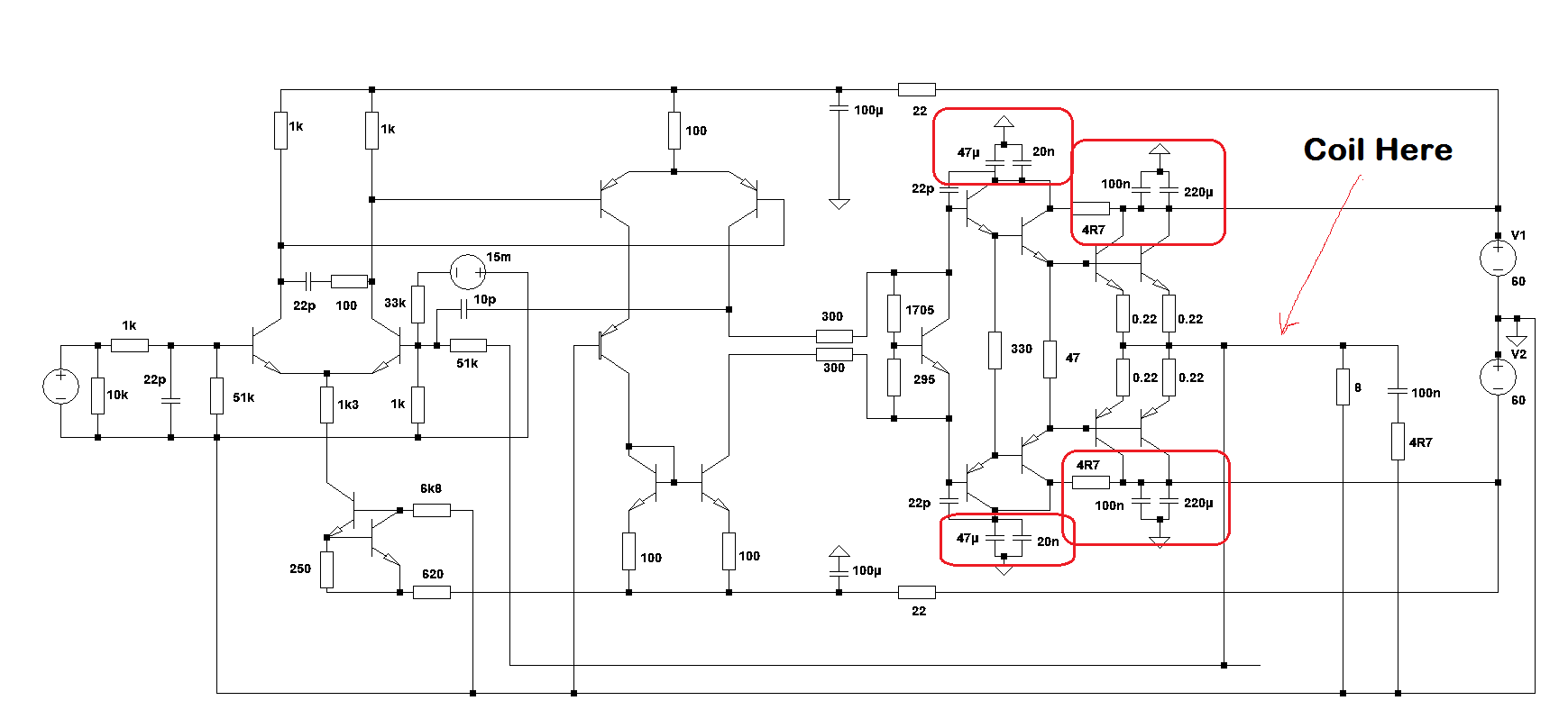

Won't it feed back into the feedback circuit and get amplified? The feedback circuit connects right at the inlet to the inductor.
and gets divided down by the NFB ratio.Won't it feed back into the feedback circuit and get amplified? The feedback circuit connects right at the inlet to the inductor.
It is RF that bypasses the upper NFB resistor by taking the easier route through the cap (sometimes used across it) that gets amplified. Not the LF.
No, the 51k in combination with it's 1k partner attenuates the LF interference that gets in via the speaker cables.
There is no 10pF across the 51k NFB upper leg in this schematic.

The 100n+4.7R zobel needs to be right at the output of the power transistors, and connected directly to local ground. Putting it on the wrong side of the inductor may be one of your problems, if that schematic is accurate.
If your amp has a noise floor at -115db and your "hum" is at -105db, that's 5.6uV of hum. So if you're using a soundcard or LNA to measure "hum" then it seems believable for the coil to pick it up. I doubt it would be audible though.

Thanks Andrew. I think I know what capacitor you meant. it's not used here.
Don't go by the schematic I posted. It was just a hypothetical question.

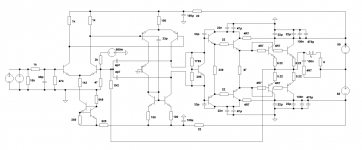

Oh !This is my latest (coil after the zobel of course... 🙂).
HF: 2 x 4p7 from VAS + 1 x 33pF @ current mirror.
FB: low Z! (2k3 + 47R now)
I dont know why the coil caused the hum but I can measure/try whatever you are curious to...!
The coil L have to be in parallelel to the 8 ohms. Do you really want to set a serial 8 Ohms at all the frequencies in serial with your speakers ?
That's a lot of gain. Most of us manage with 20times to 30times. You have 2k3 (not an E24 value) divided by 47r plus 1 = ~50times (+34dB).This is my latest ...................
