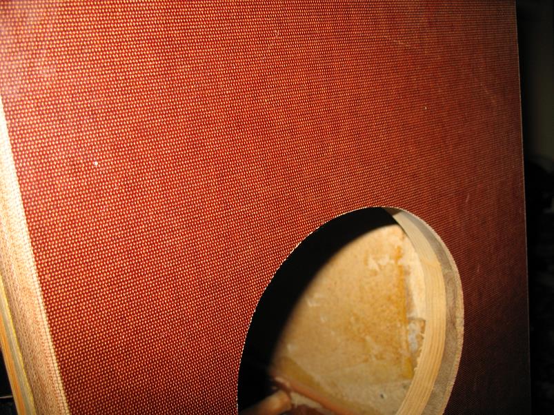

I like the phenolic resin laminated board gaborbela. That stuff stinks when cutting it eh?

Yeah gaborbela, that is called phenolic here. A resin impregnated substrate used a lot in electronics.
I built my first pair of speaker baffles (Fried C3L) with it, as I was in Turkey at the time, and all the wood places had was some pretty horrible OSB. I did have access to electronics stuff though.
You can sometimes find good sized pieces of it in electronics salvage stores.

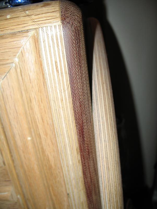

I know hard to work with but I do like it. I used it as a front panel sandwiched with Baltic birch. Excellent.
I wish I have a sheet of that.. phenolic 8X4 or 6x4 feet
