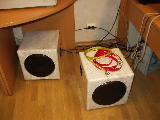

some sort of marble has ideal damping factor. of course you must to damp cabinet inside. but, view, sound, .... so, I like it
Yury -
That really looks nice.
I've never heard of marble (or any rock) having good damping properties. Again, any enclosure made of a single material is not going to be optimum. By constructing a light/rigid enclosure and utilizing constrained layers you can achieve fantastic damping and therefore a 'high performance' speaker enclosure.
Constrained layers contain a centre layer of viscoelatic type material that shears when flexing occurs in either of the surrounding layers. This shearing action is very effective at generating heat, which is what you need to do. A slab of MDF, Concrete, Marble, Plywood is NOT effective at generating heat from vibration, and is therefore not well damped.
Constrained layers can be very thin by simply gluing two materials together, but there are is always an optimum. An enclosure within an enclosure can work fantastic as well, as you are reducing the efficiency of vibration transmission from the inner box to the outer one. Filling that gap with sand may or may not improve things. A vacuum would probably be the best thing to use. This type of construction is tricky as well, and can end up being bulky and heavy. Each system has some trade-off.
Quite right, MartinQ, mable and granite are not very good damping material per say which is why I use it on the outside because of it's one good quality, dissapating the heat generated in the tar layer. If you see my my post you'll notice I use a rigid inner cabinet with a gap filled with sand that dampens almost all mid-bass to midrange frequencies. The remaining low frequencies are dampened by the tar/granite sandwich. Oh yeah and high frequencies are dampened inside the cabinet by having varying densites and/or dampening materials used.
Ahh.. it's all clear now. Thanks, and good effort on that box!

let's considering the fact's only. damping factor (DF) I mean is reaction of material for outside mechanical (acoustical) force. this is sound pressure. moreover we talking about subwoofer, low end range, less than 120 hz, plunger mode till 80 Hz will be better.
so, like I knew in the university, in particular a marble has an ideal DF. response to sound pressure within bass range is optimal. marble cubical box isn't emissive any, exept effective, original sound. his durability allow us do not use additional facility of rigidity. marble sub have not chanse to mutter. it's ok.
next thing is composit layers. I wouldn't make sandwinch. it's realy difficult and it's not necessary. anyway we have to place any smooth materil inside. paste it over with glue.
apropos, I used special epoxide resin for marble. it's absolutely effectively connected panels, thick 25mm.
satelites, I'll make another way. marble front panel and wooden others.

Cloth Ears said:Yury,
Those are pretty subs! I hope they sound as good as they look.
not exactly Cloth. but thank's for opinion.
my Alto has 32 litres only. and it force me to make port 75mm length 250 mm. it means frequency of port is about 40 Hz as well.
new model of Alto has exponential port and I'll tune it to 16 Hz.
remember mi, E string of bass gitar has fr about 11 Hz. how does we hear it? 🙁 pity. will work about it, but I couldn't make sub bigger, then grand piano.

about temperature inside sub. of course it's active. original amp, used MOSFET made my partner Samod (200153104 ICQ UIN)
you can find him in the suitable DIY forum. it's perfect amp's. now he work about amp, without feedback. it will be the best. I hope you know why.
so, his amplifire has cooling, from port blast. it's realy enough.

see the difference
see the difference - marble and other stown. granite - work using rock hammer drill, but marble - using simple drill.
I've used not any marble. she best - is Carara. optimal thickness, compactness, solidity. generous view. easy to work. nice get on glue.
lot of colors, not expensive.
