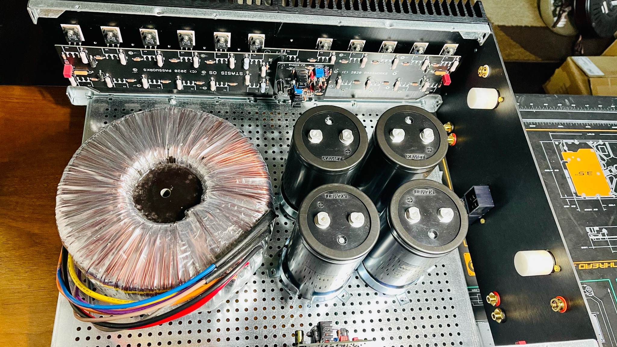

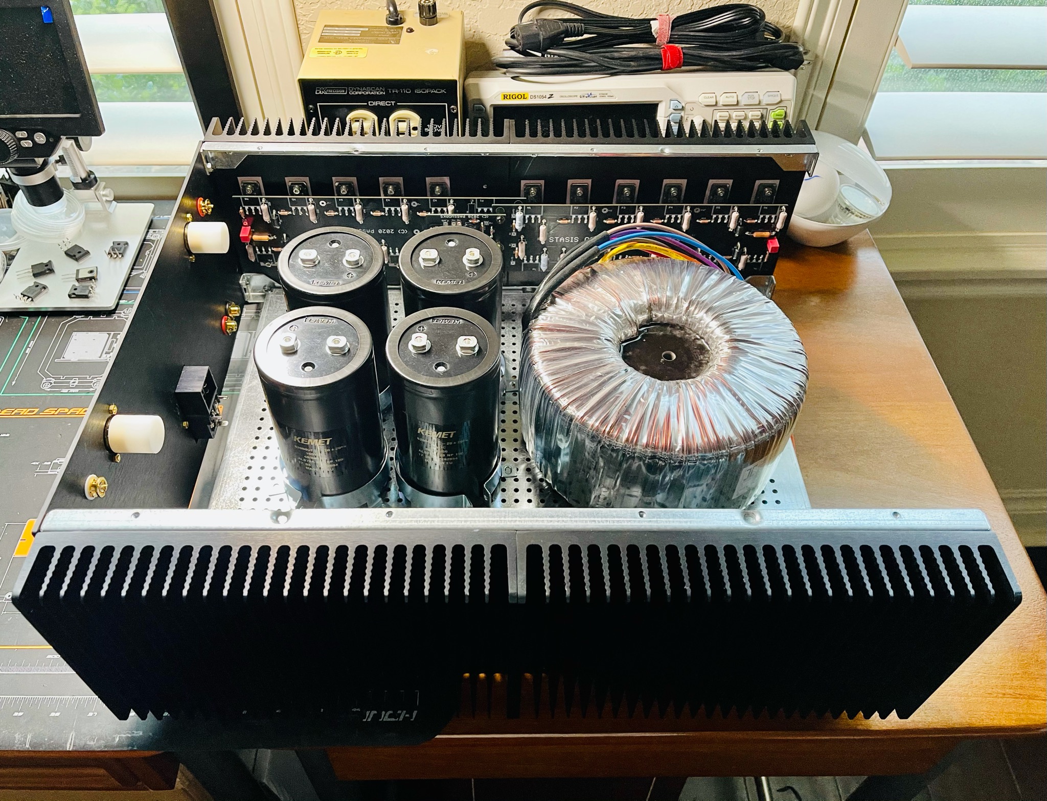

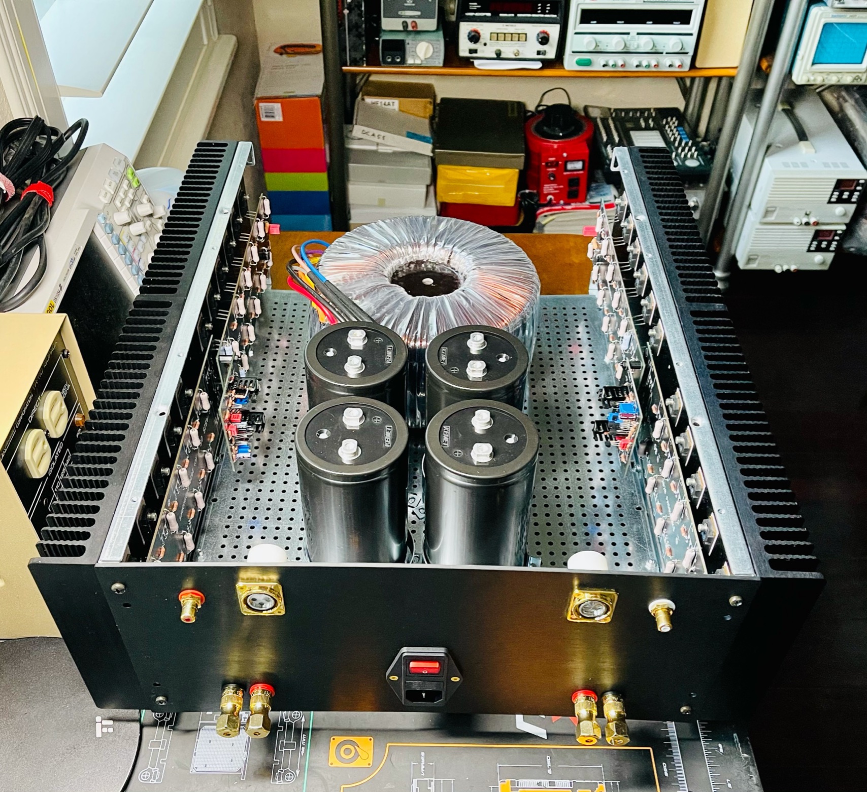

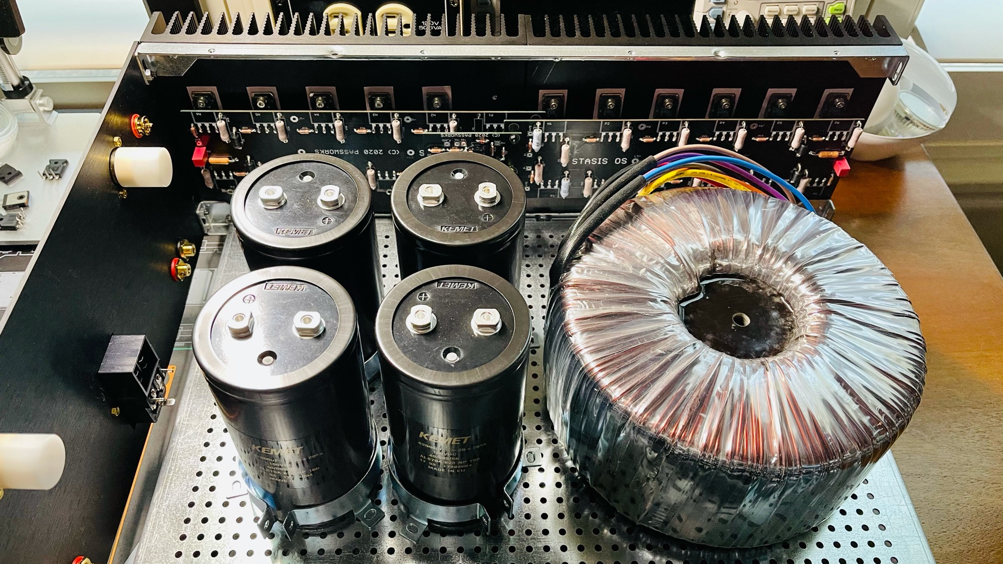

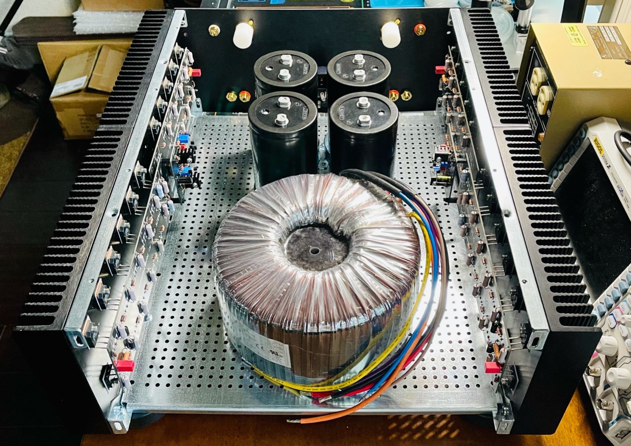

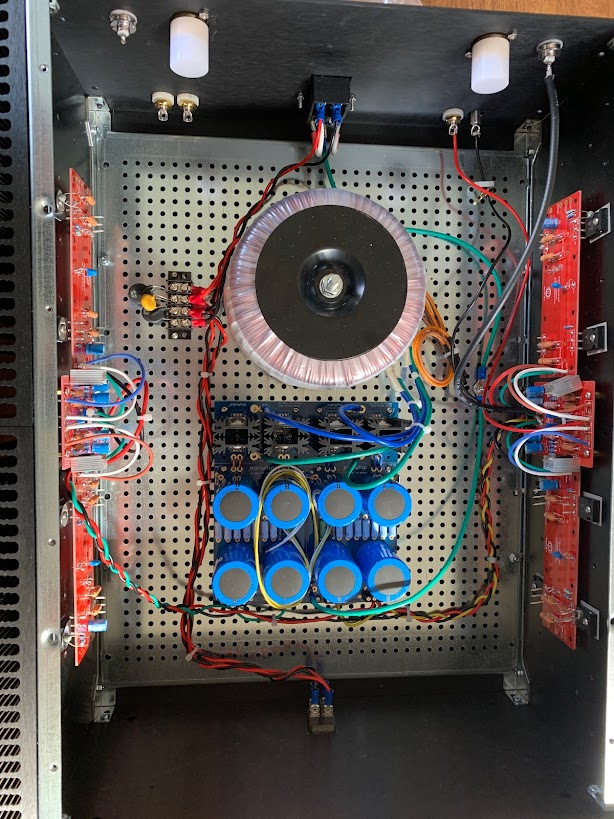

Here's my initial build along with v2 of the layout wire routing.
I've been having some minor hum issues, and got them partially sorted out. The next step I can take will be swapping the PSU with transformer front to back. Perhaps getting a smaller transformer. Chasing a hum has been pretty frustrating!
But you can see the case looks great. In case anyone is wondering, I included the vector art files and font in the zip attachment.

Yass that front panel looks good.
Don´t know if I´m in a position to give advice - but you can still ignore it 😀 :
Regarding Humm: NTC 60 between PSU ground and case, maybe a little more twisting on transformer wires.
Maybe some rubber grommets for the wires through the base plate as mighty ZM once told me. Maybe output devices to bottom for better thermal distribution.
