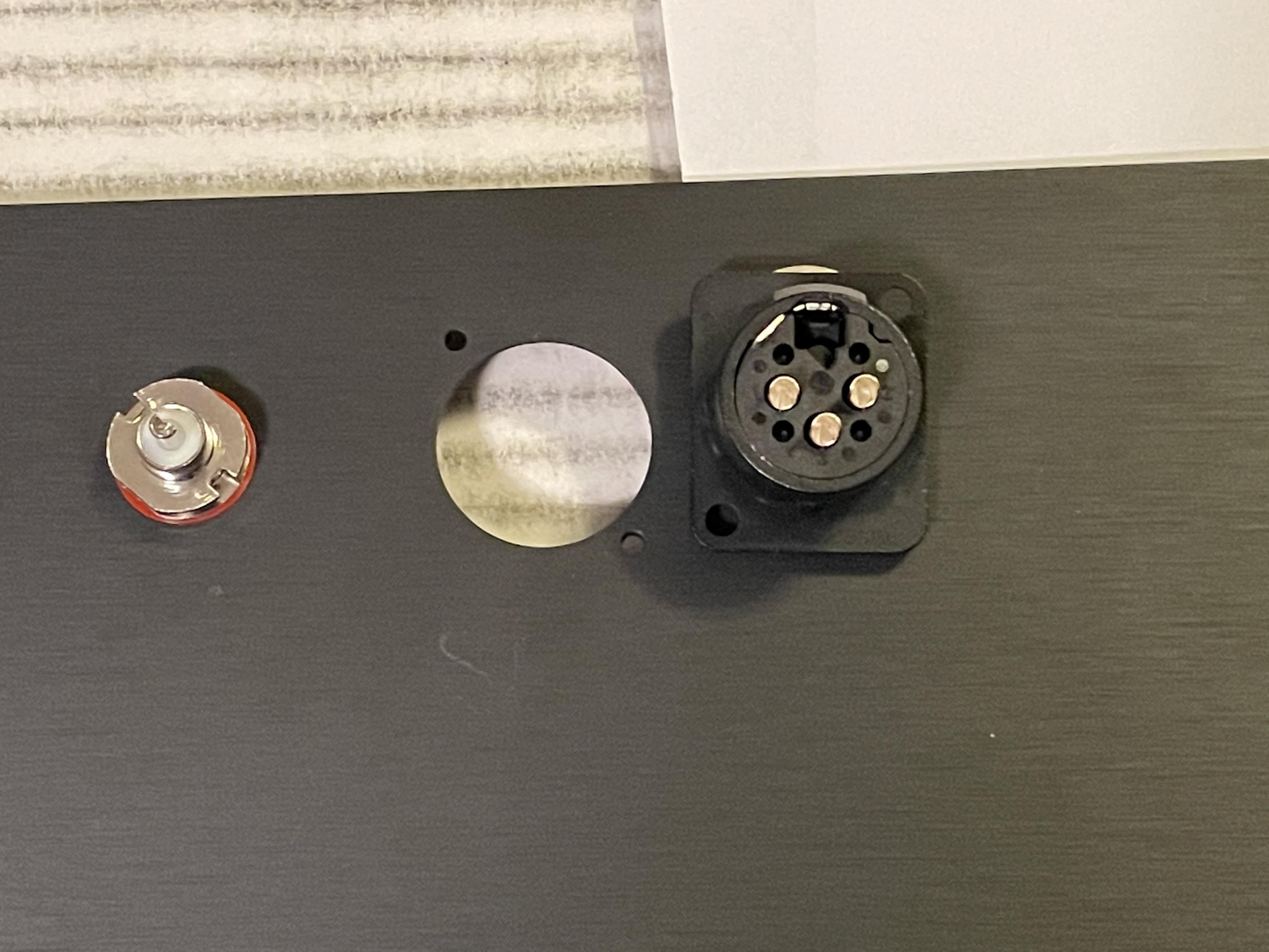

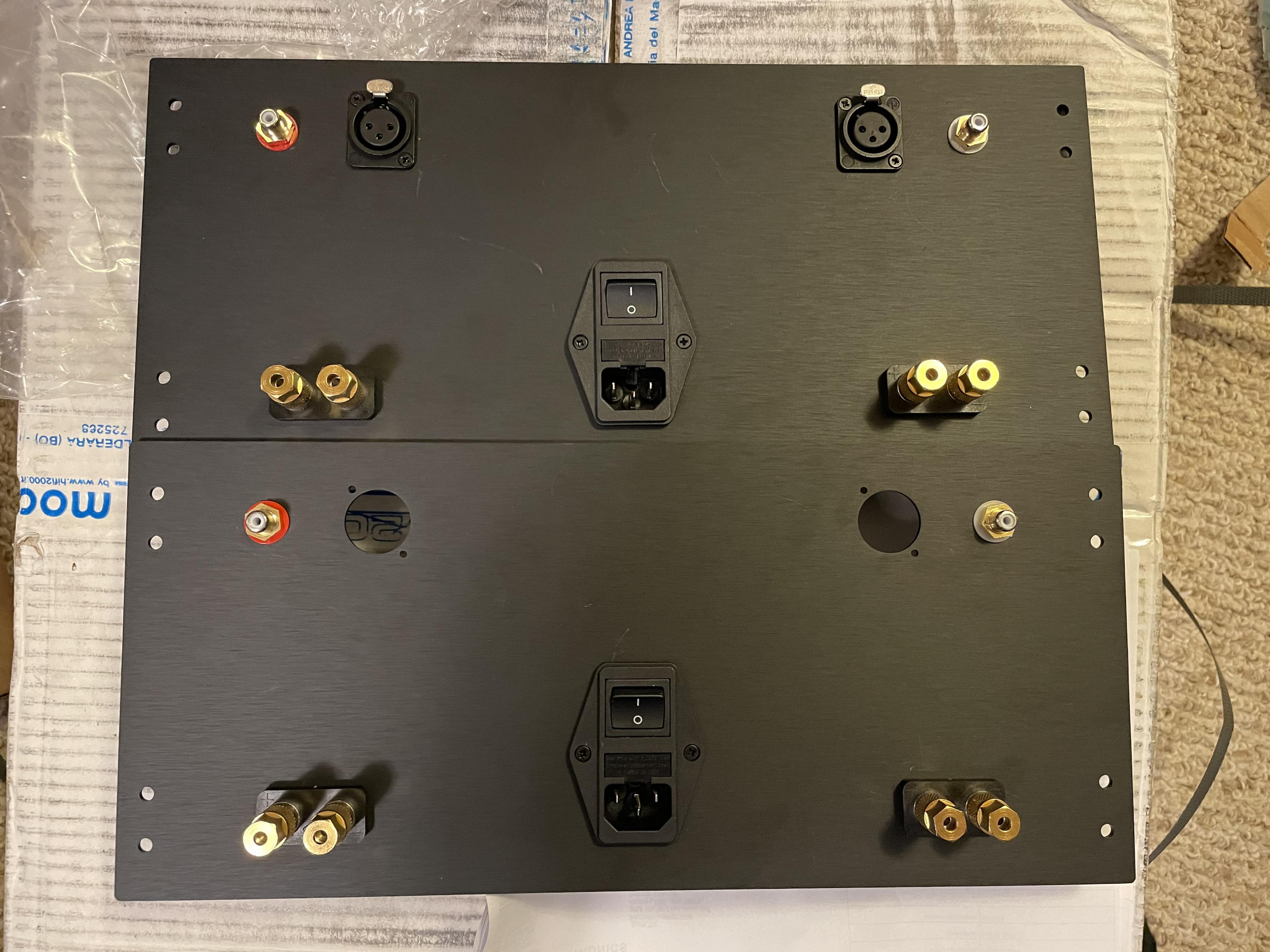

Onto the funny part. Many of you probably know that the XLRs have to be mounted on only one side of the back panel due to the orientation of the holes. I had both back panels assembled minus the XLRs, and had to take it all apart and reassemble. Yes, I am a dodo.
For those that did not know this little treat... see pic of the "before".
And the "after"... two back panels minus one set of XLRs.
Thankfully, this dodo is consistent and forgot to order some other parts, so the extra XLRs can go with that order.

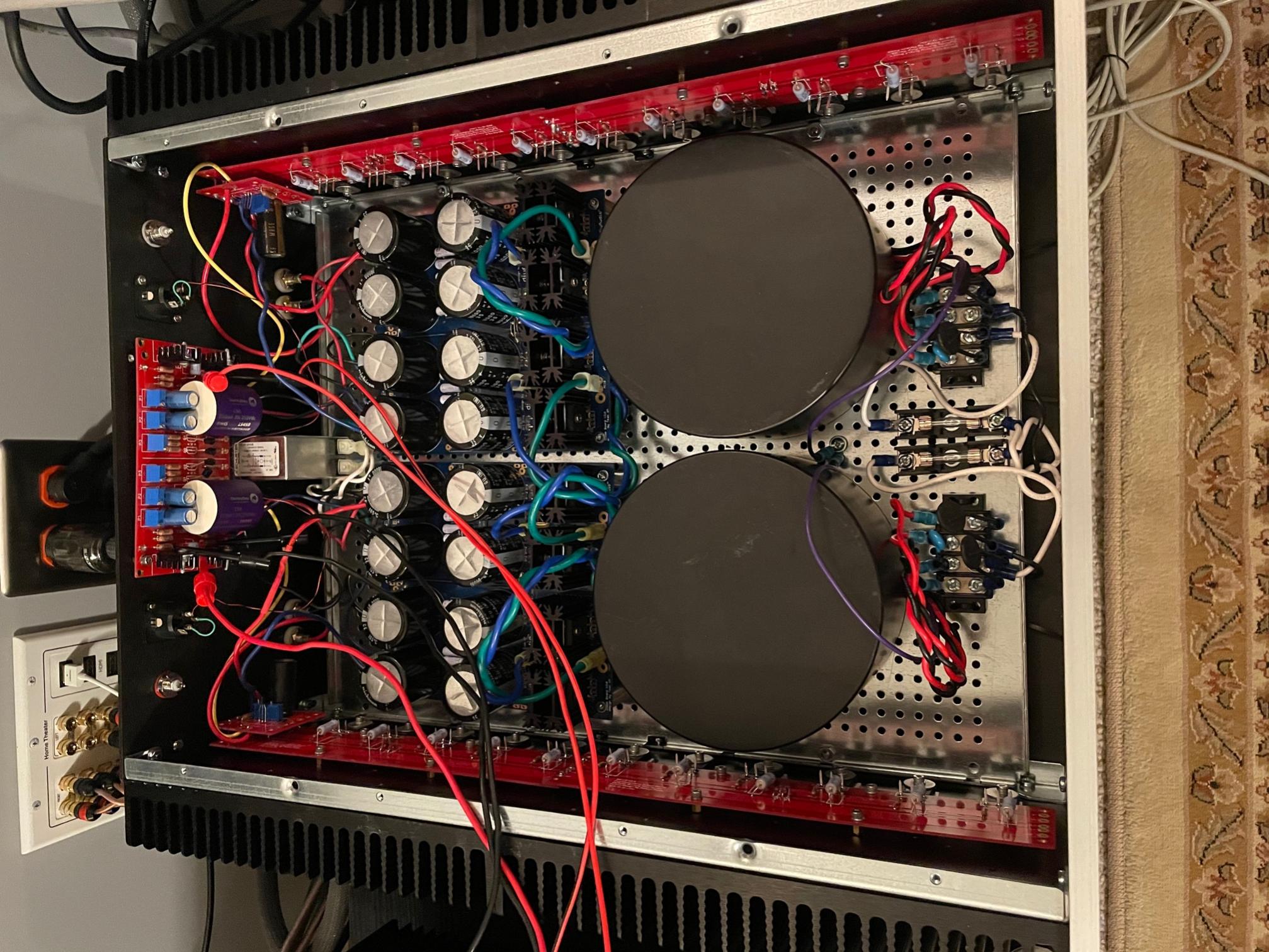

Another teaser shot of what I think will be the final layout is below. I had to move the PSU boards a bit away from the back to make room for the mighty Schurter power inlet. Just mocking things up to ensure it all fits and will be "clean". I decided to forego the CLCRC at this point. Baby steps. I can add a few caps and inductors later when I get the courage. I am definitely not worthy of the FAB club.
Now, I have to use all my remaining courage for the day to tap my back panels to mount BA-3 input boards. Maybe after a few 100 more taps, I won't find it so daunting.

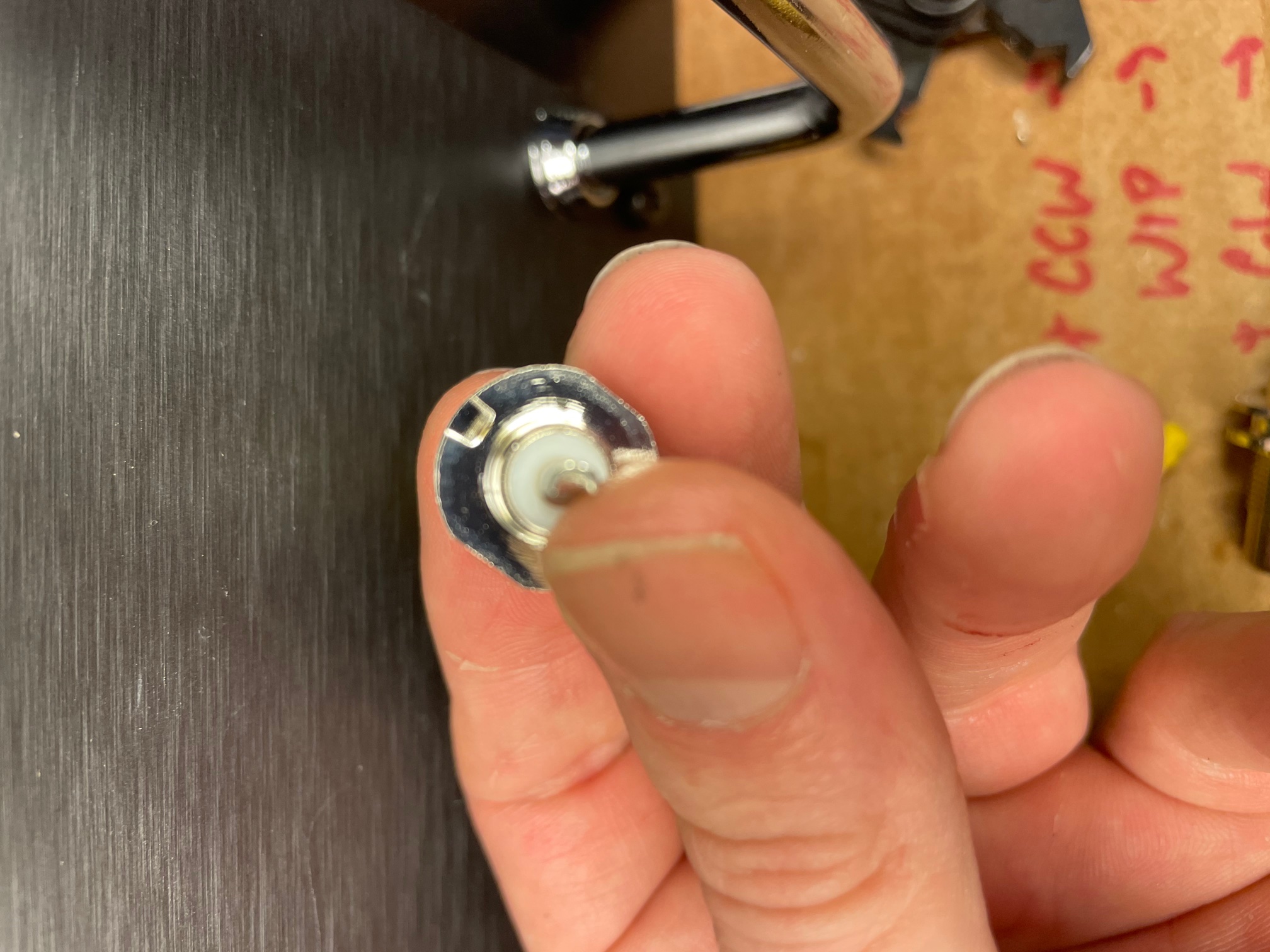

A quick question for any of you that have used the Cardas RCAs. I happened to get the short ones, and I think I love them save one aspect.

I'll give it another go. For the time-being I wired up the XLRs.
My iron/tip should be powerful enough to transfer and hold enough heat, but perhaps I was a fraidy cat. I did find a recommendation online to perhaps sand off some of the rhodium (if that's what it is) finish to make it easier to solder, but perhaps it just needs to have enough time. With lesser quality connectors, the sleeve for the positive input can melt, so that was my concern. Cardas provides no direction on their site re: heat.
Again, thanks for letting me know that the notch is a viable option.

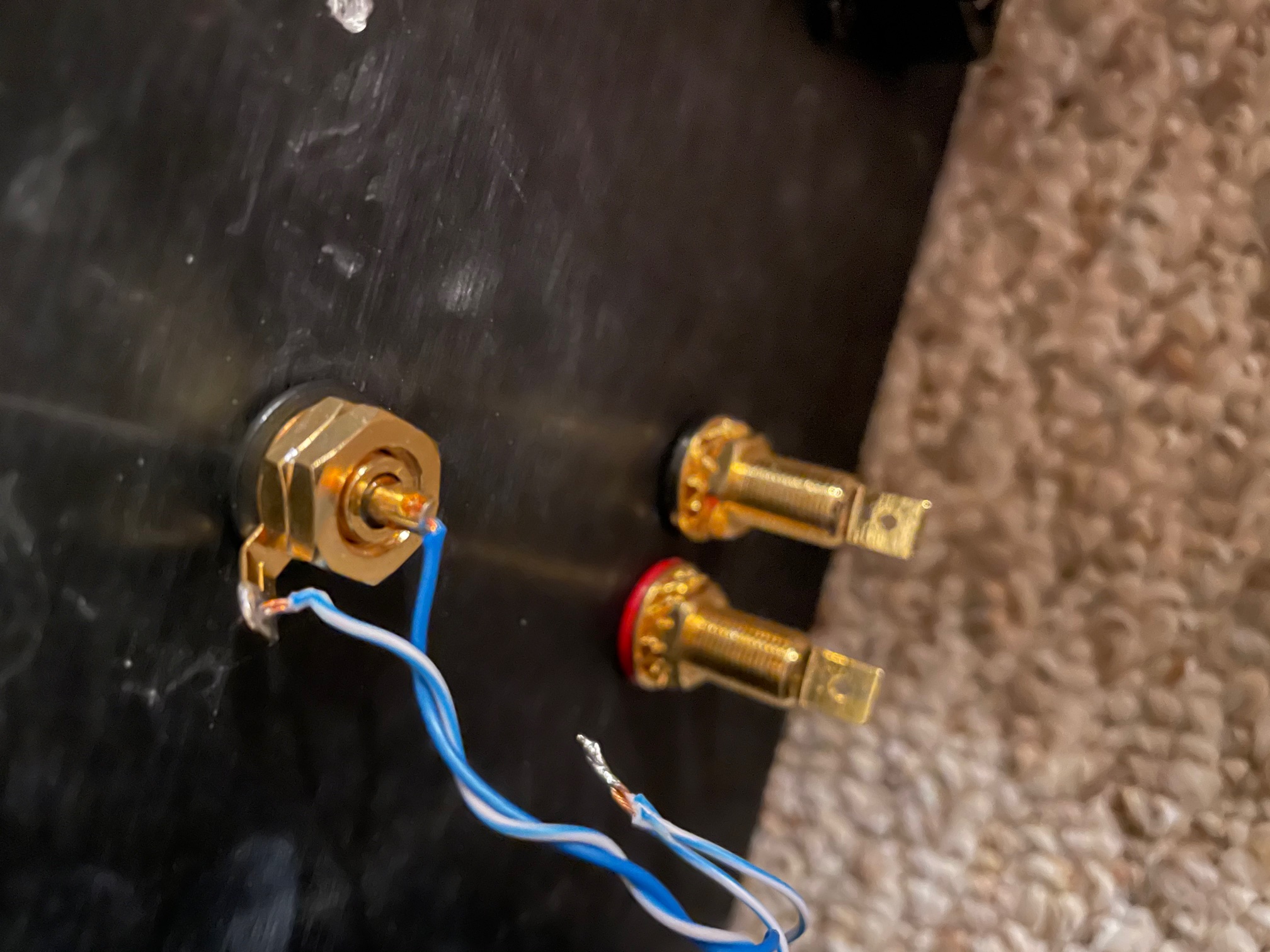

Again, for those that want to learn from my mistakes... I wanted to solder the posts outside the amp vs. connected inside the amp. The gymnastics required to get a proper joint would have been phenomenal to try and do them with the back panel mounted and the posts in place. My body won't go that way.
So, I soldered the output wire / gnd wire to the posts, then fed them through the back panel, added the appropriate washer / nut, cut to length, then connected the internals to the boards in the chassis.
The only thing to be careful of if you do it this way, is that the nut has very little clearance around the solder cup. So, you can't leave a "knot". It needs to be clean.
If I had it to do all over again, I'd install all the input and output connectors before I installed the back panel, and then solder all the wires appropriately to the connectors on the back panel. Then, I'd install the back panel...
Again, live and learn...

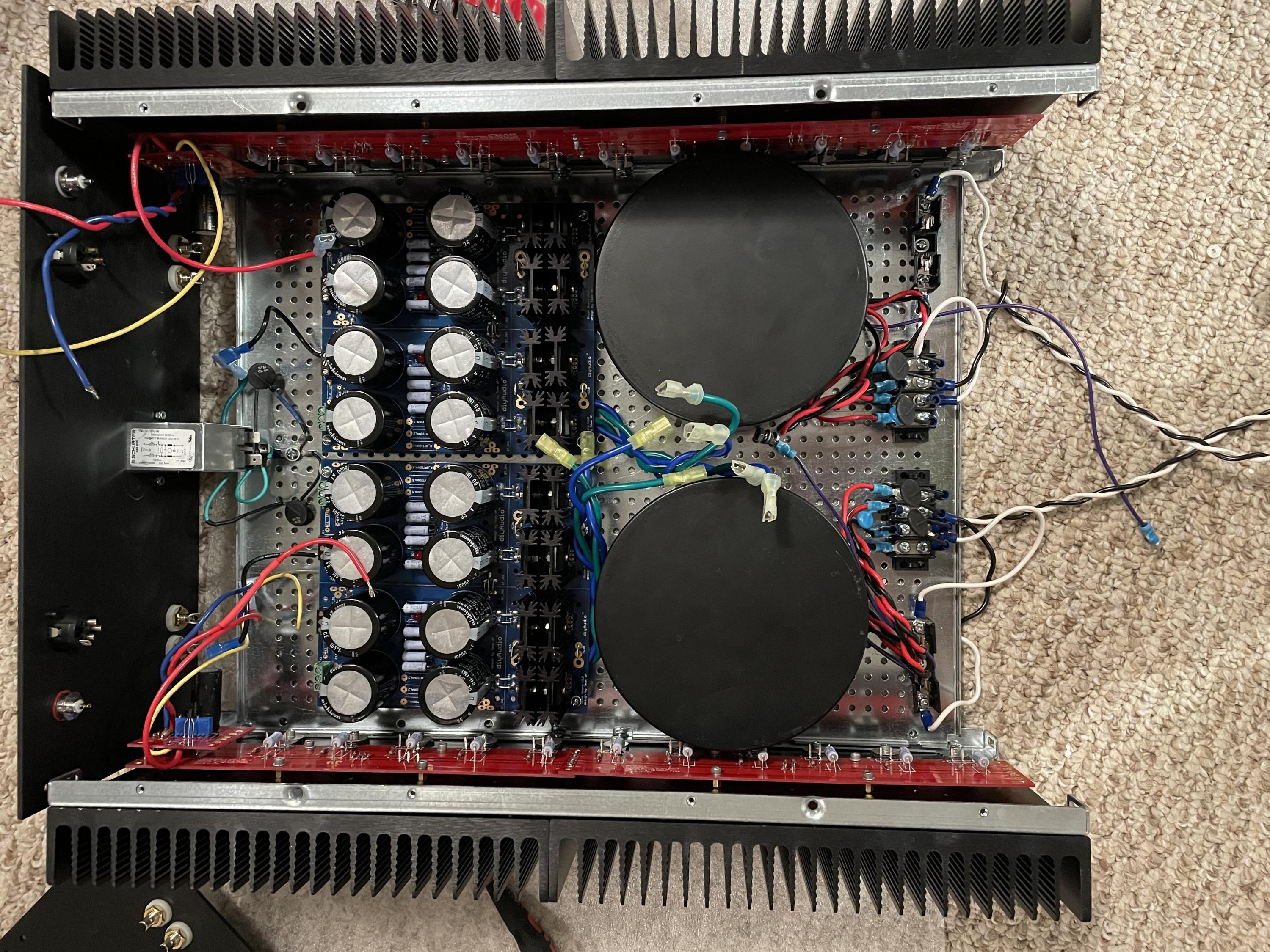

Well, I went through all the dim bulb testing, slowly ramped up everything while checking voltages with the Variac, initially biased the front end, and initially biased the output stage. I buttoned up the chassis, so I can set the final biases, null the offsets, and let it cook.
I am ashamed of the rat's nest of wiring. I thought I had my dressing planned well. It will need to be revisited. I'm also considering moving the front end to a mezzanine perhaps over the PSUs. For another day...
Sod that mate.
- Power on and no smoke - check.
- Music out - check.
- Crack beer - check.
- Kick back and enjoy - check.
- Sort out wiring tidiness? - meh, L8R.
