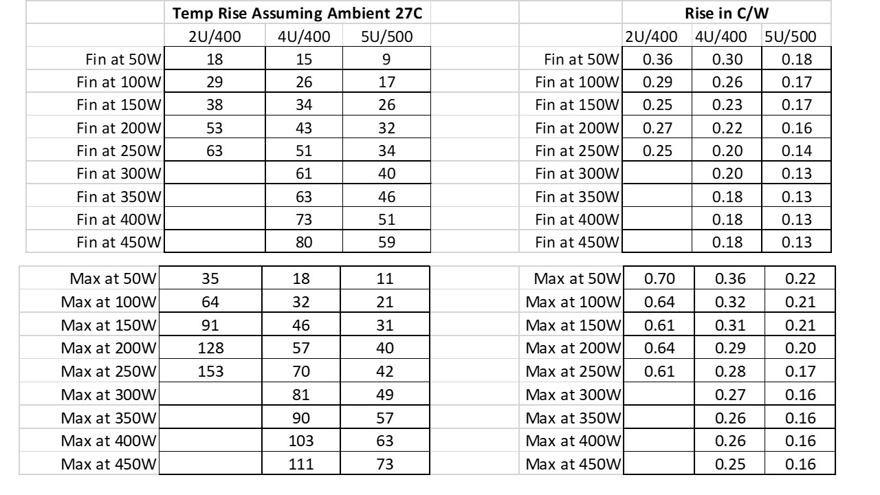

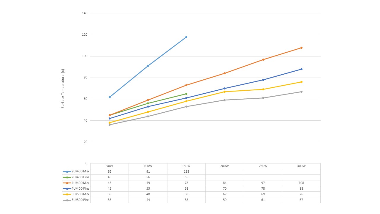

I can't remember if I posted this or any kind of a summary. Forgive me if this is repetitive or posted elsewhere. Early on in the thread, Gianluca was most kind to post the study they did for their heatsinks, and 2 Pico Dumbs indulged all my questions re: potential temperature rise vs. dissipation.
Attached is a chart and a graph I put together using data from the study. I also did some makeshift de-rating analysis and put together a really lousy regression equation in an attempt to predict de-rating / temp rise above ambient for heatsinks/chassis not included in the study based on heatsink width and height as the independent variables and assuming the same heatsink profiles and mass per unit area.
Note - from the study, it appears that ambient was 27C.
Perhaps it may help someone. I can share more info if desired. It's in no way complete or in any way reviewed by anyone other than me, so forgive any errors.
