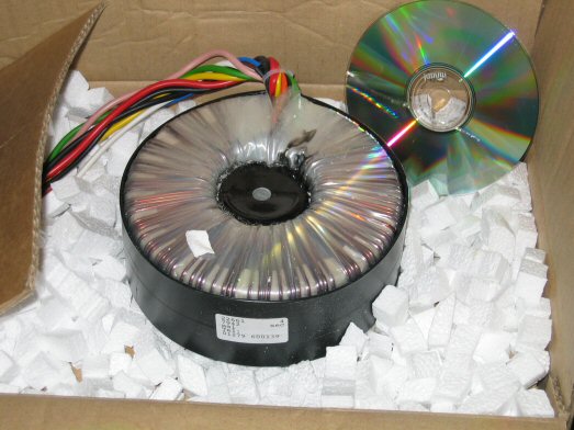

Tranny update!
Air link have confirmed that they have wound the transformer
as two lots of 500va …. As they can’t wind the gauge req for 1000va
…….18v x2-0-18v x2
Wiring Colours:-
Orange white 18v
Yellow black blue Green Neutral
Red Pink 18v
tj contact me I need your full name
Magura contact airlink they have a problem with bfpo address
Traffo landed!!!
Hi Traffo has landed.....all members in the group buy will getting ...these little beauties....soon!!! (prepare for back injuries)

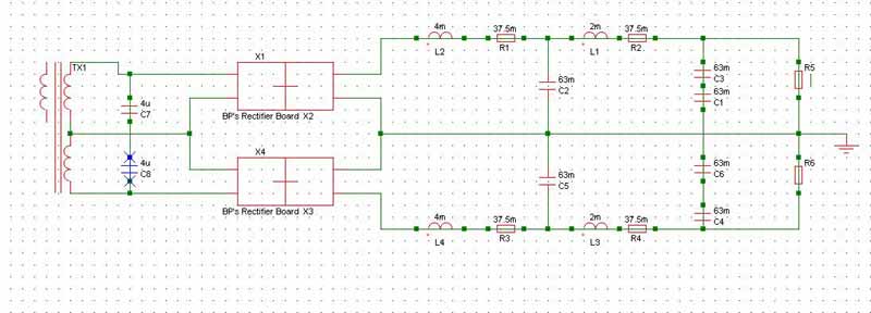

Planning on this, comments please.
Inductors from Jason source. R1 to R4 would be NTC Thermistors, ( also on primary side not shown. )
As mentioned before looking to buy these soon either Epcos' BS57237S0100M000 though not 4.2 but 3.7A as per data sheet so probably to low a current value.
Actual CL60 replacement is Epcos' BS57238S0509L002 6.4A. Quoted 1.40 each for these.(qty>50) Let me know if interested.
On the other parts would prefer Black Gates for all caps where possible. BP have you checked out www.thlaudio.com for a quote.
SineEra Power Supply
Please shoot me down if i've got this wrong - i'm no expert and there are plenty around the forum that are, but i have taken a look and think you should not use C1/C3 in series - you are doubling the voltage handling of the capcitors but halving the capacitance - i would suggest moving C1 to the left of L2 to create a CLCLC pi filter, obviously ditto the lower half of the circuit.
I don't know what C7 & C8 are doing (but as i said, i'm no expert) they are inevitably in parallel with some (but not all) of the diodes on BP's rectifier board and may have an adverse affect (BP to comment please?).
Why are you using thermistors and inductors? If you need more resistance to drop your supply rail voltage then just increase the coil size of the inductors (the DCR of the coil will increase proportionately). I've just never seen the two used together before....
C7 and C8 are not quite duplicating the capacitors on the rectifier PCB, as the snubbers are in series with the reseitors to give a more controled damping response. However, I doub't that you will need these in your supply and they may easily ommited. As far as using the thermisotors and inductors in series, there are two things I could say:
firstly, if you are using the thermistors to simply act as a type of soft start circuit for the supply then I would leave them in, as they will ease the turn on current rush significantly.
however, if you are placing them there to act as a resistance in the fully opperational power supply, I would say to take them out an either use a bigger inductor (with higher Rdc) to get the desired output voltage, or to simply use fixed resistors as these would be a lot cheeper (although, in a choke smothed supply, they may not be entirely neccessary)
Anyway, hope that was helpful in some way (and that there aren't too many spelling mistakes, as I just got back from the pub) and I look forward to finding out what you were intending them do do in your supply.
