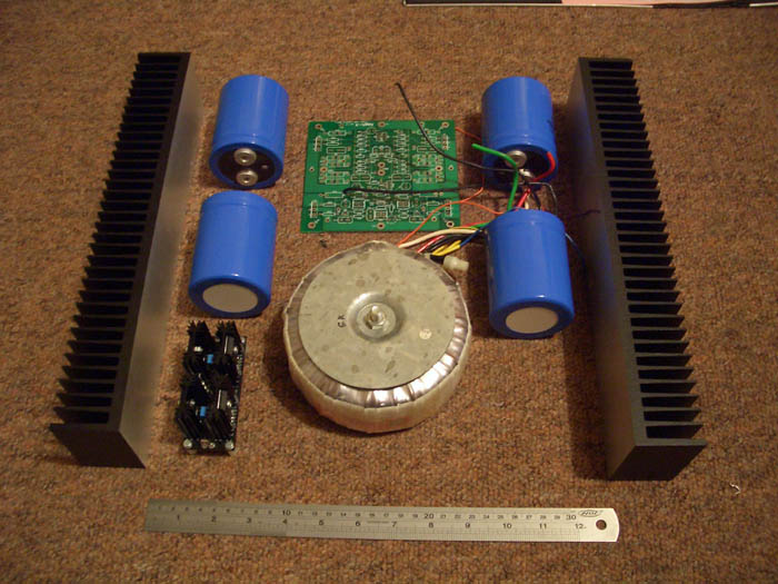

Well, I picked up my caps today, and they look like they should just about be the perfect fit in my smaller than average Aleph-X box (when I get the rest of the sides any way), but thanks for sorting this Richard, much appreciated (again)
Andrew.
Hi, the plan is to go for 19V rails with around 6A bias to give about 70W into a four or eight ohm load and a peak of around 100W at about six ohms. But this may change slightly, as I will be running a CRC filter and may decide to drop a little more of the voltage to give slightly lower rails and better spply filtering.
