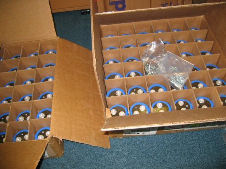

CAPACITOR SPEC
Huge 68,000uf @ 50v 3.5 inches high & 2.5 inches in diameter
screw lugs.........Nichon Chemicon
