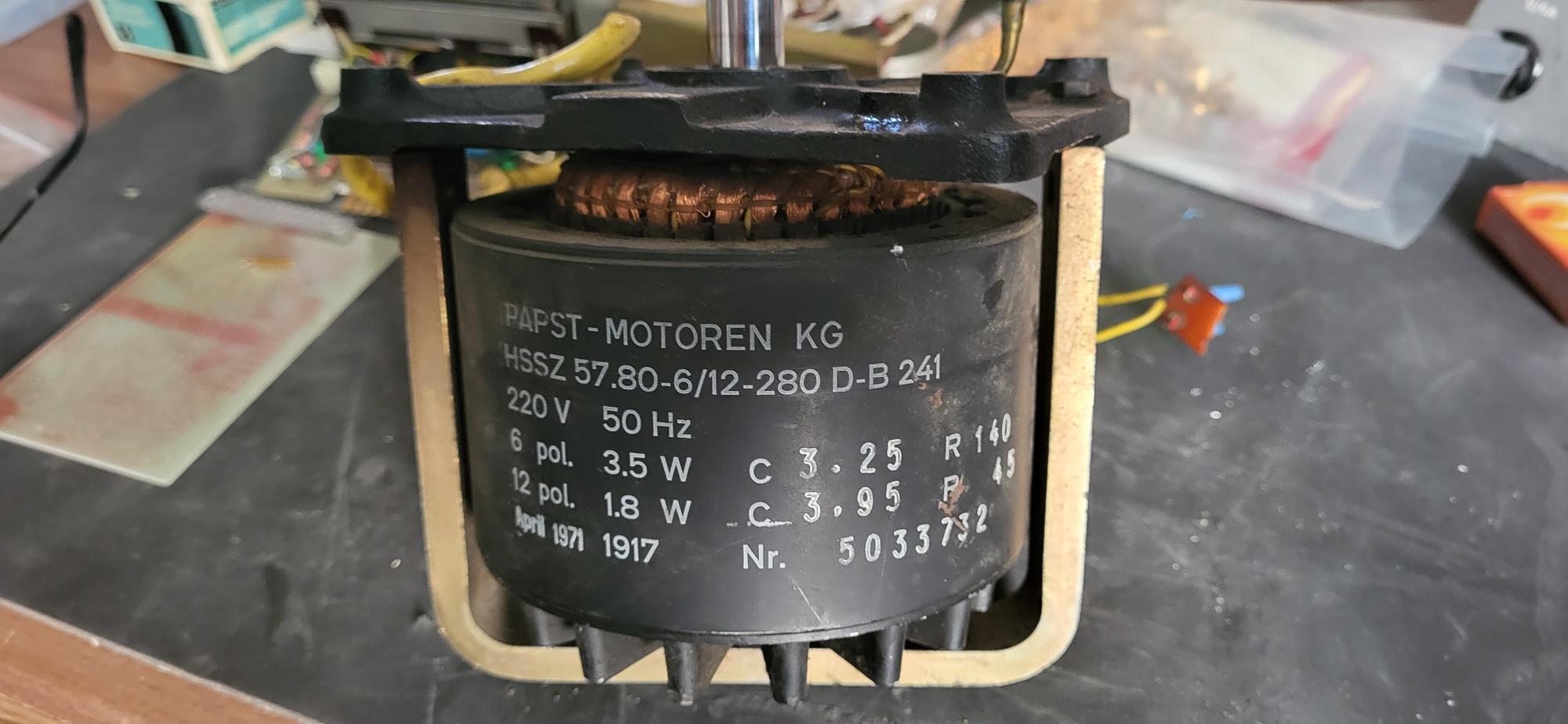

Dear Sir,
The record player shown in the picture is extremely fast with a 6 kg plate, the speed does not swing too much. Picture a motorcycle.
If anyone needs a Papst engine, write a PM. We have several types in stock. The other record player in the picture also works with this engine.

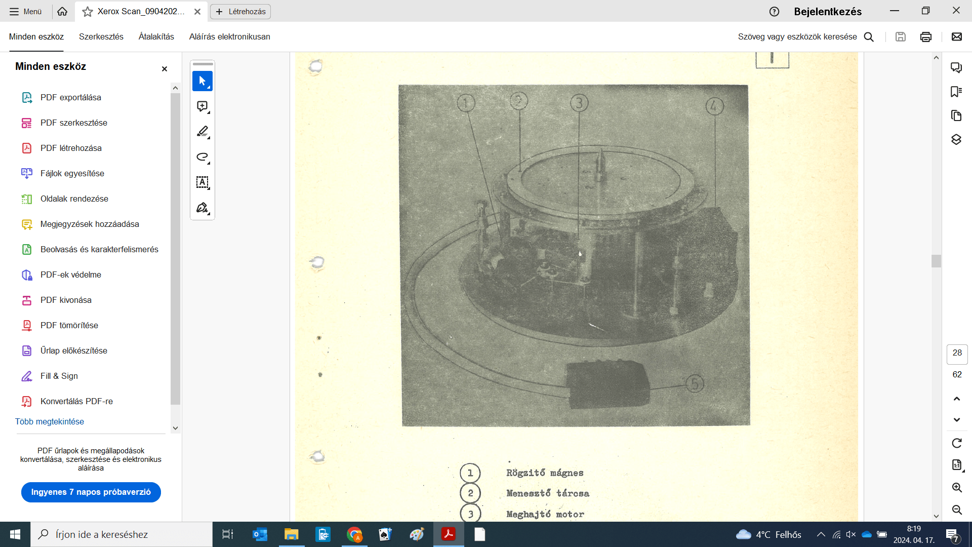

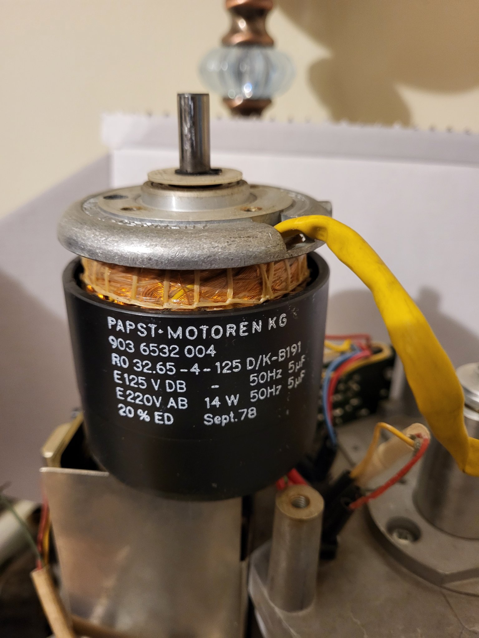

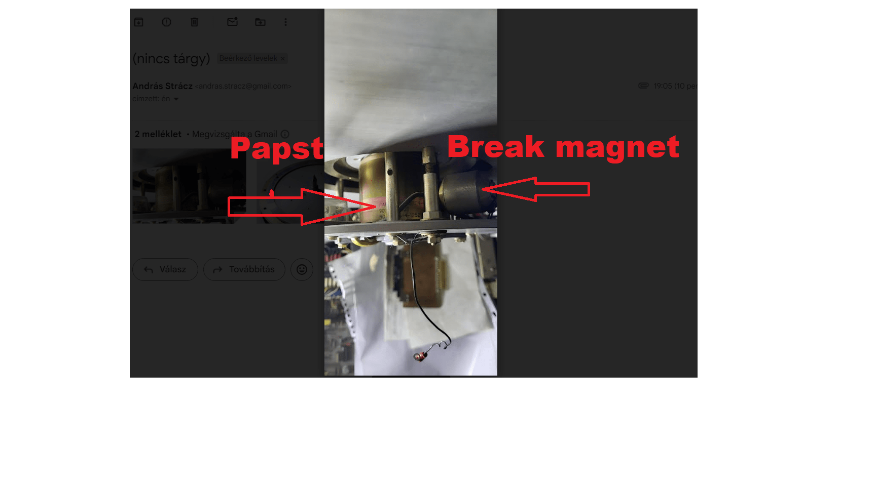

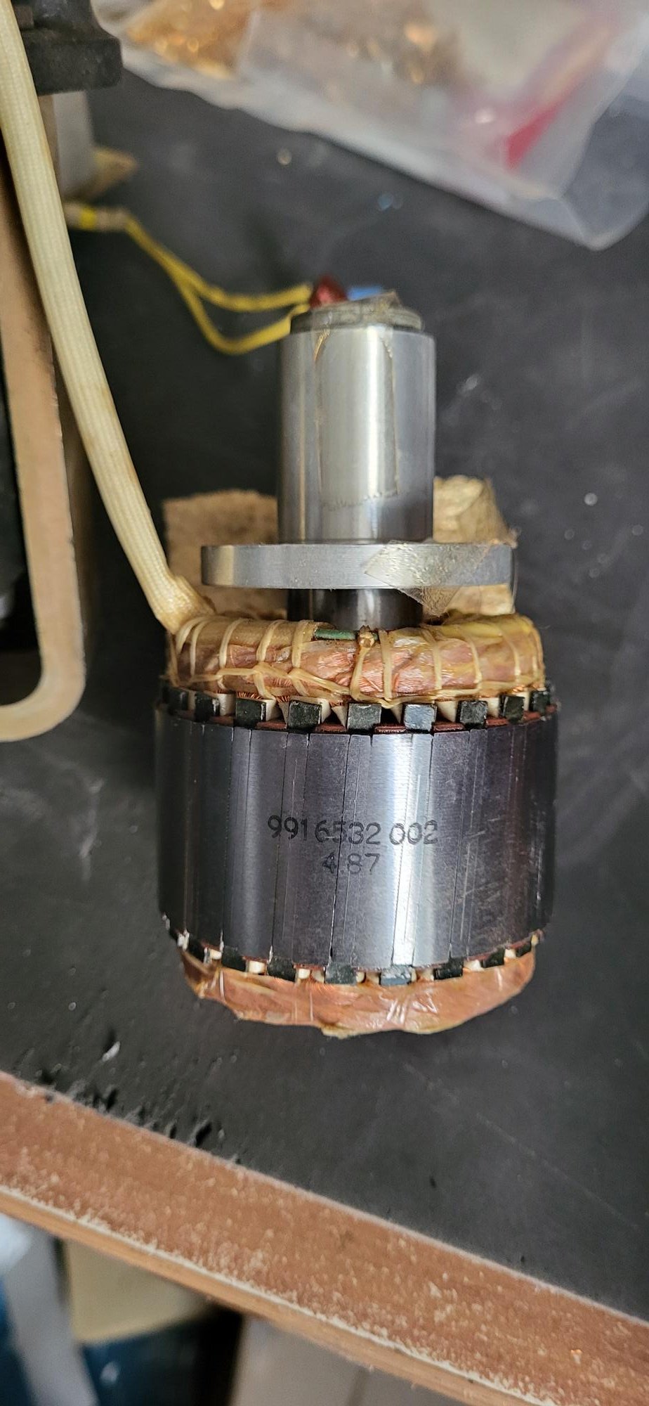

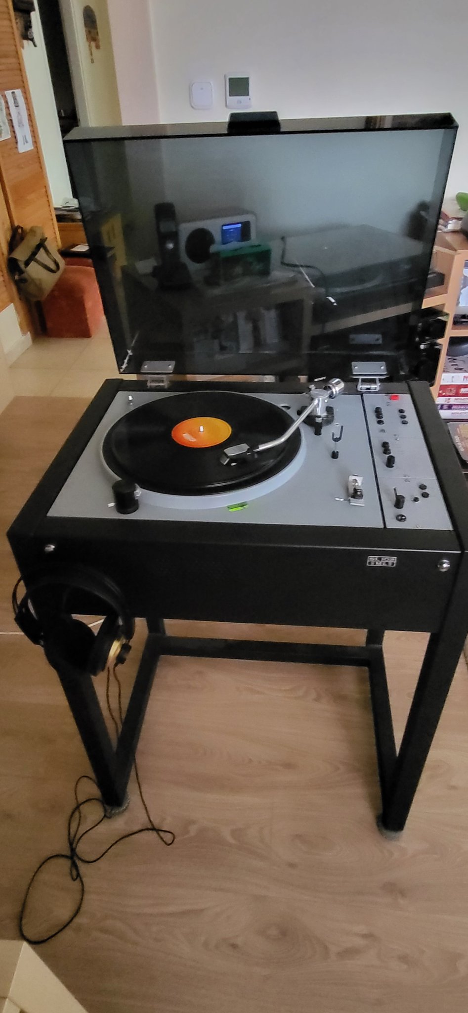

Hello Ralph
The professional studio record player shown in the picture works with the motor shown in the second picture. When I have less time, I will take it apart and take pictures of the entire construction.
Andrew
Andrew
When the vacation is over, we can continue.

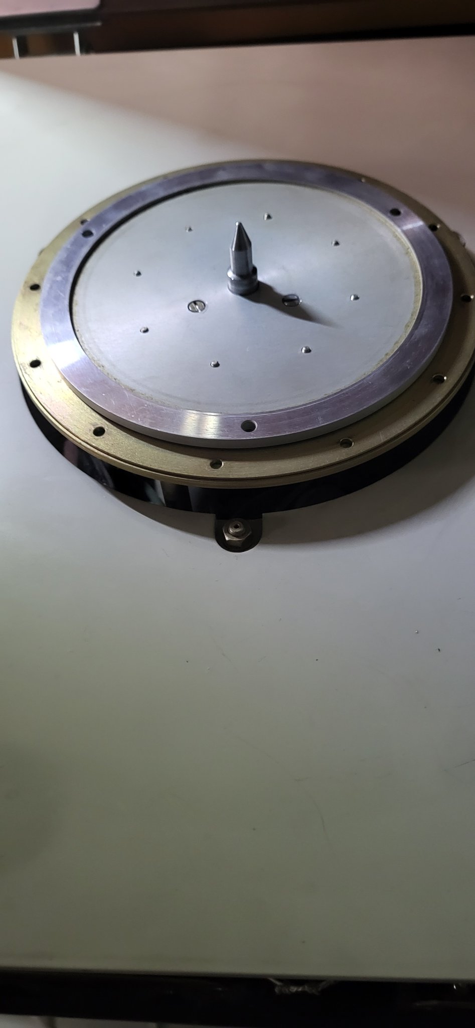

The sub platter picture is a picture of my own turntable.
