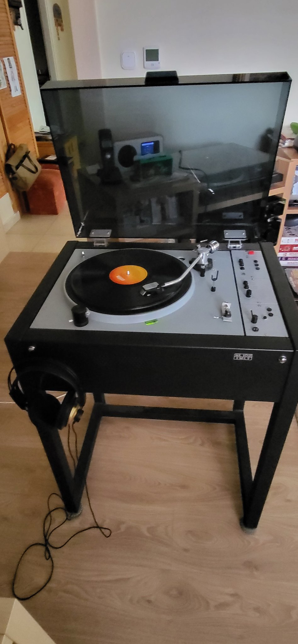

The record player shown in the picture is extremely fast with a 6 kg plate, the speed does not swing too much. Picture a motorcycle.
If anyone needs a Papst engine, write a PM. We have several types in stock. The other record player in the picture also works with this engine.

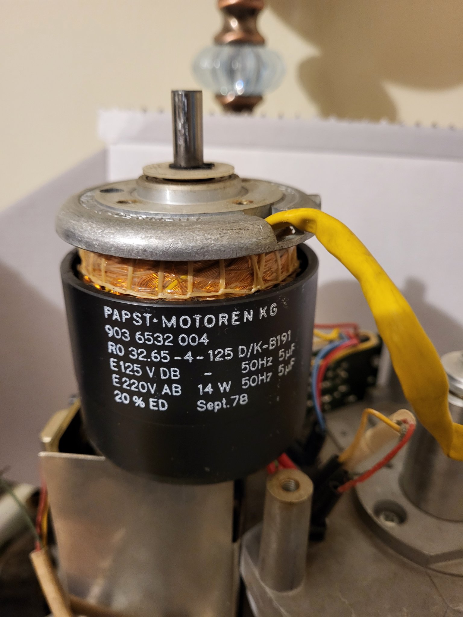

The second picture in the set of four above is less than ideal as a TT motor, unless used with a feedback loop.
As a spool motor in a r-2-r tape machine it's designed to run at varying speeds (think at the speed difference between an empty
and a full 10.5 inch tape reel.).
