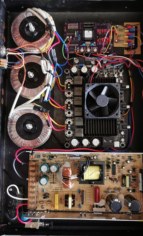

I don't think there are any AC motors with less vibration. I use Pyramid's SG4 design and even with larger motors it's almost impossible
to detect whether the motor is running or not. The downside is the inefficiency, my setup uses 3 x 80VA transformers and a 3 channel 200W
amp (Linn motor for comparison)

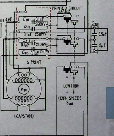

Yes, the stators of all sinusoidal-flux motors are the same but 3-phase is not a must because 2-phase is equivalent, related by way of Clarke transform.Ah yes, that's probably true for larger motors with a small number of poles and may help with smoothness, but any 3-phase motor driven sinusoidally ought to be fairly smooth due the overlap of phases - there are some 5-phase motors (steppers usually?) that take things a step further.
The reason 3-phase is so common is because it uses the wiring more efficiently - 4 wires (3 phases + neutral) carry 3 times the power of 2 wires (single phase + 'neutral'), or 3/2 times the power of 3 wires (2-phase + neutral). Assuming each phase is the same voltage and current, where P = V*I
single phase power P over 2 wires. 0.5 P per wire
two-phase. power 2P over 3 wires 0.667 P per wire
three-phase power 3P over 4 wires. 0.75 P per wire. 12.5% better than 2-phase, 50% better than single phase.
So most industrial AC motors are 3-phase, to reduce the amount of copper in the power distribution network.
2-phase is easy to derive from any other scheme using a center-tapped transformer, so wanting 2-phase devices doesn't impact the choice of power distribution much, hence power distribution is commonly 3-phase. For domestic single-phase (or two-phase) power its usual to just cycle through the 3 phases from house to house down the road to keep reasonably good balance on the phases through statistical averaging.

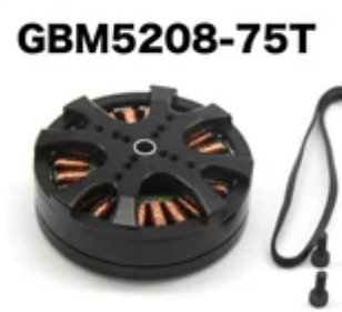

Hi all, thanks again for all the replies and discussion, it's fascinating to learn about everyone's setups etc. In case it's any use for people coming upon this thread with similar questions in the future, my current progress is as follows:
An attempt at running a 'GBM5208-75T' aliexpress BLDC gimbal motor using a simplefoc shield and arduino. I tried both open loop and closed loop with an as5048 magnetic encoder, both suffered from cogging (not smooth) rotation which is probably due to the cheap chinese motor being used in the wrong application.
I then received a BLWS231S-24V-2000 ANAHEIM AUTOMATION motor via Radwell components in the uk (an age after ordering it!), this could be driven very smoothly using the simplefoc shield but with limited torque due to the low power rating of the shield. So I have built an SG4 controller and the matching MA3D amplifier, which was always my backup plan. The setup works but I need to get back to university so I can use an oscilloscope to balance the outputs, as at the moment the motor has much more vibration than in my arduino test.
At the time of ordering the ma3d/sg4 components I hadn't come across richb's arduino controller but going forwards i will certainly have a closer look as the sg4 ended up adding up to a pricey bunch of parts! But I want to thank everyone for making these projects open source and for helping with questions as I know how much work it is. I'll post again once I settle on a motor setup

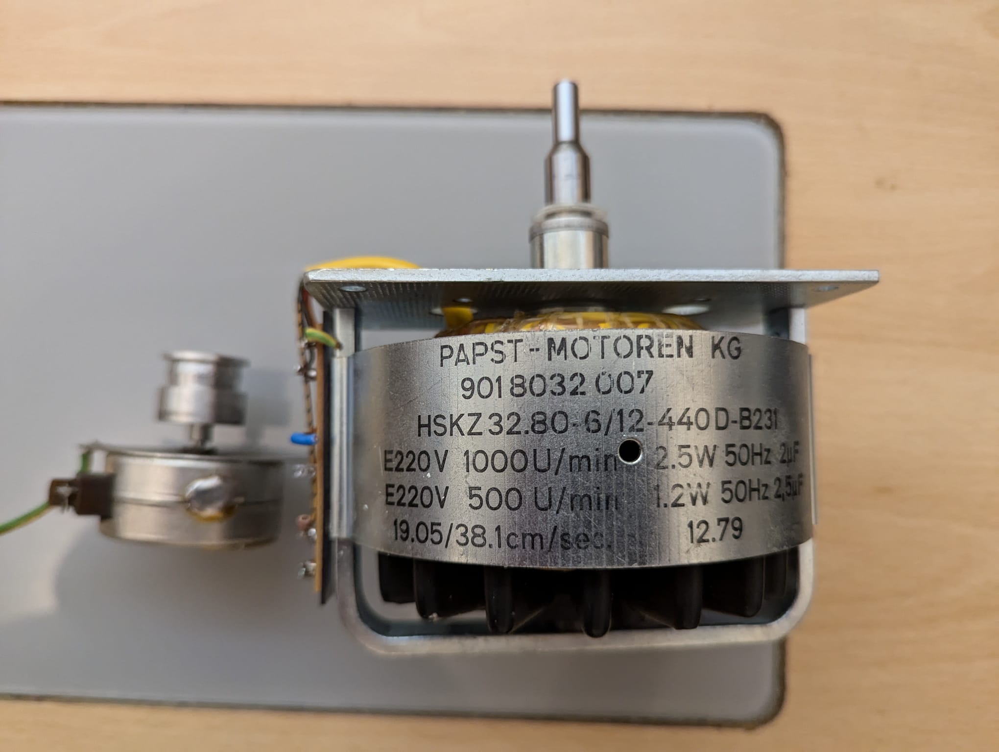

I was lucky enough to buy a few Papst Aussenlaufer motors a while ago, before they became so desirable. While some of them are the synchronous, others are 'near synchronous ', with a small slip angle. If you are lucky enough to come across one look for a part number that starts 901, these are synchronous. The 902 versions are close to synchronous, while the 903 variant is designed to be used at variable speed, for example as as spool motor on a r-to-r tape machine.
ALL of the Aussenlaufer motors I have are 3 phase delta wound, and work best when fed by a 3 phase supply, but can, as many are, be powered by a single phase supply in conjunction with a phase capacitor. This latter method is less efficient, and provides a 90* phase shift rather than the optimum 120*.
