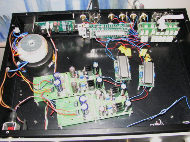

I took the time to build the seriesreg supplies and took the preamp apart to install them. The seriesreg sounds great and doesnt leave much to the advantage of the shuntregs. Actually the seriesreg sounds better than expected. Ofcourse you cant expect anything for real. Without building and listening you wont know for sure, and that was confirmed again here. The shuntreg didnt have as much impact on the UGS preamp as I have experienced with many other circuits. I still prefer the shuntreg's, but it is with a small margin. The sound is a bit more direct and unveiled with the shunt. I bet this will be a matter of taste, if one prefers the one over the other. Both are very very good, with that little edge to the shuntreg.
Hope this is helpful for someone, it took a hell of a time😀
Attached is a pic of the UGS preamp, sporting the seriesreg's in a dirty setup.

No, but it should be worth a try. I did try with a Lm317/337 as a pre reg, when testing a trafo with a too large secondary voltage at some point, and that worked extremely well. I might go back to that, when I rebuild the preamp to go fully dualmono with two trafos.
If I decide to try your idea, I will ofcourse report back.
What shuntreg did the French guy use?

Yes, Cheff’s series reg is a very nice design; I’m not surprised about your comments.
Thanks Steen for sharing results on this comparo… lots of work there.

Steen, thanks a lot for reporting. And sure it's helpful 😉 And it reminds me of an old idea I was toying with when designing the ugs motherboards : make everything pluggable : ugs, supply, relay pot, to be able to test any idea simply swapping the pcbs. A pity I was too lazy to do so...
But be sure I'll test the toolereg in a near future. I just have to find the easiest way to plug/unplug 😉
Anyway, many thanks for your hard work :worship:

You are most welcome. I was just kiddin' about all the time it took, ofcourse😉
Thanks for the link to the shuntreg. Actually I think the Toolereg would benefit from a better voltage ref, like the ones used by the Opamp supply you linked to; TL431 or maybe even better the LM336-5. Ofcourse this would mean more parts, loosing some of the simplicity and the performance is allready more than good enough. A better input CCS could probably also be constructed, so it is a never ending story..
