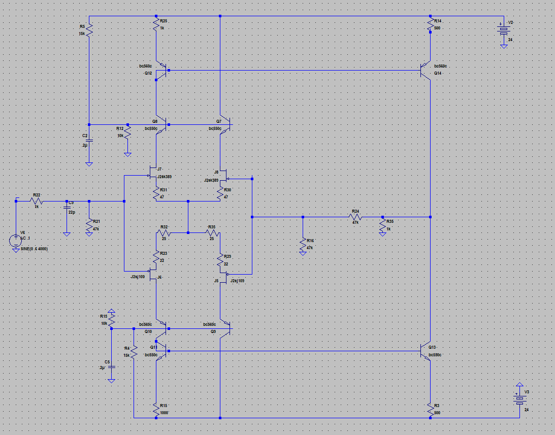

Hello R Dijk.Ever thougt abt summing differensial signal ?
Let R6=R7, R8= Ube/I (I use R7=R6+R8 as it givs mee a bether sim)
Exelent comon mode a cheap way.
While I appreciate your input, I am not qualified to investigate modifications as such. Doing paralleled JFet/BJT is as far as I can expand/alter the circuit. As far as I understand it, beyond cascoding and SuSy which this amp feature, there is no real advantage to implement a different circuit topology. It is fairly simple on its own and performance wise, with slightly better component tolerances together with better transistors (yeah I know, 2SK170 etc .. lol) I am confident that this will be a top contender.
If one design a buffer that clearly improves the performance beyond the ones I will work on and use here, then that can be an option for upgrade further down the road. If you are up for it, go ahead and design one, prototype it and report back what you find. But for now, I'll stick to the proven circuits 🙂

But you're using current amplification of 2 in your mirrors. Nevermind. Good luck.Hello R Dijk.

Btw im using it in caskode in my amp 😉
As I said, do a full prototype and then we can compare it to the one(s) which will be used, who knows what you'll find 🙂

Yea, as i said that was my starting idea.
So the next step for mee would bee a starting comparison. Before considering buffer output. etc etc and so on.
I hope you find what you where looking for 😉
Here is what i was comparing just for fun, and i realy had a lot of fun !

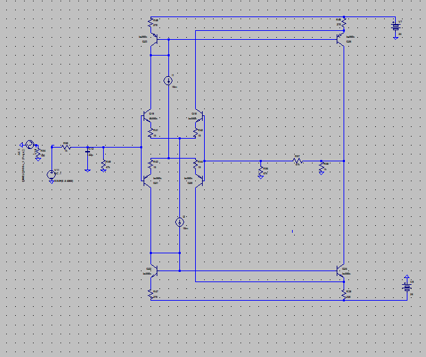

Hm... an other way is stil thinking simple. And ther is stil som werry exclusive out there. And if youre going for a exclusive.... Maybee MAT02 replacement is a starting pooint. Unless youre going smd. (Just a monemt have to check my hot air 😉 )
There is circuits werry WERRY! GOOD PERFORMANCE ! Been published in diyaudio before, cant remember the sorce,
As i said it al depends on curent sorce, more or less.
Here is the basic "otta my head"
May i say it is better than fet inputs?

Please don't spam this thread with your endless simultations in LT Spice.
Come back, when you actually have built a gain-stage with in real life measurements.
Simultations and real life measurements are often not the same, but just a start 😉
