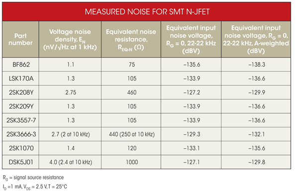

That effectively ends the notes aspect of things. The next section will cover some interesting data on the JFet and BJT runner ups.
Original JFet
Toshiba 2SK389-BL / 2Sk170-BL - Idss; 6-12mA - [Yfs] typ 22mS - Pd: 400mW - NF: typ 0,5dB
Replacement JFet
1) Toshiba 2SK209-BL - Idss: 6-12mA - [Yfs] typ 15 mS - Pd: 150mW - NF: typ 1dB.
2)
On Semiconductor 2SK3557-6-TB-E: 10-20mA - [Yfs] typ 35 mS - Pd: 200mW - NF: typ 1dB.

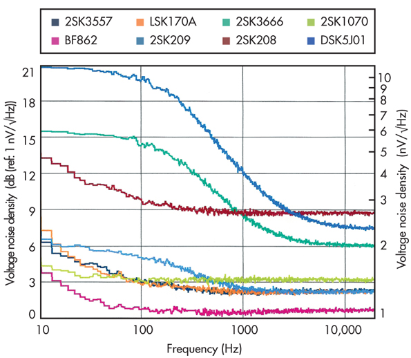

In order to keep things fresh, here is the graph displaying the performance between 2SK209 and 2SK3557. Notice that the 2SK3557 and Linear Systems LSK170 is the same.

Are you excited ? I know I am. I will eventually run simulations (LTSpice) with the replacement FETs and check what software tells me in the form of voltages, current and wattage. If the software clares the On Semiconductor, then the
2SK3557-6-TB-E is cleared for bench-top trial. This trial will be an endurance one to see how it behaves over time operating at the full voltage swing of 25V.
