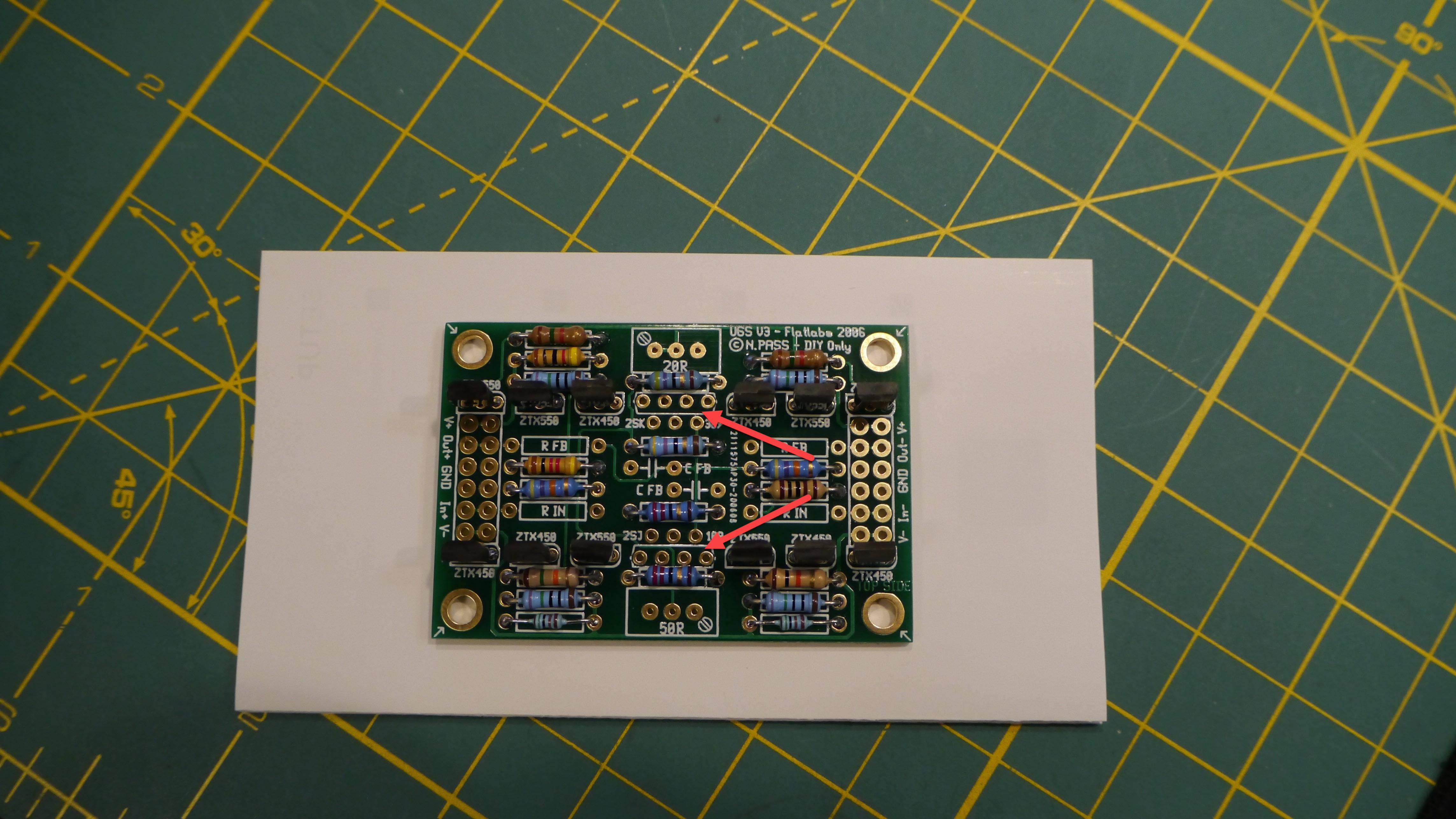

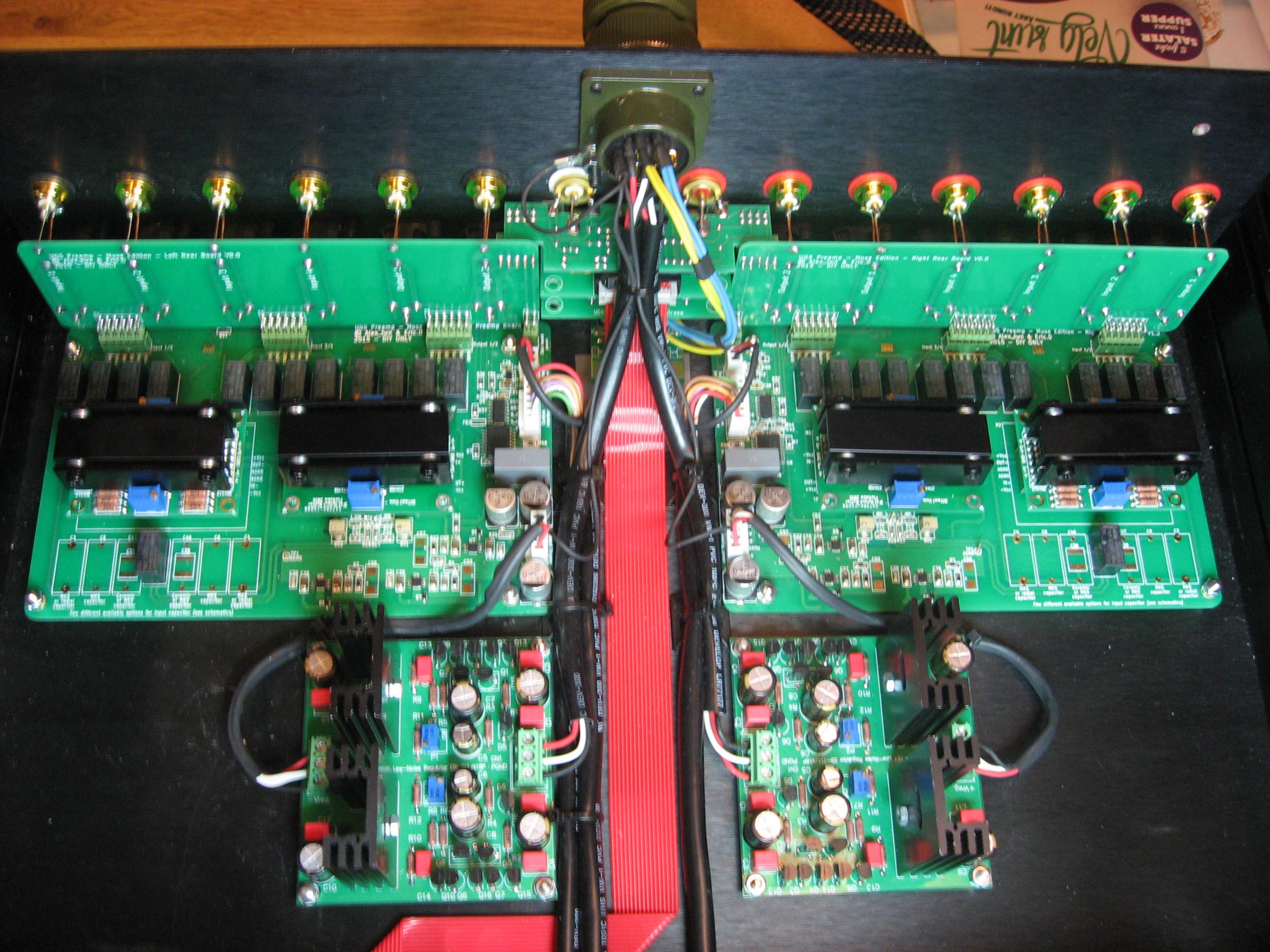

Reference the image below.
Shown using the red arrows, are 2, 4-pin device holes next to the 2SK devices. What are these used for? The dual equivalent of the JFETs I believe I remember reading in the thread?

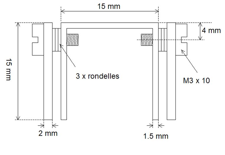

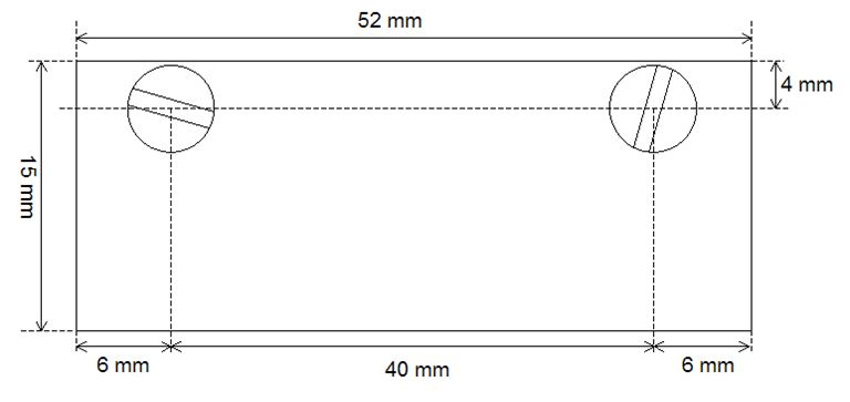

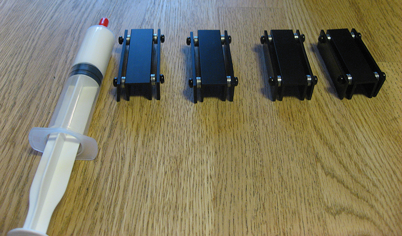

Also, show in the images on the HCFR site are silver housings around the USG modules. Are these custom heat sinks of some type, or used for stray RFI.

Ok. Do they thermally couple just the 2, 2SKxxx devices, or all the BJTs as well. Looks like the layout of the PCB was designed in fact for that? Are these heatsink 'thingies' in the BoM somewhere, or are they user, custom fit if desired? What about the 2, 4-pin devices?
Sorry for the noob questions. I just don't want to screw anything up since this is a very extensive (and pricey) project.
@group Does someone have a closeup image of the UGS modules fitted with those HS they could share?

The 4 pins you highlight belong to the JFET together with the 3 pins in front.
Dual JFET are 7 pins devices.

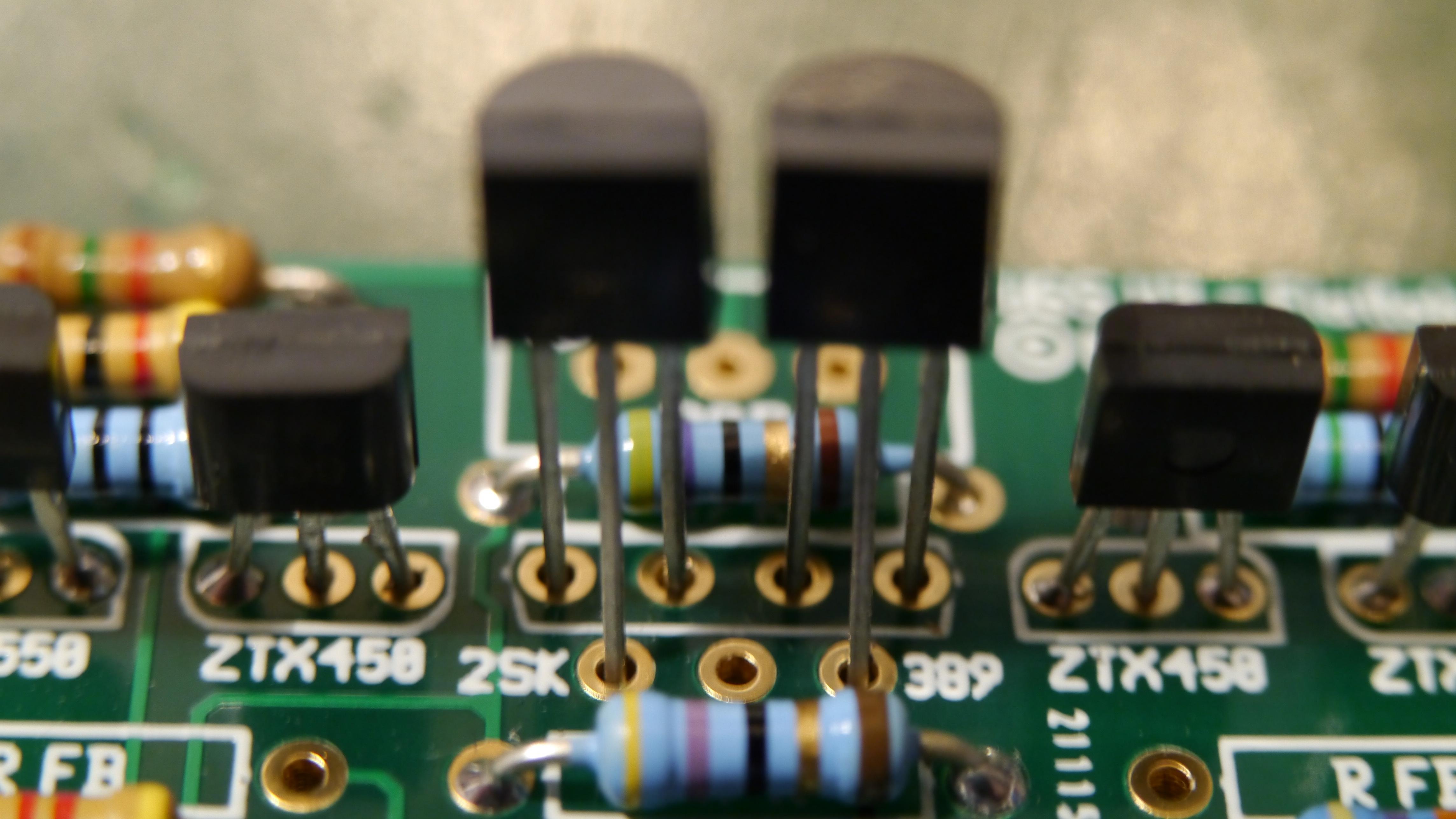

@Alex, Just so I"m clear, is this the proper orientation for installing the matched pair of JFETs on each side of the UGS module?
Hi Redjr, in my opinion not.
I never used single JFET as replacement of dual JFET, I only use dual JFET so I cannot share some experience here but when I look at the 2SK389 pinout for example it is - DGS subtrate SGD - so you have to rotate 180 degree one of the single FET you inserted here, probably the right one on the photo I would say (unless we can swap S and D on those JFET which I am not aware of).
