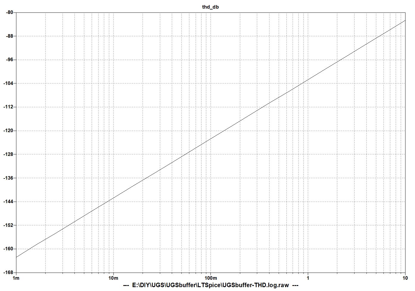

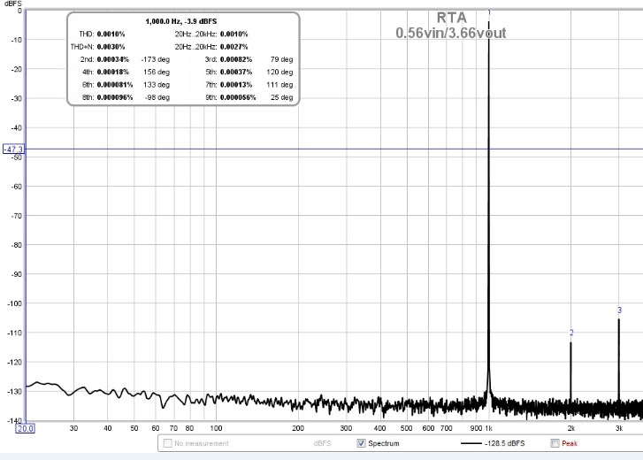

Things to know as well, is that distortion of the UGSbuffer or UGSv3 module depends as well of the signal amplitude they received (see attached spice results).
Hence why it is important to my eyes for not having a too strong analog signal at anypoint within the chain.
Things to know as well, is that distortion of the UGSbuffer or UGSv3 module depends as well of the signal amplitude they received....
... is not true for every piece of audio equipment ? bigger signal ➡ bigger distortion.
i think the most crucial thing to keep under control is the impedance that the ugs module sees at its input. must be as costant as possible hence. the muse chip varies output impedance... so, i personally will not put the gain stage after the volume. but rather, in front.

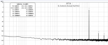

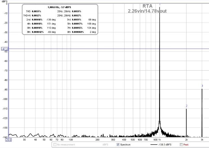

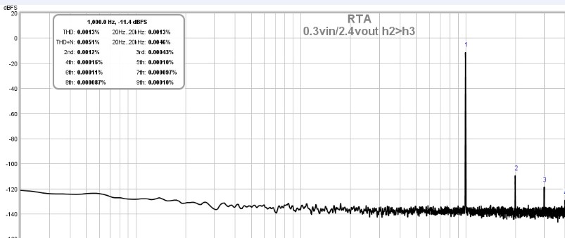

I don't like that H3 is higher than H2 but the overall distortion is so low that it shouldn't be noticeable.
Well...I can tell you one small secret, I actually can adjust h2 vs h3
i guess is all a matter of balancing current between the N-ch an P-ch fets

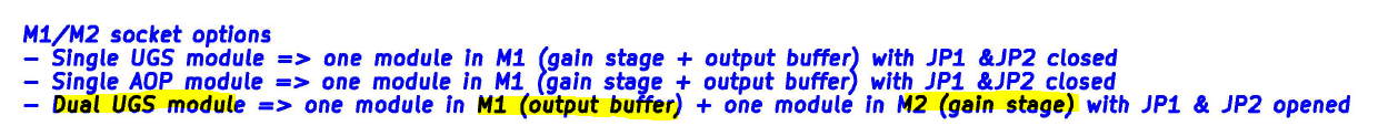

btw... if i am not totally mistaken, i was reviewing the schematic and seems that the preamp follows this very routing.
with two ugs module, first it gets "amplified" then it goes to the muse volume controller and at last, inserts in the buffer before exiting.
and that make the most sense to me
The schematic only shows that a UGS module can be placed in either M1 or M2 socket.
There is no distinction made between buffer and UGS module within the schematic.

in the schematic is reported where to put what (see attached). and from what i see M2 is before the Muse chip and M1 is after.The schematic only shows that a UGS module can be placed in either M1 or M2 socket.
I assume that is the "default" positions, and nothing prevents you to swap them, sure... but i guess there's a reason behind the decision to have the gain module in front and buffer as output.

Small gain mismatch does that in differential mode.Well...I can tell you one small secret, I actually can adjust h2 vs h3
