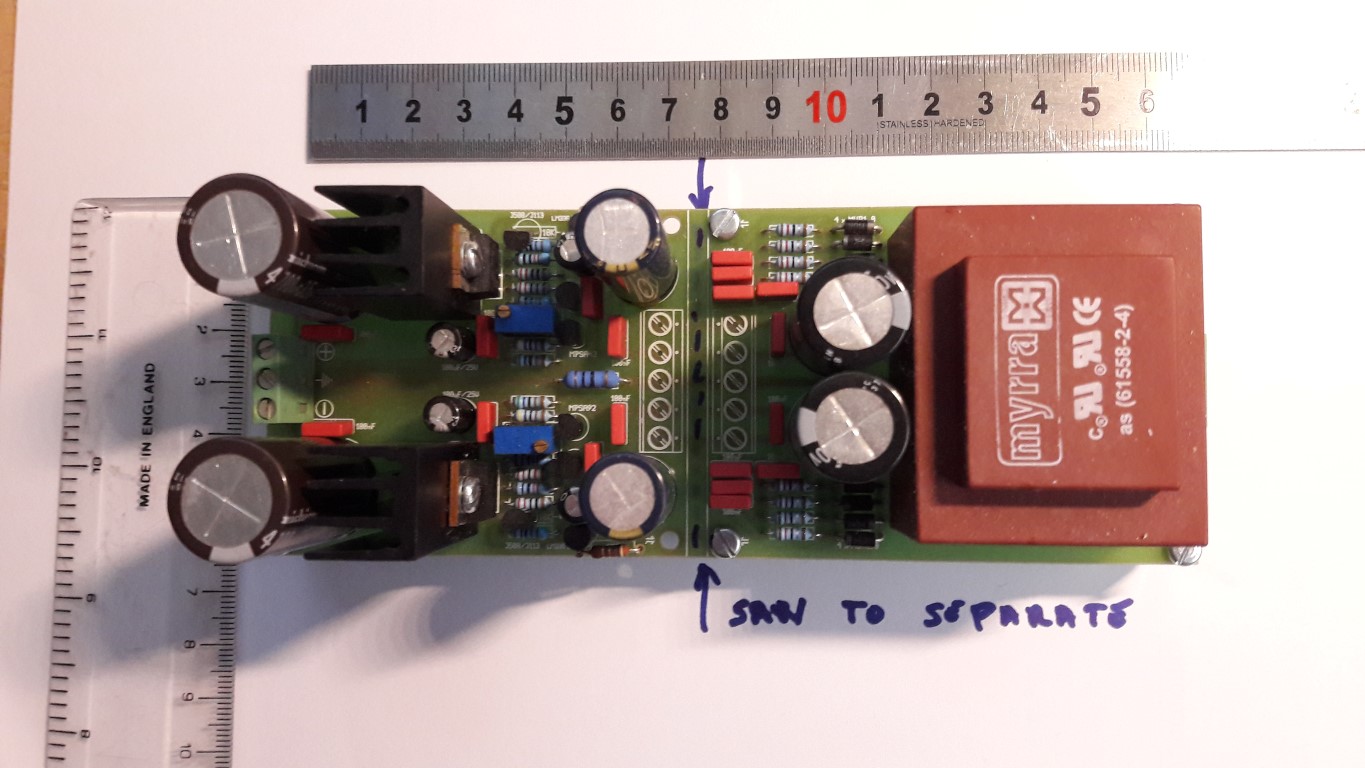

I am on the list to purchase the set of PCBs. I have opted for option 1 and 2. Are options 3 and 4 needed to complete UGS preamp?
No. Option 4 is the original PSU and is set up for board mounted transformers which are 220V only (EU). At least without modification. Not sure what Option 3 is exactly, but I believe Options 1 and 2 supersede it. Eric can correct if I am wrong on this.I am on the list to purchase the set of PCBs. I have opted for option 1 and 2. Are options 3 and 4 needed to complete UGS preamp?

This is correct.No. Option 4 is the original PSU and is set up for board mounted transformers which are 220V only (EU). At least without modification. Not sure what Option 3 is exactly, but I believe Options 1 and 2 supersede it. Eric can correct if I am wrong on this.
Just to clarify what is option 3. It is a +/-24V low noise adjustable linear supply that could be used as an alternative to the Salas shunt regulators (option 1).
With the UGS muse, the PCB has to be sawed as shown (or alternatively you can just leave unpopulated the right part of the board (transfo, rectifiers, ....).

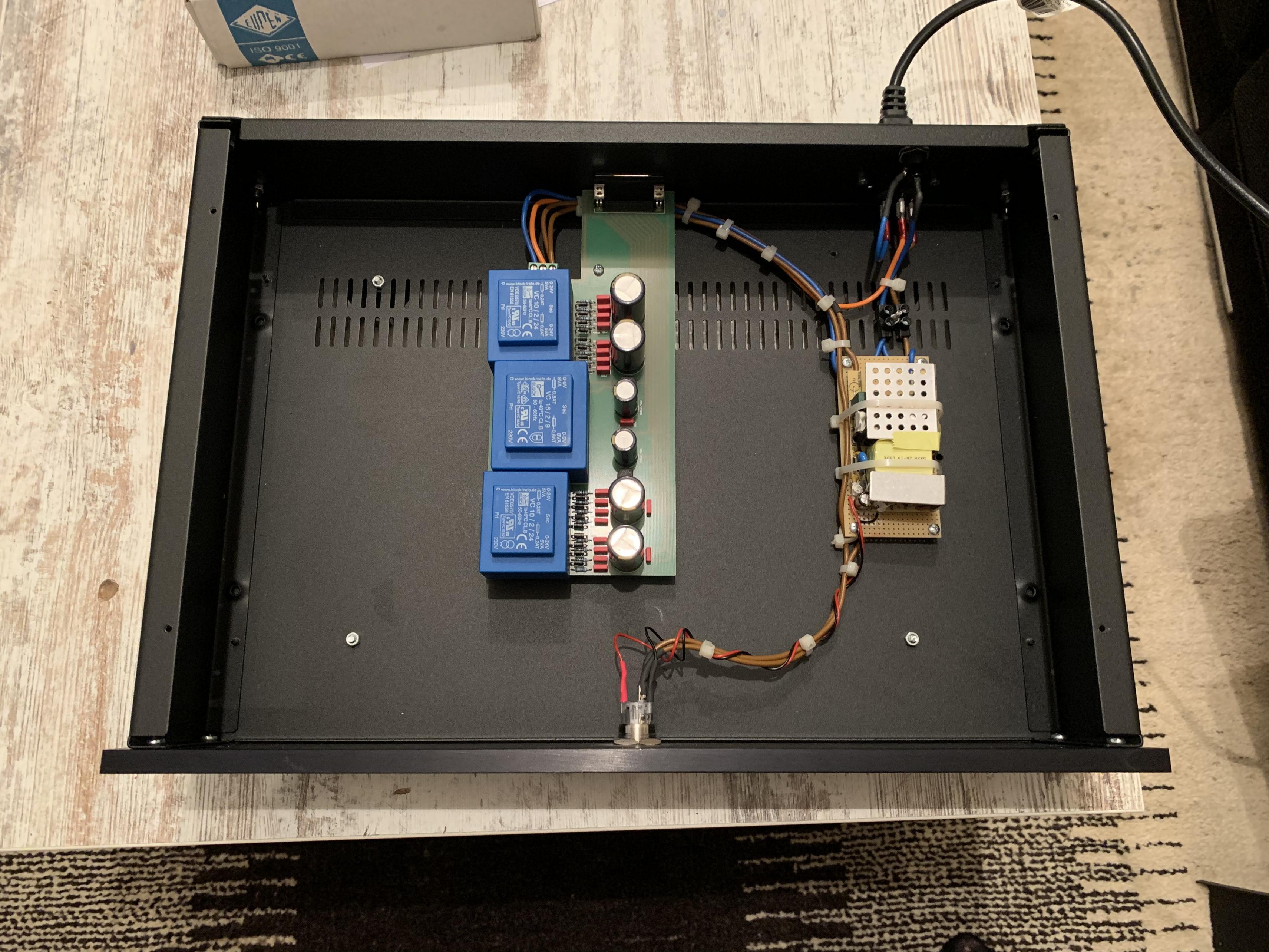

and here is option 4. external psu with transformers and rectifiers. just the left print...
Perfect thanks for the clarification. I also left on my preamp the PCB unpopulated on the transfo & rectifier side, easy approach.
