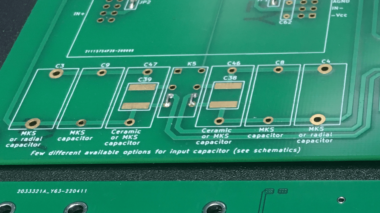

Wondering what kind of input capacitors are you guys using on the preamp boards?
Positions C3/C4, C8/C9, C38/C39, C47/C48... Thanks.

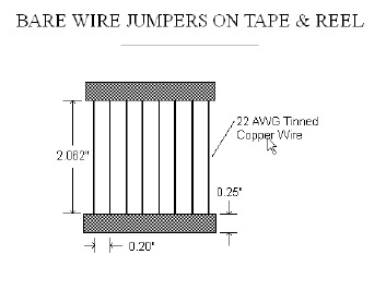

"bare wire jumpers"... ?Don’t know about others but I use this type. I think they are the best that can be used.
When I assembled my preamp pcbs I found many comments about using wire bridges in place of the input coupling caps so I followed those comments in my build. Check K5 in my attachment."bare wire jumpers"... ?
Ok, got it.When I assembled my preamp pcbs I found many comments about using wire bridges in place of the input coupling caps so I followed those comments in my build. Check K5 in my attachment.
So you are basically not using any cap and thus bridging the relay.

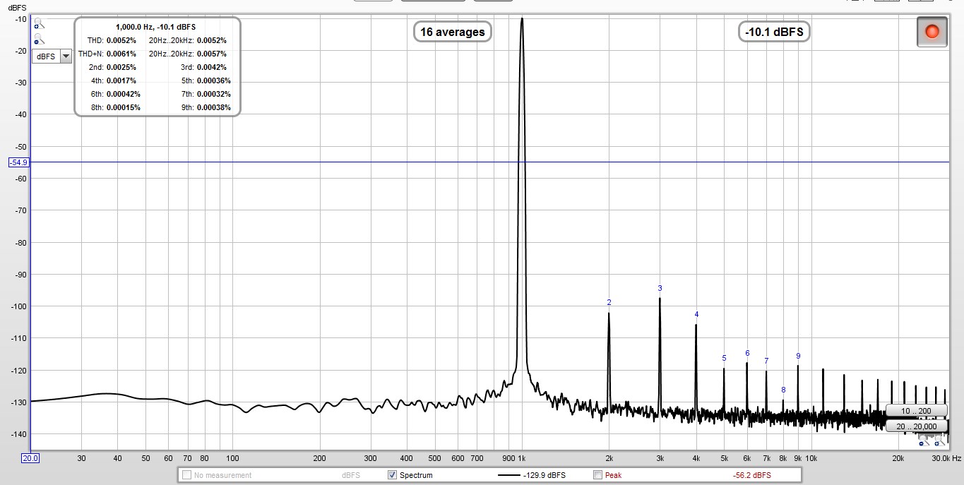

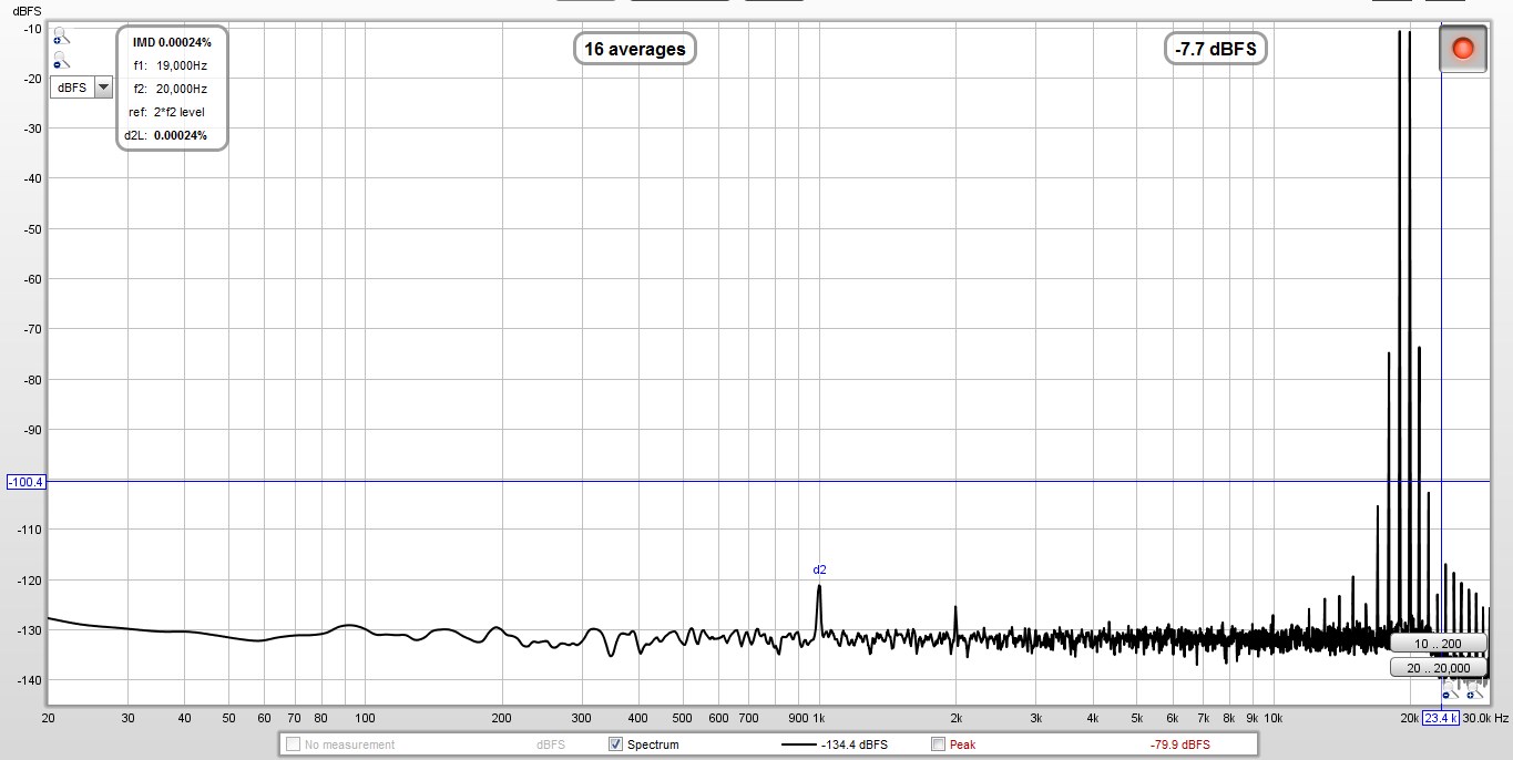

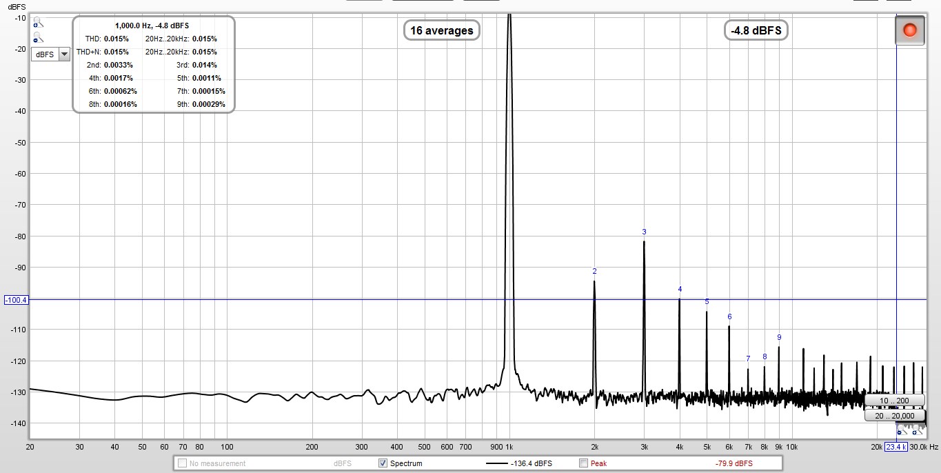

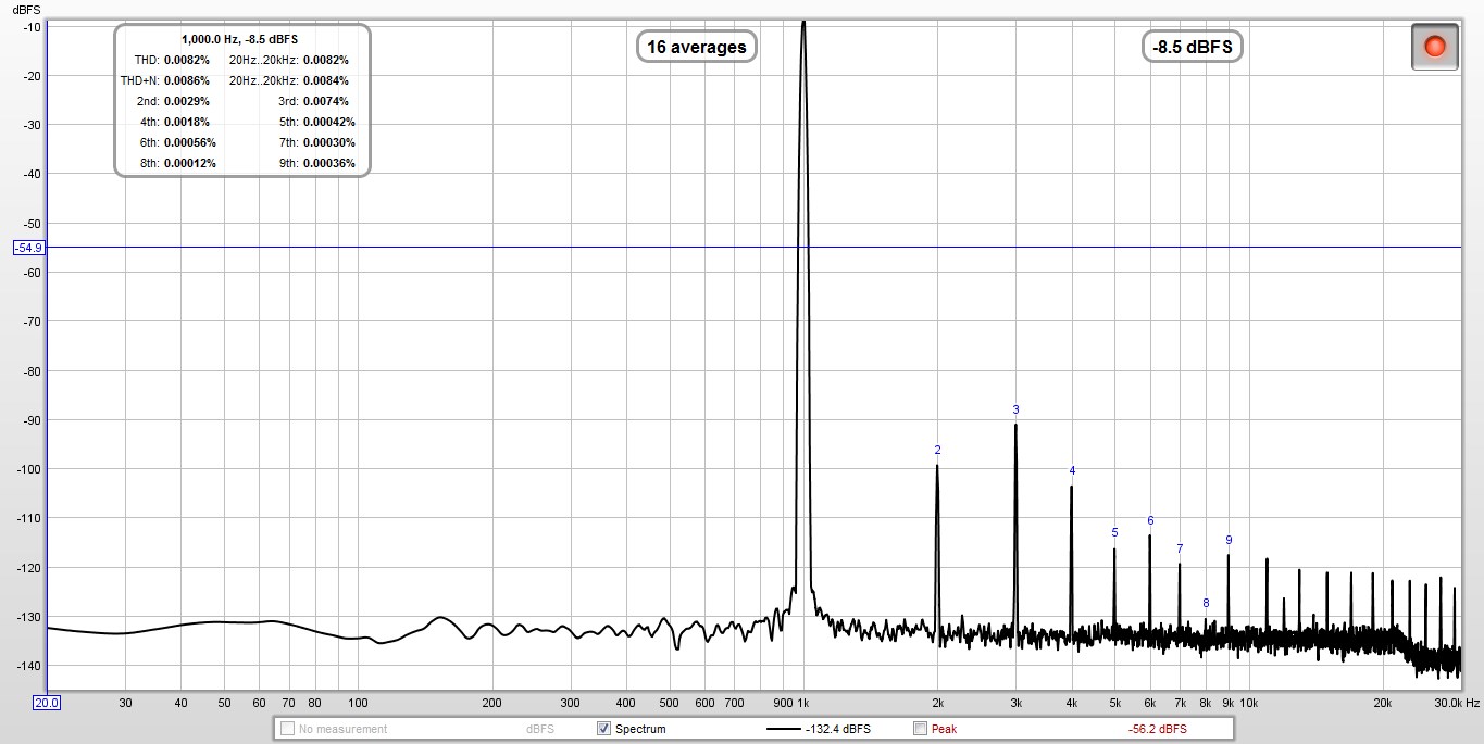

Lately on the forum we got a lot of designs of power followers that need a low impedance source capable to drive 20+vrms at low thd levels.
I am looking at those designs for a long time now and I always had in mind to have a preamp with those abilities.
Well seems that the ugx is able to drive a few volts in a 1k load.
Today I did a small test.
The pre was connected to a rme dac and as loading on the output I used a 1k resistor(connected between out+ and out-) and also the focusrite adc.
I will attach some screenshots of how it went. I have the option to use switchable gain and the preamp was set for 3x and 6x.
1st attachment 2.3vin/7.5out
2nd attachment 2.3vin/14vout
3rd attachment 3.5vin/21vout
4th attachment 3.5vin/21vout
5th attachment A BIG THANKS to all specially to Papa!

Got it. So you basically eliminate that additional relay in the signal path and don't use any capacitor.When I assembled my preamp pcbs I found many comments about using wire bridges in place of the input coupling caps so I followed those comments in my build. Check K5 in my attachment.
The relay can switch the capacitor off, but stays in the signal (of course) all the time... Thanks for the hint!
It mostly depends if your source exhibits dc offset. If you think you will have the possibility to encounter such situations it’s better to have those caps there because they add very low thd and will save you some trouble.
I have as a signal source only the rme dac which can be dc coupled. Also to mention that my gain module can take a dc offset of a few volts so I don’t think I need the input coupling caps.
So in the end it depends on how much you want to risk it and if it’s worth it.
Try both and see if you notice any difference and if not you can leave the caps in. My guess is you won’t notice much.
