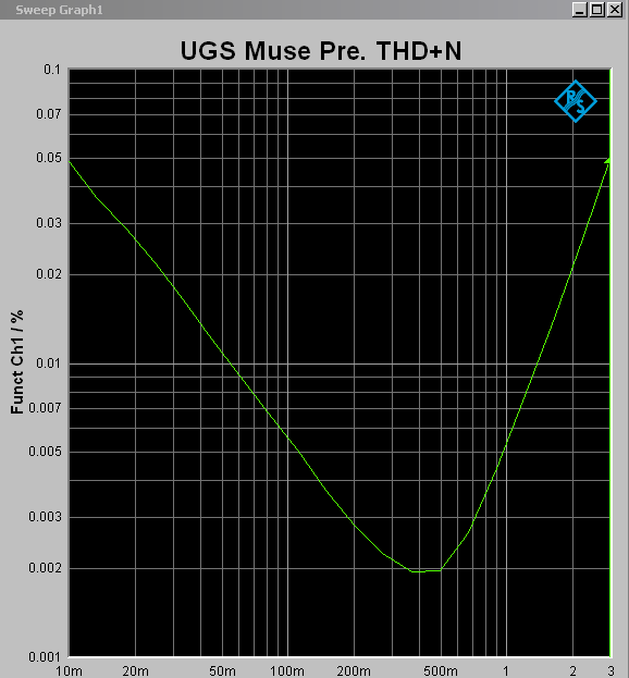

UGS THD+N curve
I have measured the THD+N on the UGS gain buffer.
This measurement is done with a high quality R&S UPV audio analyzer.
We can see that the noise level is very good, but distortion starts to rise above 600mV and ends up at about 0,02% at 2V RMS.
This is certainly acceptable, it would be nice if there is a way to keep distortion lower up to about 2V.
Does someone have some advice they could share?

Just a remark. This UGS version is run at +-24V supply. Usually Pass Labs runs them at +-32V. Maybe the supply has an impact to where the sweet spot is localized. If you look at the original XP30 THD (from Stereophile reviews) you'll see that the minimum THD is higher in voltage, around 5V...
Also I don't know if your measurement was done SE or BAL. Balanced should be better because of the X architecture that should cancel distortion even more.
Finally I don't know if this preamp was modified to replace the output resistors from 1K to 100K. Alex realized it was an error to have these resistors at 1K (R29-R32). They load the UGS too much...
Thank you for your remark. The measurement was done balanced.

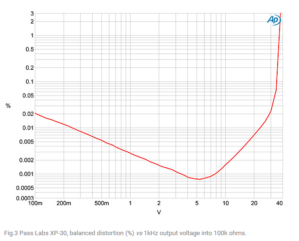

1V pK/pK or 1V RMS ? The Pass Labs XA160.5 is rated at 1.79V (26dB gain) for full power. I think that papa once mentioned that he always rates his amps at RMS ? Is this correct ?

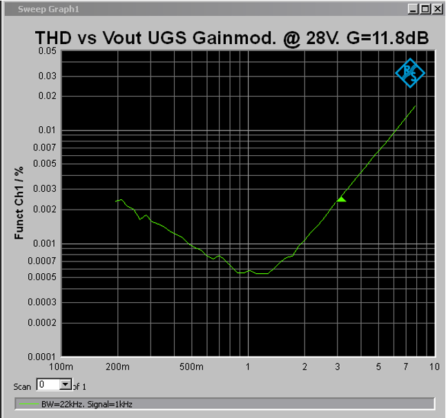

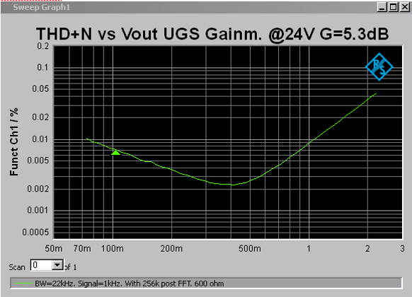

UGS gain module and buffer module measured
I have taken out the gain module and measured it standalone with a variable power supply. Balanced.
This is a THD curve with 24V rails.
Increasing the rails to 28V did not help at all.
We can see that the distortion is all 3rd harmonic.
With these results it is not wise to use this module with this gain at the input. Imagine what would happen if you connect a balanced source with 4.6V RMS output like the Electrocompaniet DAC. The gain stage would bring the voltage up to 18V RMS and add massive distortion before entering the volume control chip that would have to take the voltage back down to normal levels.

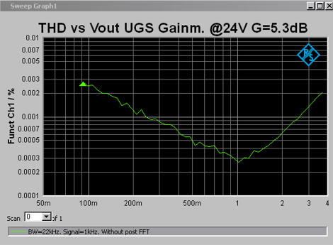

I have reduced the feedback resistor to 30k for a gain of 5.3dB (1.84x), and the result is better.

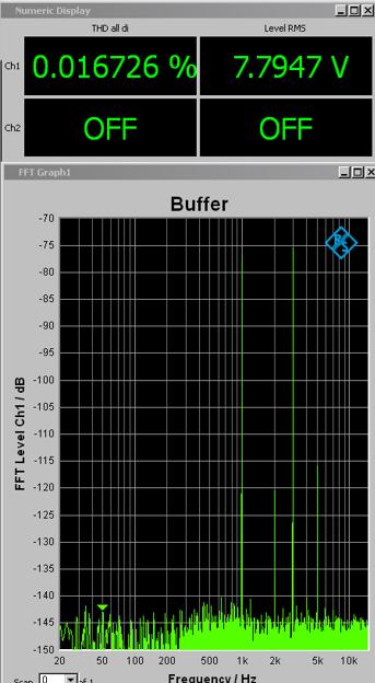

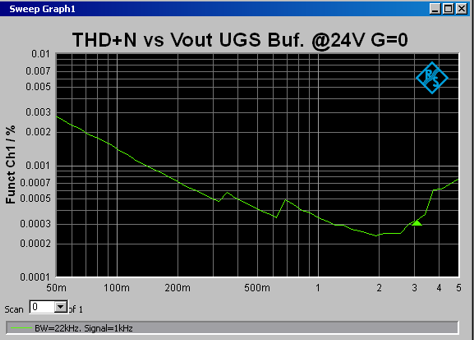

Buffer

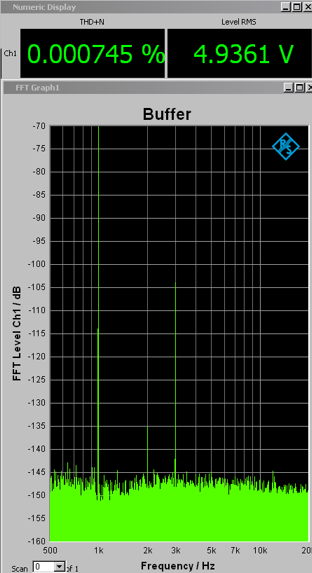

The buffer module is much better.
This is a THD+N as opposed to the THD measurements above. We can see a slight increase between 3 and 5 volts but otherwise this module matches the internal noise in my R&S UPV measurement equipment. (It is equipped with the "low distortion" generator)
At 5V we can see that it is the 3rd harmonic that start to rise.
I can't help to think that it would be better to use the buffer module on the input before the volume chip and use the gain module after the volume chip.
In that case we would get the best from both modules. Low distortion from the buffer on the input up to the voltage swing we have from balanced sources (up to 5V). The volume chip will lower the voltage to whatever desired voltage and then the gain module will work in its more comfortable 0 to 3V range. Most power amplifiers do not need more that 2V to bring the output to clipping.
Thoughts?
Buffer
Thoughts?
Buffer
Thoughts?

I am not convinced the buffer on the input is needed. The volume controller chip represents a linear 20k resistive load and I don't see that this can cause problems for any source.
My thoughts is that the output buffer is not needed either. We don't have long cables and the power amp input resistance is 20k.
I measured the UGS gain module into 600 ohm load and while it certainly had a little problem with that it was still acceptable.
With this result into 600 ohm it should be perfectly capable of driving 20k.
The balanced topology leaves out 3rd harmonic résidus at the output, by design. And almost nulls out 2nd
We can see that the 2nd harmonic distortion from the gain module is nulled out, but we have a lot of 3rd harmonic. How can this be then? Both modules in the amp are like this.
