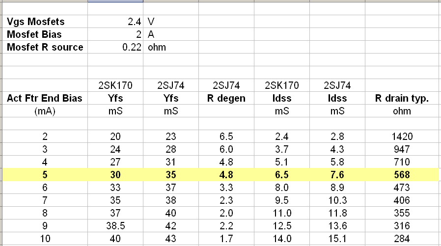

UGS using k170 and j74 with matched curves
If we use k170 and j74 Instead of k389 and j109
and to follow Patrick recomendation for matching curves of k170 and j74 can we use for j74 Rs resistor value 24.3 instead of adding 2.3 degen resistor to original Rs of 22 R
(using j74 with Idss 10.5 and k170 with Idss 9.5)
I'm not sure I understand.If we use k170 and j74 Instead of k389 and j109
I thought that the Euvl design and measurement showed that better matching of the N & P channel curves was achieved by adding an Rdegen to ONLY the P channel device.
i.e. the Nchannel is selected for a particular Idss and then the matching P channel had the higher Idss and this needed the degeneration resistor added to the Source lead of the J74.
Using the yellow highlighted line:
Select an sk170 with an Idss near 6.5mA. This is used without any degeneration resistor.
Select an sj74 with an Idss near 7.6mA This needs a 4r8 degeneration resistor on it's source leg.
When this combination is operated @ 5mA of Id, then both devices have an effective gm=30mS
thank you for reply Andrew
original UGS using 22 R as source to P channel j109 as Is In first post
If we choose j74 with Idss of 10.5 and k170 with Idss of 9.8 we need R degen of 2.3 R added to 22R which gives total 24.3 R
the Euvl tests & measurements applied when there was no Rs on the N channel device.
He published his report showing how adding an Rs to the Pchannel device corrected for the excess gm.
You are looking at a different situation where the Nchannel has some degeneration, actually more rather than less, so I can't understand how you arrive at adding 2r3.
I don't follow how you came to your proposal.
from Euvl table I took Information about jfets Yfs, Idss, R degen
I am not Interested at all about yellow line which Is someone else choice, not mine
If I like to use p jfet with 10.5 Idss I can see that I need to use 2.3 R degen to j74 together with k170 with 9,8 Idss
that Is how I Interpret table, am I wrong ?
I think you are wrong.
If you have two jFETs with Pch Idss=10.6mA & Nch Idss=9.8mA, then you are close to line 6 where the Id should be set to 7mA, or very slightly above.
Add a degereration resistor of 2r3 to the Pch ONLY. There is no Nch degeneration and you end up with a gm for both P & N channel of ~35mS
The circuit you are using is different from that. It shows degen on the Nch of 47r and Pch of 22r.
I cannot see how you should apply Euvl's table to that arrangement.
