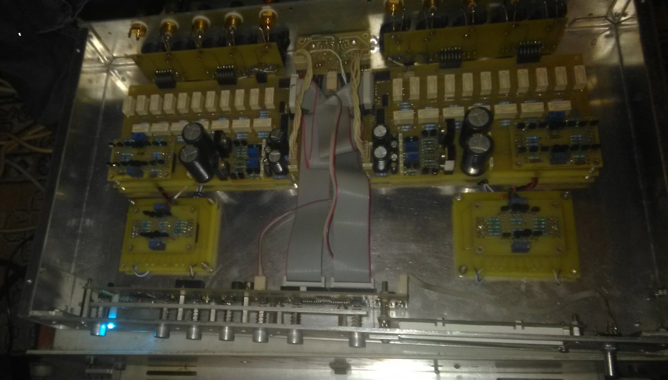

Its about Rout on UGS module. Default is 1k, input impedanse on attenautor is 10k total 0.9. Second picture explained Rout about 100k, total is 10K, but look for total distorsion. Extra.
Buffer is for classic version. Setup is ugs module and than attenuator. Resistance on output is to high for next step, buffer on output behind attenuator.
buffer on output...
final step will be Rout on UGS module and than measurements :)
