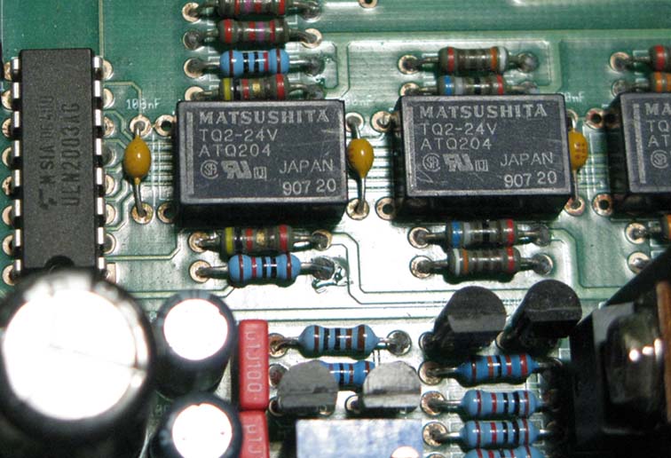

chalkandtalk said:On the carte mere there are lots of relays for volume control and switching input. However, I can't find any reference to these on the BOM. Does anyone know the Farnell part number for these?
You will want to use Matsushita TQ2 Voltage is your choice.

I used OMRON G6S-2 series 24V in my UGS. pinout is different, but the PCB has the holes (it supports different relays pinouts).
be warned that µC supply voltage is derived from the relay supply voltage. It means that for 24V relays, good heatsinking is needed for the 7809 logic board pre-regulator or thermal protection may be activated... Although this is not a problem nor a reliability issue 😉

Which power transformer is everyone in the USA using for the UGS?
PCB mounted with dual 24v secondaries.
there is 3 xformers on the power supply board.
the 2 small ones are 2x24V and they are dedicated to the 2 UGS modules.
the middle and big one is for the digital section, aka µC board and relays. for that one, you choose the woltage depending on the relays voltage, but with a minimum of 2x9V (minimum is the logic pré-régulator, the 7809).
