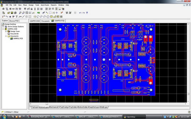

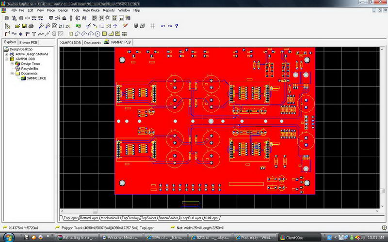

My UGS module
UGS module with complete (input / output) balanced.
I used 2n5457 / 2n5461 instead of 2sk389 and 2sj109 and used irf610 / irf9610 instead of zvn3310 / zvp3310.
Its has some problem waveform from high prequency oscilation above 45KHz but if I use for typical amplification case, there's no problem !

Re: My UGS module
Not a good idea. That sort of thing can destroy your tweeters.
Grey
