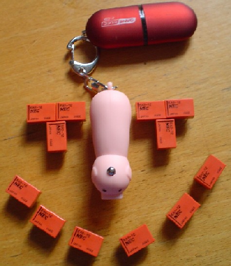

We are waiting for Vmoreaus green PCBs, but we already have the multilegged bestioles,
in red,
in order to erect a technicolor monument to cheffs Kunst.
in red,
