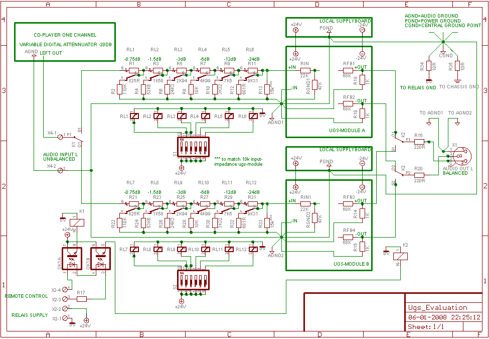

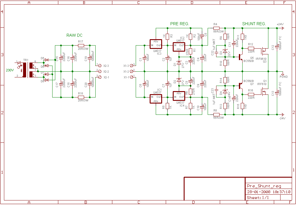

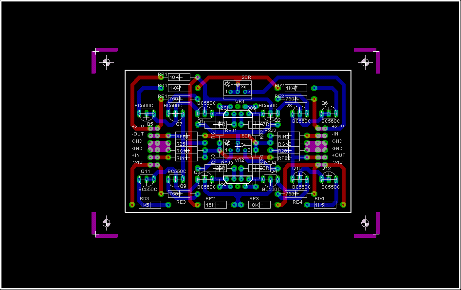

Hello Gents,
We all know that the UGS-module is very popular in France but i have some problems with the language. Four years french at school wasn't enough.(ok my english is also sh.. i know)
Maybe someone can give me an update? It's still V3...or there are some new french tweaks?
In the attached file you can see my approach of cheff's design.
In fact i build 4 units and a special evaluation board to make a A/B comparison possible(with remote control). Every unit has his own supply. It's a kind of sandwich.
The idee is to test a lot of parameters to get the best result.
I started with different 'regulators(in the first setup was everything the same).
The printboard of the module is a little bit different. I little larger and more air between the traces. Also the routing is sometimes different. It's easy to make such boards at home. It's not so tinny.
Any commend? suggestions?
Gr.
Johan

Re: Dutch UGS-sandwich
Actual version is V3.
manu
edit : You choose BCs instead of zetex. Since thermal coupling is important the shape of Bcs could be an issue.

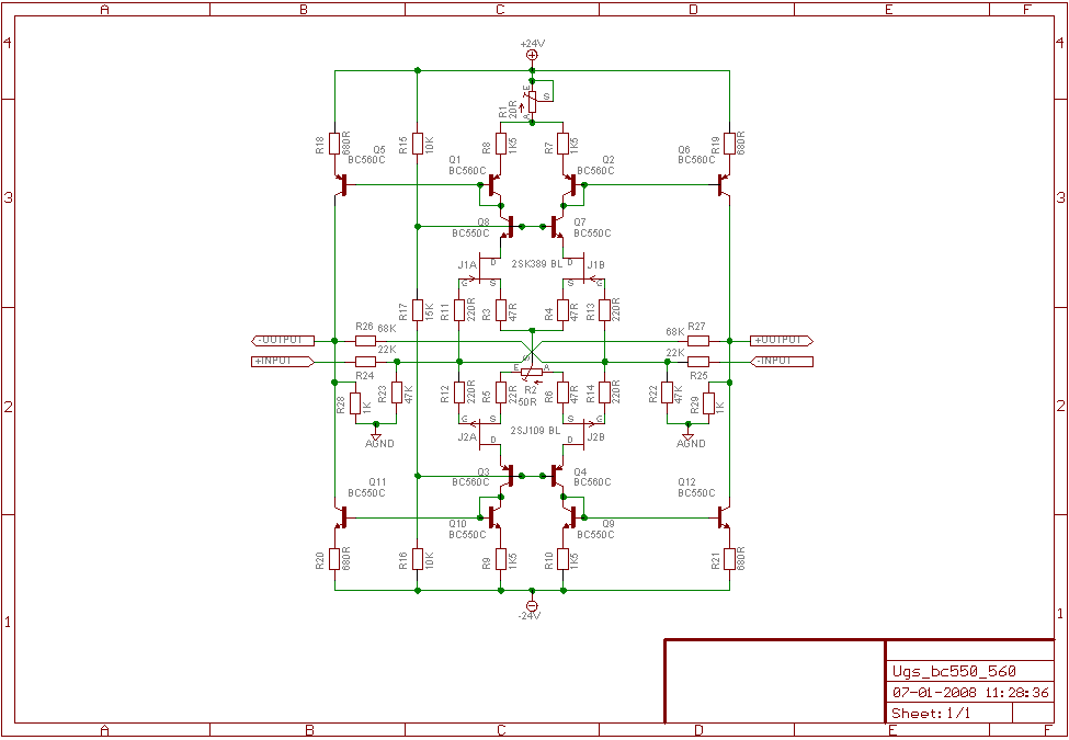

bc versus zetex
Hi Manu,
Thank you for the quick update.
Yes i know the dimensions of the zetex part fit better with the dual jfets. But i build one board first to check the DC-stability and even without the thermal coupling it's wonderful, really wonderful!
I don't become nervous of +/_ 1mV and my Aleph5 has input cap's i think.
BC550/560 components are very easy and cheap in the Netherlands. I have no idee if the zetex parts sound better?
Did anybody test it?
Gr.
Johan
