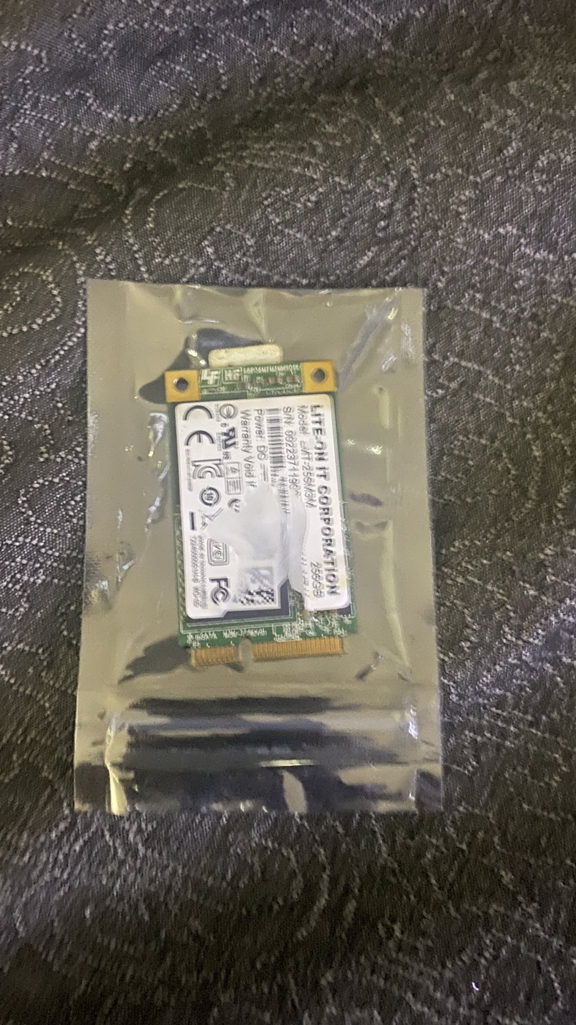

There is also a hardware-only method. If you can physically remove the SSD from inside the laptop (check that you can actually open the laptop, the housing is not sealed, and the SSD isn't soldered to the motherboard!), you can buy adapters that let you plug the SSD into one end, and a USB cable into the other. Basically the adapter turns an SSD into a USB3 external hard drive.
So if you get one of these adapters, and you have access to another computer as well as the failed laptop, then you can plug the old laptop 2.5" SSD into one of your other computers via a USB port, and simply copy the files off it just as you would do with any other USB external drive.
Here is an example of this type of adapter: https://www.newegg.com/p/36F-00MF-0...op_ssd drive cable-_-9SIAPY9EDG7847-_-Product
It is possible your laptop doesn't contain a 2.5" SSD. It may contain a more exotic type of SSD: https://xoptimum.com/types-of-ssd-for-laptop/
If this turns out to be the case, look for a USB adapter that will work with whatever laptop SSD you actually have.

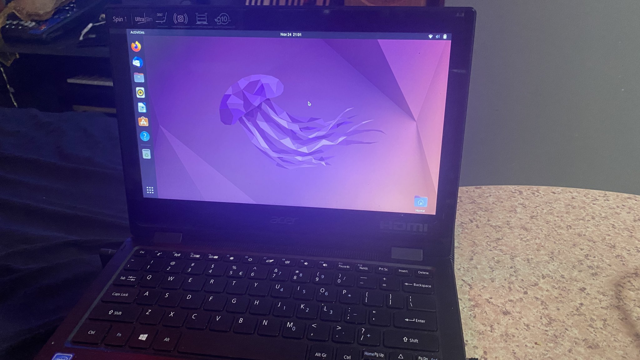

Tried the boot stick on my wife’s netbook. This was a late 2019 windows 10 machine. A day prior to my laptop dying, this netbook had gotten stuck in boot loop
Did a clean install after booting from the stick
I think this one is sorted for now. Now to try getting the files of my old machine. Thanks for the assist gnobuddy

Looks like it worked! 🙂Tried the boot stick on my wife’s netbook.
But no reboot loop when booting from Linux, correct?A day prior to my laptop dying, this netbook had gotten stuck in boot loop
So the netbook hardware is fine. It was just Bill Gate's turd of an operating system that caused the endless boot loop problem.
Clean install of Windows, or clean install of Linux? Just curious.Did a clean install after booting from the stick
IMO Linux and old netbooks are a wonderful match. Linux runs much faster on the weak CPU and limited RAM these little computers have.

Hey man, I did a clean Ubuntu install. The crazy thing is that I needed a working computer to get other computers working. The flexibility of a regular computer is amazing. Windows evolved to XP where it just worked hard without giving any trouble and gave user ability and access to anything. 7 was polished, then we wanted windows to be like tablets and phones and windows went dumb and stupid on us. Whatever version of 10 that I am on in the new pc, feels a lot like 7Looks like it worked! 🙂

A side project for computer rebellion. I have a surface pro from 2019 that I can’t restore due to a biz type security settings. If I can get Ubuntu on this, then with its powerful hardware, it will make a good platform to see if it is possible to configure Ubuntu to my use and then I image it
Workstation PC replaced. Old user data recovered. Back to work on the Uffornica project
