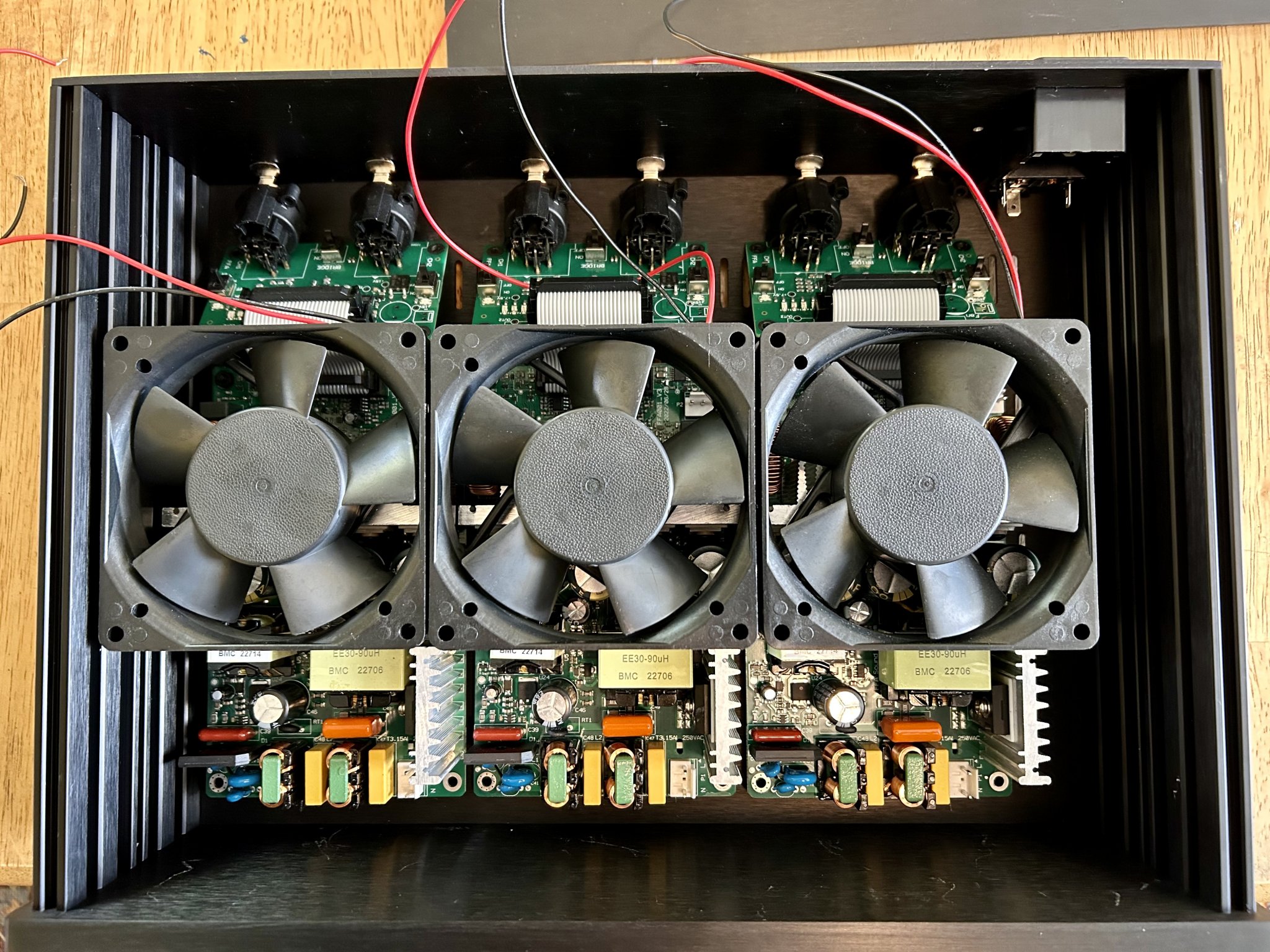

I’m putting three in a Galaxy 2U 230 chassis from the diyAudio store. Barebones build. Short standoffs, one underpowered fan per module over the heatsink, IEC mains and switch at the back. I’ll be using it for 3-way crossover work with DSP. I know it will sound good based on using one module for a couple weeks in my main system.Yes, that was a good pickup. How are you fitting this amp?

And I hope you don't mind some questions. Air routing, in and out, how are you implementing that? That case has good space for those three boards and some for the 5.1 decoder board that I am using. Good potential to build an HT receiver for folks
No worries. I ordered the full vented top and bottom plates for the Galaxy 2U 330x230 chassis. Plenty of holes for airflow. Note that there is just enough room for this setup. If one wanted to add more things in the chassis, I would recommend going up a size to the 280 mm deep option for more wiggle room. I had considered a shoebox-like arrangement in a narrow 3U with the modules stacked or on their sides, but I prefer this layout. More than three modules would require 3U or a much wider 2U chassis.
I will test with the fans blowing downward into the modules first. If the modules still get hot, I’ll try the fans in the opposite direction. If needed, I’ll try up and down, too. I doubt I’ll have any heat trouble, regardless. In open air, one module equilibrated at about 50C on the bigger sink, so I expect just a little airflow will go a long way.

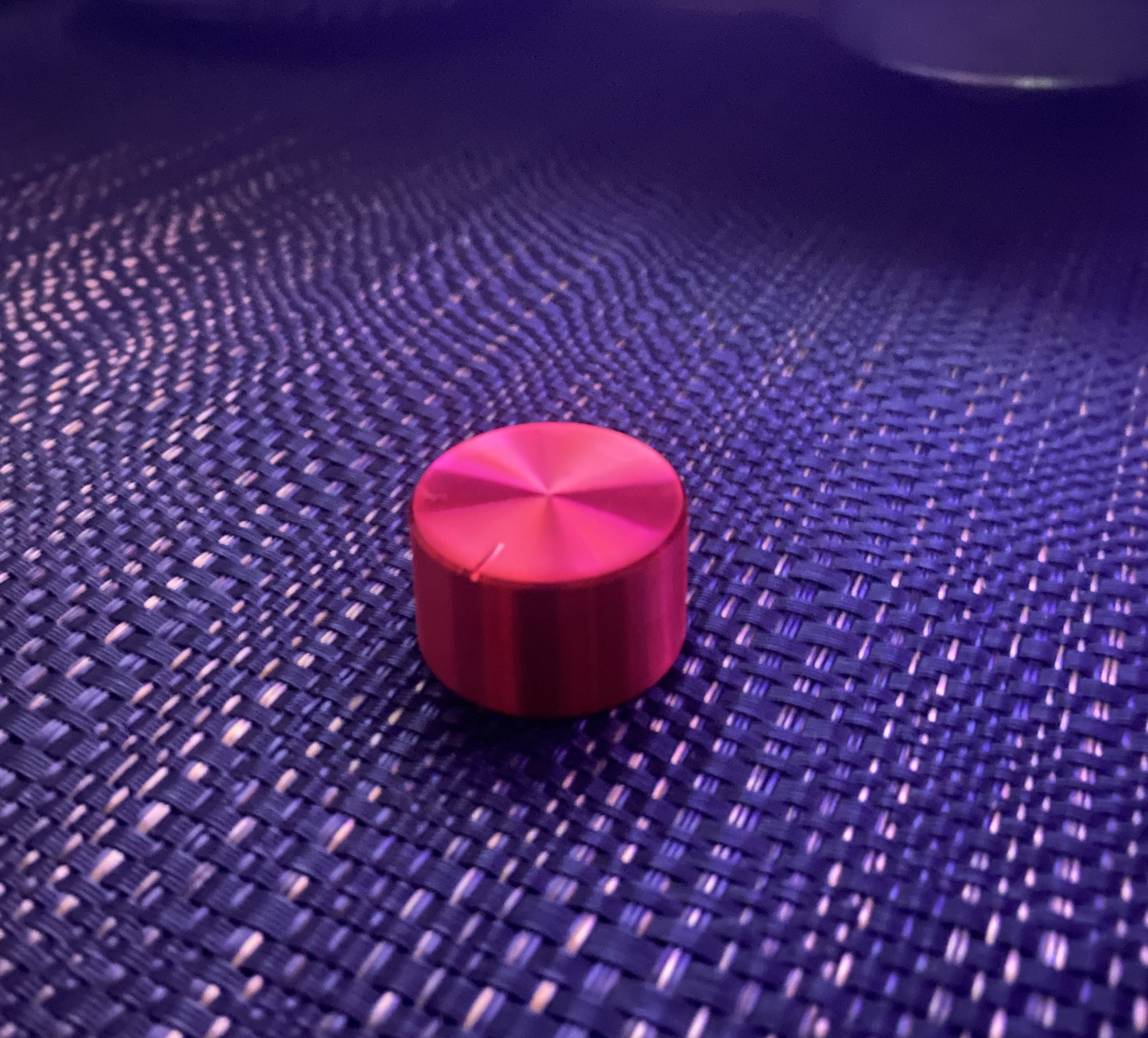

The master volume knob for Uffornica arrived. I don't know, it doesn't look as glittery as the pics in the ad
https://www.aliexpress.com/item/4000027545583.html?spm=a2g0o.order_list.0.0.411d1802UaaCs0
It also feels smaller than I expected and feels too light. I'll have to make one to suit

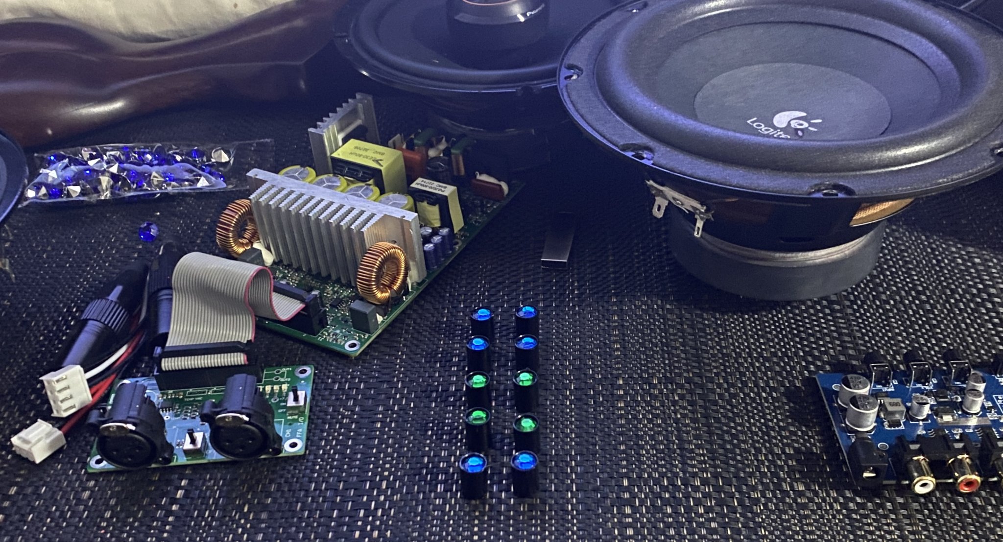

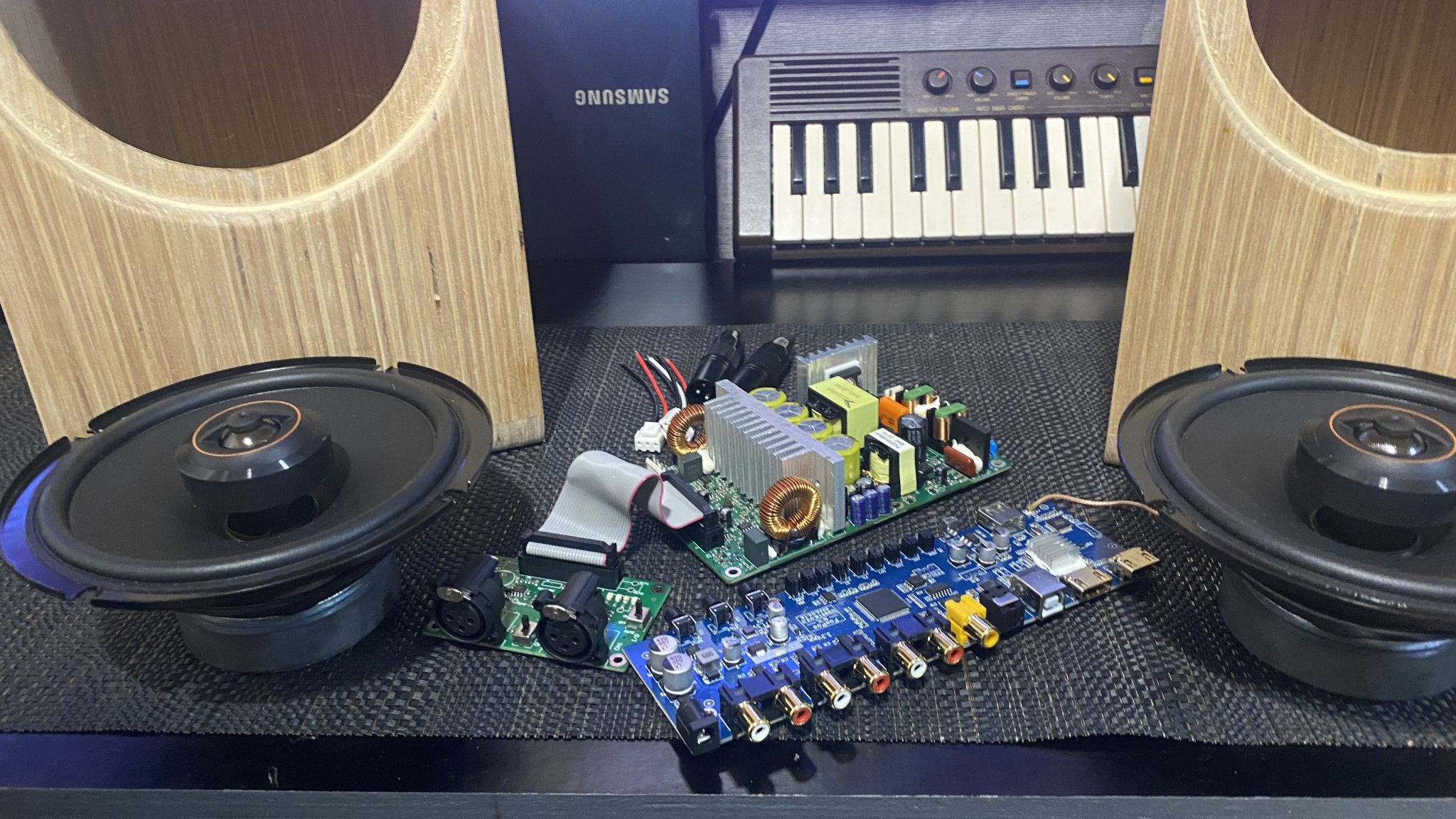

I think I have most of the parts now to make a custom stereo poweramp case for the Eric1v3 for my temp use. I am a bit sick of seeing metal cases everywhere and very basic use of wood. As there are plenty of well-made metal options out there, my design has a different look and more of a musical instrument look and feel and has a decorative upper blank control panel plate. This panel can be used for fitting a tube based front end, either like a hi-fi buffer or instrument pre, and enough space for a channel strip. This description here is a picture painted in words and direct MAD output, so I hope it makes sense
I am also torn between the two speaker box visual theme, whether to sculpture my Apsara dancing torso or classical Veena styling. The Veena look takes the required two internal volumes and long ports well, while on the Apsara torso look, the truncated arms can disguise the long ports. Either will result in a total 22L internal volume and 18L for the woofer and 4L for the coaxial sub volumes. I am thinking the artise on the Apsara would form the most different looking speaker cloth/grill ever 🙂

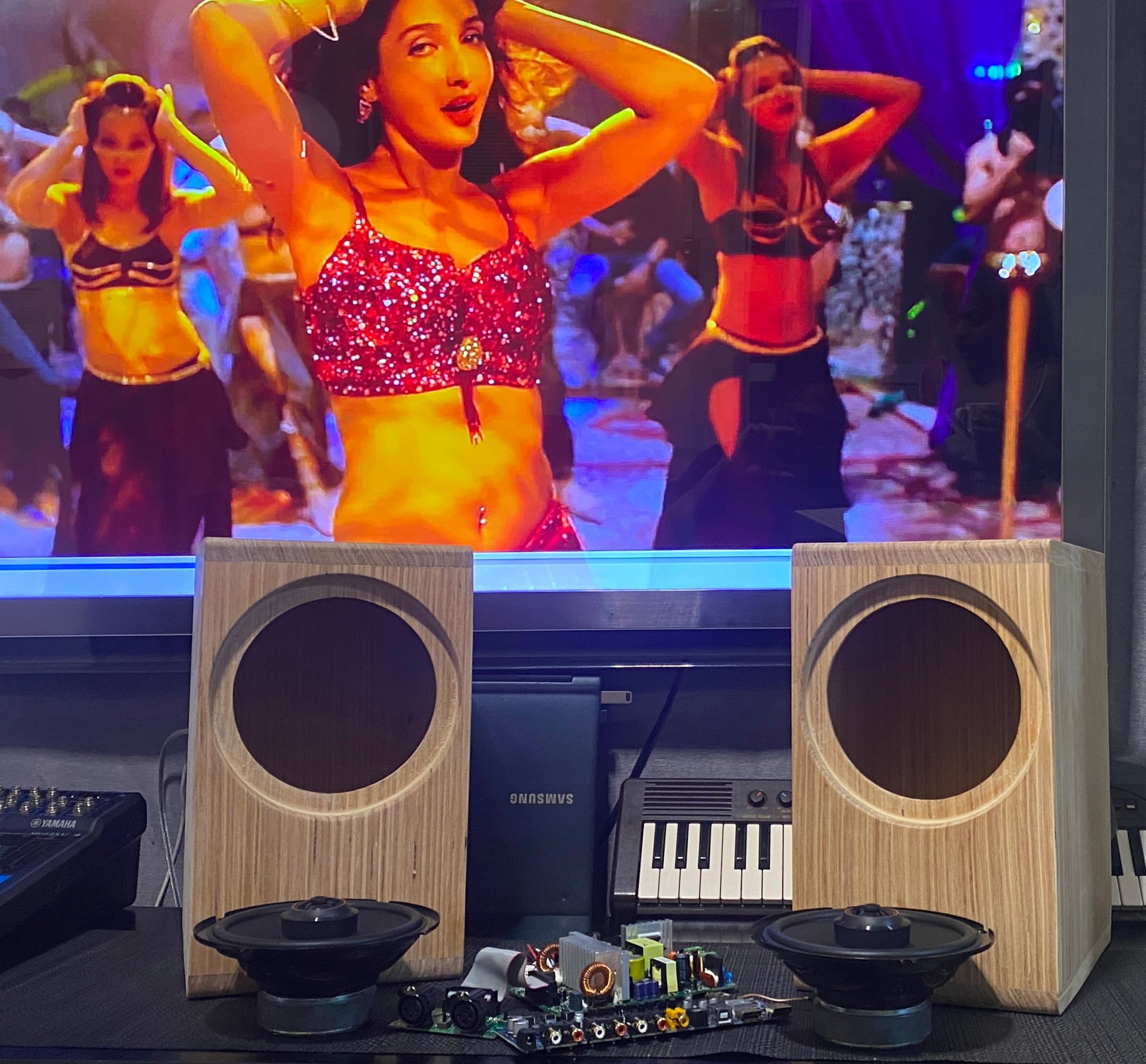

Hi, RandyFirst task, finish the speaker boxes and hook up the Eric1v3 to test the front stereo stage running of the HT decoder board. This has comprehensive AC3 and DTS 5.1 processing and proper remote control and features an OSD via the HDMI pass through

The Uffornica HS chassis will take time, and the Eric1v3 amp board needs an enclosure now. So I am going to design a dedicated stereo poweramp chassis for it. I welcome all Eric1v3 users to collaborate and come up with a standard model that can work for all of us. I'll make my design files available in this thread

A couple of questions for you regarding your amp
1 - How comfortable are you with the board fitted upside down on an aluminium baseplate?
2 - If fitted inverted, are the two aluminium sinks ok to make contact with a common baseplate?
3 - How does the Eric1v3 handle disconnected speakers? Bad for the amp? Is there a way to protect the amp if speakers aren't connected at power on?

Apologize for coming back late, suddenly rush into a busy project.
1. I think it can be mounted with the PCB on the top (as you mentioned in the upside-down version). But be sure of the safety concerns. The TO247 MOSFET heatsink comes from the primary side, which means you cannot put these two heatsink together unless you use the thermal pad for this primary heatsink, and keep its thickness height at least 3mm. During my test, I think the amplifier MOSFET heatsink will get much higher than the PSU heatsink.( I think this will answer your second question)
3. I think there is no worry about the disconnected speaker, the amp can function ok with no load. Btw, it can survive with an output short scenario.

Yes, safety is first.Thanks for that! I'll be sure to isolate everything effectively in my build.
Specially, we have the PSU integrated for this module. Be careful about it, if you're not sure, please drop a message.
Yes, I agree here. With the cooling fan inside, there will be no worries about the thermal issue 🙂No worries. I ordered the full vented top and bottom plates for the Galaxy 2U 330x230 chassis. Plenty of holes for airflow. Note that there is just enough room for this setup. If one wanted to add more things in the chassis, I would recommend going up a size to the 280 mm deep option for more wiggle room. I had considered a shoebox-like arrangement in a narrow 3U with the modules stacked or on their sides, but I prefer this layout. More than three modules would require 3U or a much wider 2U chassis.

Thanks for confirming, man. Don't fret about taking time to respond. You are a busy man and actually in my opinion going out of your way already. I can see you stand behind and love your product. I can appreciate that
I will mount it in the conventional manner, no upside down trickery 🙂

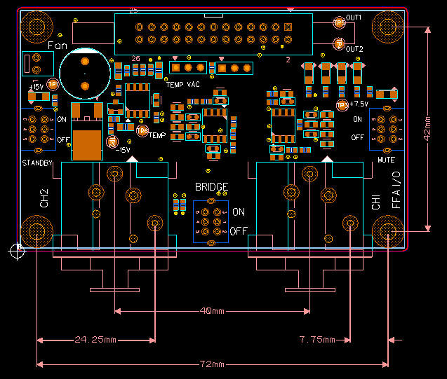

Another question, is there any technical drawing of the Eric1v3 and the buffer board? Something that I can use to cut mounting holes? I want to paste that to my print and cut files
Please let me know if below picture meet your requirement or not.

And, I'll re-check with my PCB engineer, to see if he has the dxf or dwg file for you. Is that what you need?

Thanks for your input, VonI could use that dxf file, thanks.
We'll upload the dxf file here later.
Thanks,Eric
Eric, that gives me the centres of the holes for mounting the PCB and the distance apart for the XLR. I would like to know the height above PCB lower edge for the XLR centres please. Too wobbly to measureHi, Randy
