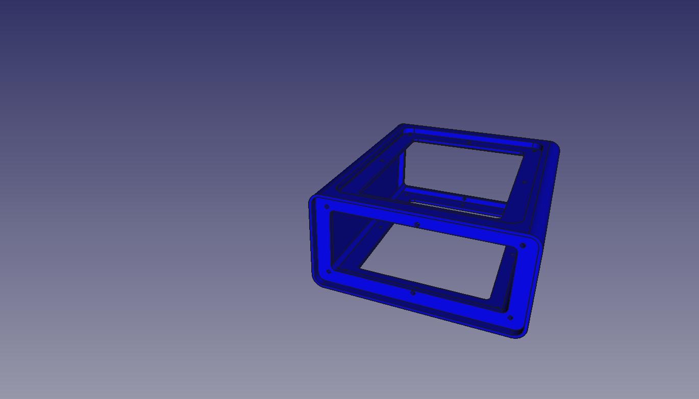

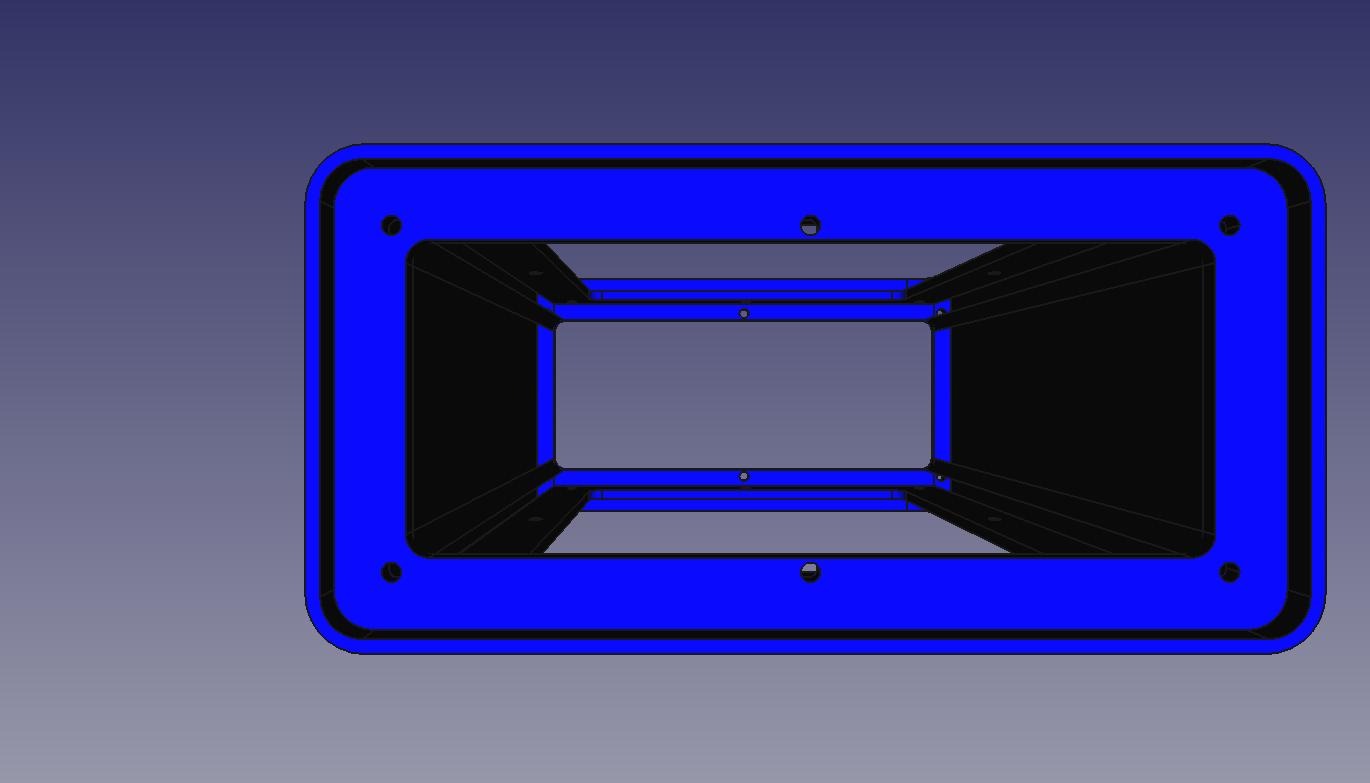

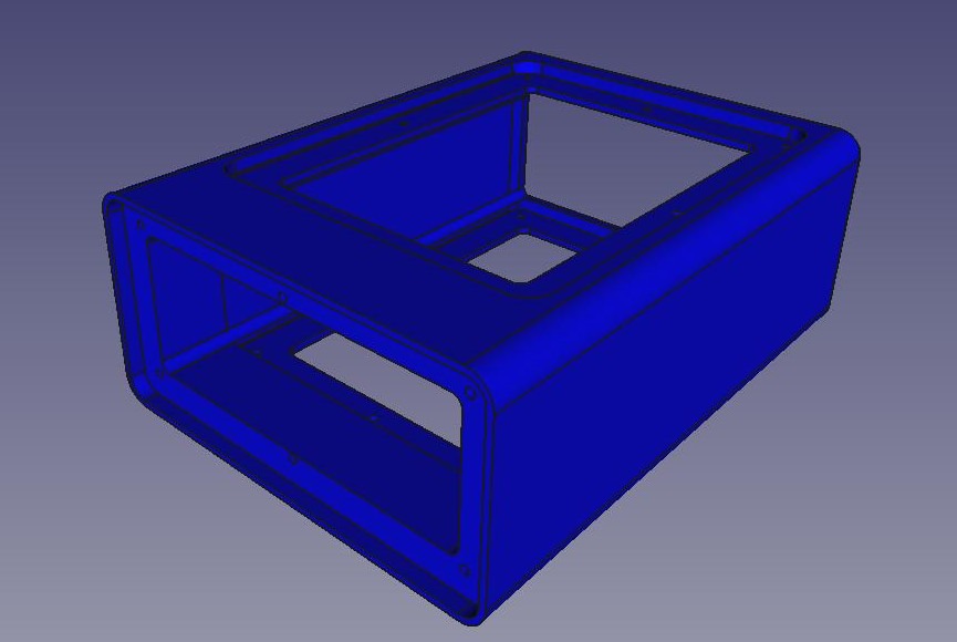

The chassis model for the Eric1 HS is ready
The chassis is symmetrical top to bottom, side to side and front to back. All components, terminals and boards attach to the inlay panels. The chassis is finished by wrapping in a choice of material. My versions will be wrapped in blue, red or black fabric and stitched
All the inlay panels attach via internal M4 screws into threaded holes from the inside except for the base inlay which is screwed from the outside and as it is under the chassis it leads to a fastener free looks
All the inlays have an overall thickness of 6mm to allow for some intricate lamination and light effects
For this chassis, I have gone directly from MAD to CAD without drawing a GA as even my kid can make out what goes where
I am thinking about making this 25mm longer and offsetting the top inlay back by that much. This is to create a pocket behind the face inlay for other electronics like a pre
Like so
This is the extended version. Everything else remains the same. The two part labels are:
Chassis Eric1
Chassis Eric1ext

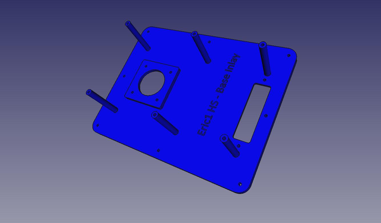

Next task, design and make the base inlay. Secure the Eric1v3 amp board and the power cable and finally able to do some testing

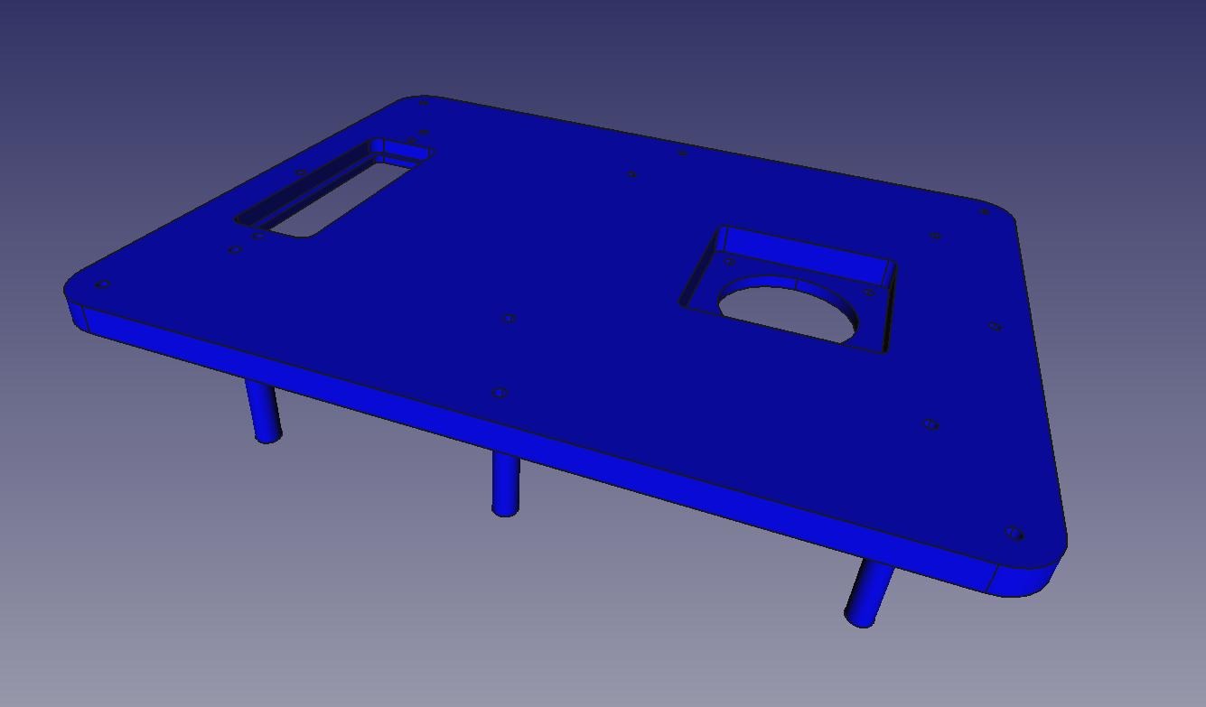

Baseplate will have a 40x40x7mm fan
This one is attractive for price, size and quietness rating
https://www.aliexpress.com/item/324...210318be16674569587008984e5985!66461976311!sh
Rated voltage: DC 12 v
Current rating: 0.1 A
Power consumption: 1.2 W
Noise: 15 dBA
Revolution: 5200 + 10% RPM

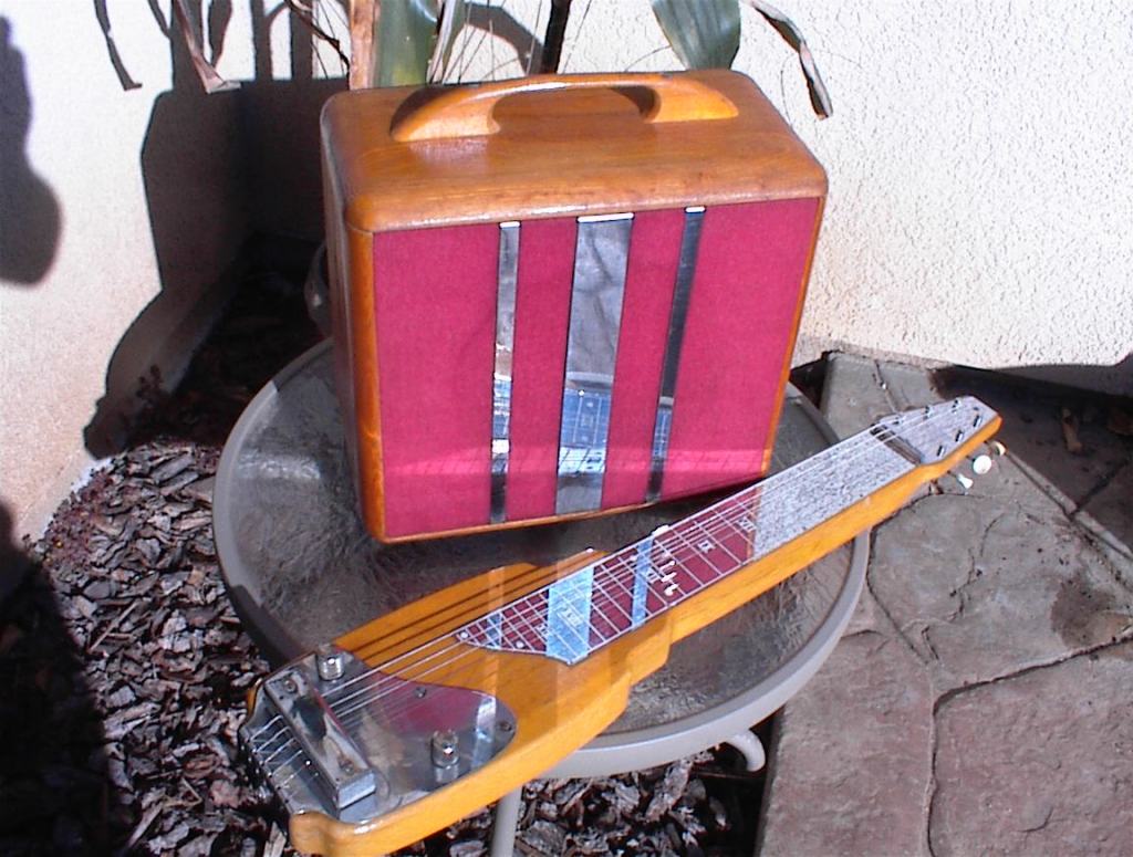

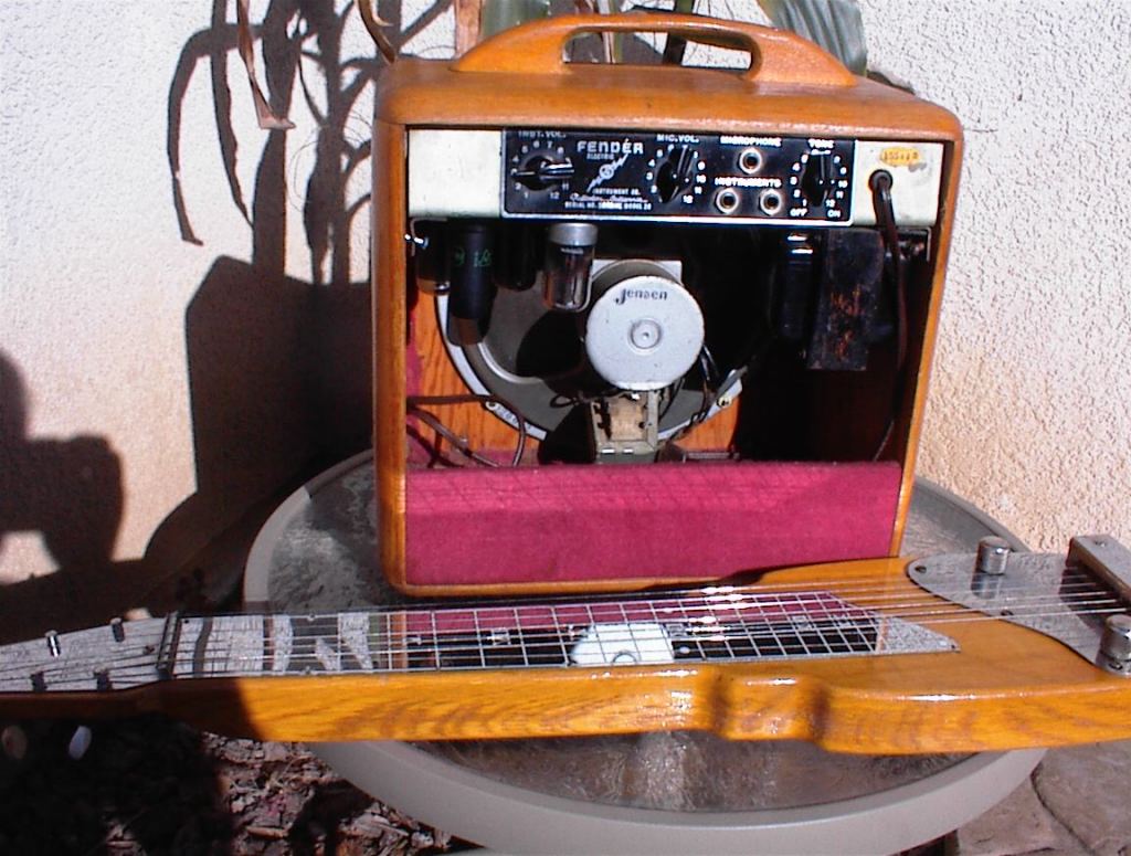

I recently bought an aqua MI amplifier ( https://www.amazon.com/Coolmusic-Acoustic-Amplifier-Portable-Bluetooth/dp/B09DYKHNML ). It was substantially cheaper than the otherwise-identical black version, probably because most musicians in this part of the world are too conservative to buy a blue amplifier, so the marketers dropped the price of the blue version in North America.
I recently stumbled across a Web article about Leo Fender's earliest Fender-branded guitar amplifiers, dating from 1946.So many are trying to make their guitar amp or Bluetooth speaker look like a Marshal.
You might like the look: they are made of beautifully contoured and finished solid wood, with colourful grille-cloth: https://www.fender.com/articles/gear/the-woodies-a-history-of-fenders-first-amps
Good luck with your project!
-Gnobuddy

Base inlay design done. The inlay replaces the need for a baseplate. The Eric1v3 board mounts inverted, fins down. The fan pocket can be seen and draws air in from the outside. Exhaust slot can also be seen. Both ventilation slots will feature filtration screens
The board mounts on the standoffs and clears the base by a mil. PCB standoffs can be mounted over and a screening plate fitted
Now that the design is ready, I am ready to make the first part 🙂

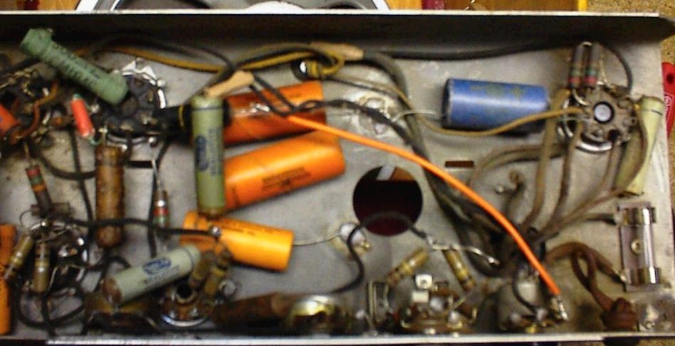

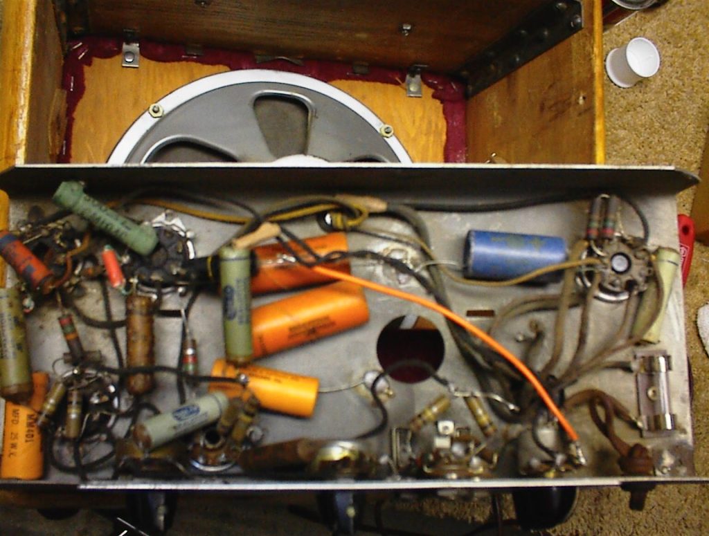

I think it's fascinating how the appearance of a technology changes as it matures.Ugly inside.
Early electronics looked like wooden furniture on the outside (and a rat's nest inside).
Early automobiles looked like horse-drawn carts and carriages.
Interestingly, the turret-board layouts so beloved by DIY and boutique tube amplifier builders are technically one of the worst ways to build a circuit. Placing dozens of components side by side in a long row, and then running many inches of wire to large numbers of them, creates a vast mess of stray capacitances and accidental signal couplings.
It's a wonder any of these builds are usable as amplifiers at all. One would expect them all to be oscillating at radio frequencies.
Leo's ugly-inside 1946 amps would have been a nightmare to repair, but probably less prone to parasitic capacitances and unwanted oscillation than his later turret-board based builds.
Switching to much later Fender PCB designs didn't help that much, probably because of the amount of cost-cutting in the designs (no grid stopper resistors, etc). I've owned three Fender tube amplifiers (Super Champ XD, Blues Junior, '65 Princeton Reverb reissue), and all three left the factory on the hairy edge of full-on RF oscillation.
The Blues Junior was the worst of the lot. It would burst into oscillation after an output tube swap, until you moved the ribbon cables running to the EL84 sockets to their happy place with chopsticks. It would burst into oscillation if you clipped the ground wire of a DMM to the chassis. It would burst into oscillation if you put an external guitar FX pedal on the floor within a metre of it.
-Gnobuddy

I'm going to be quite direct with my answer, because I think it's important to look at this seriously.electronics like that...a laid out schematic...No PCB and tracks made from stiff single core tinned wire
<snip>
What would be the problems of doing a simple tone or pre circuit in this manner?
Let's ask ourselves the following questions:
1) What happens if you pick up the completed circuit, hold between finger and thumb, and shake vigorously five times? Will it still work after that?
2) What happens to the circuit if you pack the completed circuit into a suitcase, with clothes and books and razors and hair-brushes all jammed around it, check the suitcase in at the airport, and then pull it out at your destination, three flights and four airports later? Do you think it will still work?
3) How many times can you operate the push-buttons before the soldered joints and switch lugs develop metal fatigue and crack?
4) What happens if those free-hanging copper wires intermittently touch each other when you adjust the volume, while your preamp is feeding a signal to a 50W power amplifier? How long before the explosively loud bangs and thumps destroy your loudspeakers and damage your hearing?
I think you can see where all this is leading.
A circuit built like that is a bit of crude unskilled folk art, suitable for framing or hanging on the wall, if it happens to suit your tastes.
It is not a useful or usable electronic device.
Our world has been dumbed-down a lot in recent decades. We are over-exposed to pretty or exciting visual things, and under-exposed to intellectual concepts that are not visually pretty or exciting. But those not-pretty things are actually far more important to the continuation of civilization as we know it.
Many of us have completely forgotten this now. We have been conditioned and dumbed-down to think pretty is always better.
Electronics is a type of engineering. Engineering that doesn't actually work, which can't stand up to its normal intended use, is a failure. A joke. An embarrassment.
Making things pretty doesn't make them better if it makes them useless for their intended purpose. It makes them worse.
An ugly bridge that doesn't collapse is a better bridge than a pretty one that falls into the river on the first windy day.
Ugly steel control arms smeared with black grease hold your front wheels on better than polished wooden control arms would. The pretty wooden arms would break the first time your tyre hits a pothole, and you would have an accident. The ugly steel control arms get you home safe and sound.
Electronic devices made with components firmly mounted to a PCB, housing, or turret-board, and no physical strains applied to solder joints, are much better than devices made with unsupported parts dangling in thin air, with weak copper wires, and even weaker solder joints, running between them.
If you enjoy creating folk visual art using electronic components, sure, make 3D pictures with carefully bent copper wire. Hang them on the wall when you're done. They're visual art, not usable electronic devices. Nothing wrong with that, if visual art is what you're after.
On the other hand, if you want to actually create a working electronics device, use the various construction techniques that have been developed over the last century, in order to create reliable and usable products.
One absolutely fundamental key factor is to make sure that all components are strongly and securely supported, most particularly components that will also be handled by the user (switches, knobs, etc).
A second key factor is to enclose the delicate parts, to protect them both from mechanical intrusion, and from ingress of dirt, dust, moisture, et cetera.
It's certainly possible to create an electronic device that's both functional, and good-looking. But you won't get that result with fragile exposed solder joints and fragile copper wire making a rats nest of unsupported components in mid-air.
-Gnobuddy
