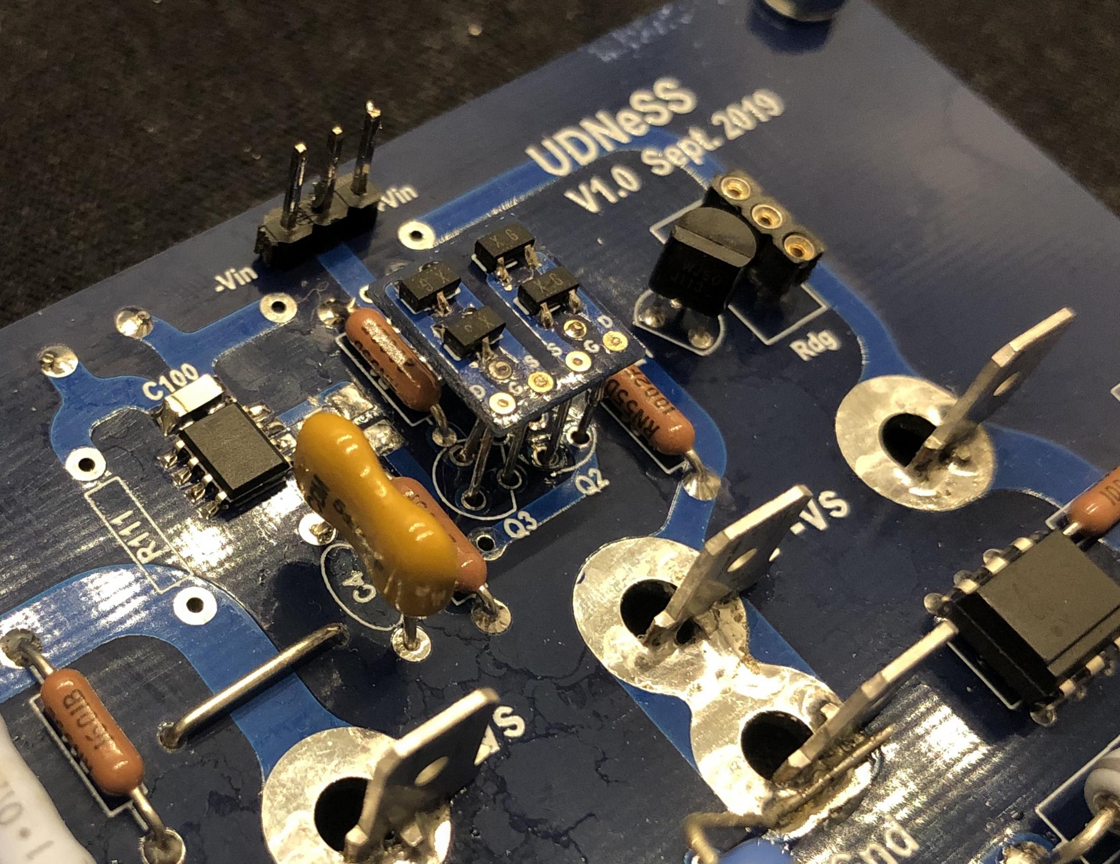

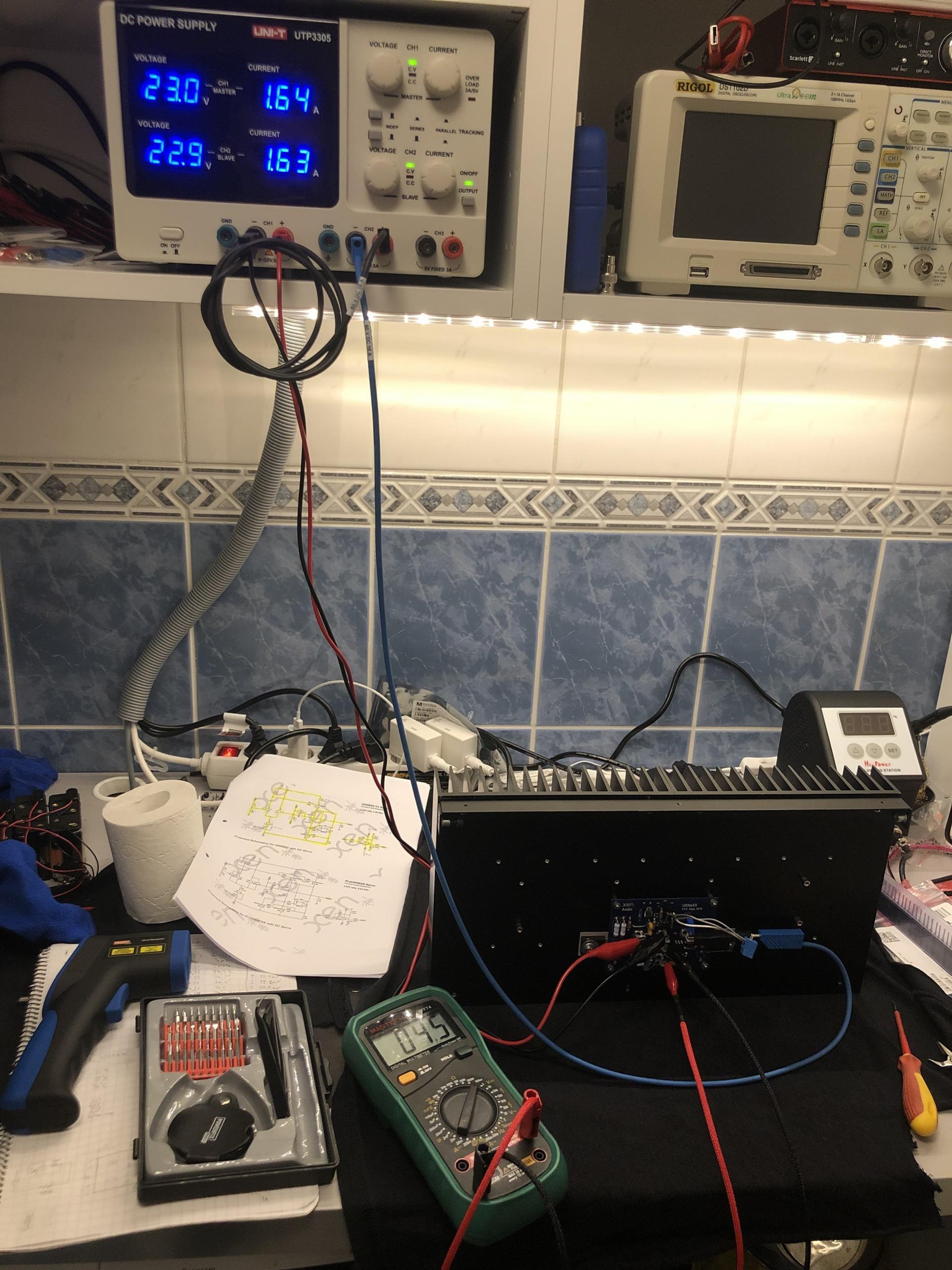

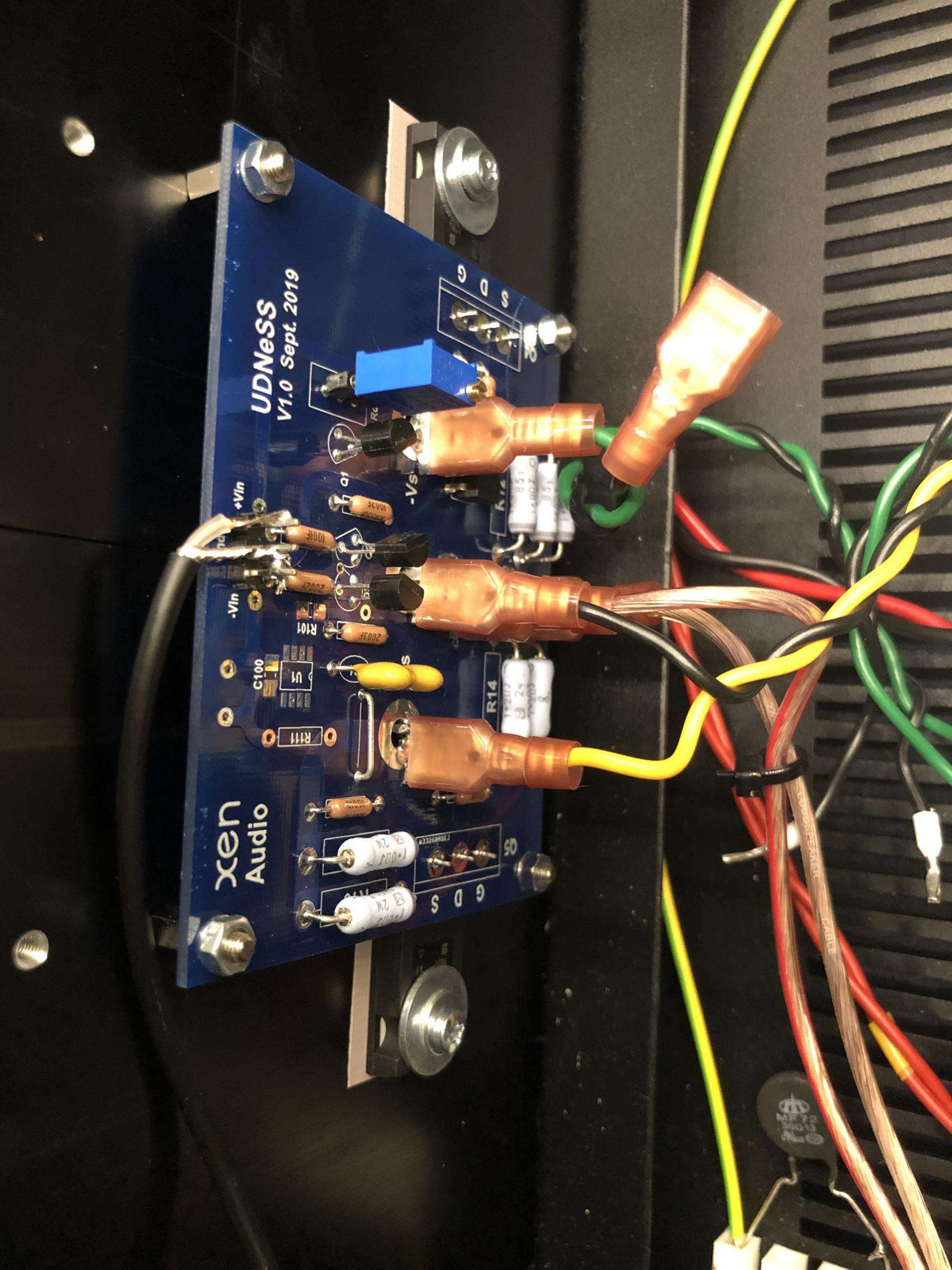

The alpha tester reporting here...:wave:
I must say that this was highly educational and fun project for me and it was an honor to help Patrick with this design. This was just my second power amplifier build after all of the headamp projects but still I managed to pull it off with Patrick's vast knowledge and fast response to whatever problems and questions.
Now that the final tweaks and development has been done I'm sure that this could be carried by maybe even for beginners with some basic electric skills.
The listening test is still pending on my side because I ordered only 2 pcs of the FQAs for testing and now I need to have some more and do matching between channels. Unfortunately my speakers are of 4 ohm impedance, but we'll see how the UDNeSS performs with them.
I attached a couple of pics from the testing phase. I used the chassis from my M2x build that has the diyAudio UMS drilling pattern and I was able to fit the MOSFETs in existing tapped holes but the standoffs require new tappings. Let's hope we see many more builds in the future. 🙂

A few comments on the Alpha build :
1) Make sure the wiring from CRC to amp PCB is as short as possible.
2) During tests the servo was disabled. We suggest you only add the servo if needed.
__ In any case adjust the DC offset without the servo.
3) The ideal placement of the 2SK209 adaptor is vertical.
__ This allows shortest wiring to the amp PCB, as well as access to other components.
You can use my J2K3497 layout for reference :

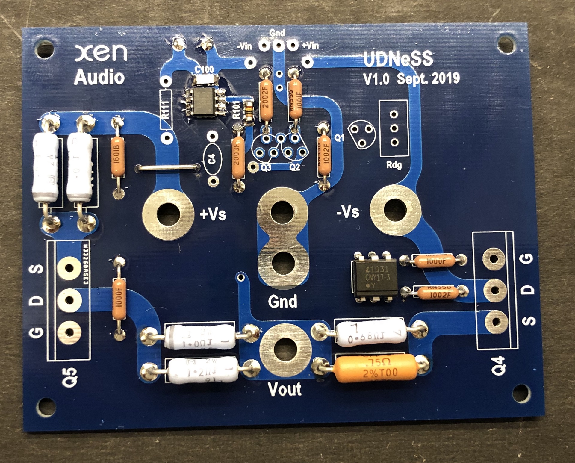

I have to admit that I do not understand why people has to ask me (or anyone else for that matter) for PCBs.
You have the Gerber files (already published).
You can order them at the likes of SEEEDStudio for less money than the postage.
So what is the problem of ordering yourself ?
Patrick
Morde has done some more measurements on DC drift.
Of course it depends on your heatsink size and also insulation in between.
From power up at 0V DC, the offset went to -22mV in 5 minutes, but dropped back to 16 mV in an hour.
Once reset to zero, it stayed stable within +/-2mV.
So you can leave out the servo without any problems.
In any case, you should only add the servo after setting the DC offset properly on the heatsink to be used.
The servo circuitry will also be tested in the next days, just to be sure.
Again all thanks to Morde.

Just an example: I ordered my PCBs from PCBway.com. You upload the gerber zip file (provided by Patrick) directly into their ordering system and they will evaluate it and once you have approval you can order them. It is made very easy. I hope this helps.
And here is an online tool you can use to see how the pcb looks like after you upload the gerbers.
Online Gerber Viewer
